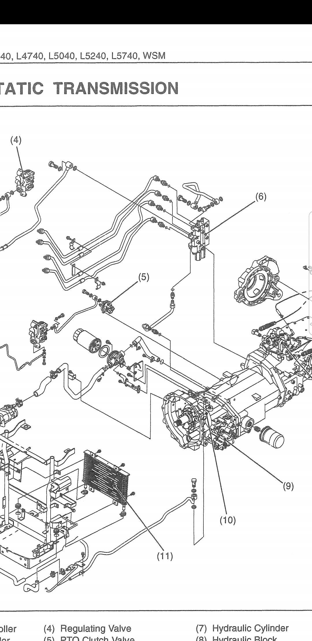

Hey everyone, I need some help. I am trying to run a hydraulically driven motor like a bush hog on my l4740. Now I know I can get the pressure from my rear remotes or third function but the return line needs to go to sump. I do not like the idea of running the hose into the fill port for it will cause frothing in the fluid. The only option i can seem to come up with is to cut and tee into the steel line that comes from the back of the loader valve and goes to the tank. I cant find any open ports. Any thoughts?

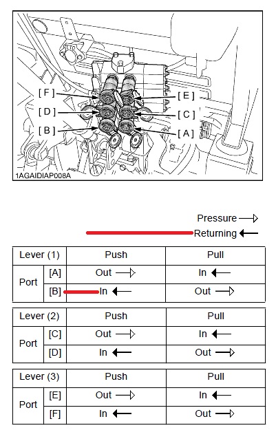

Look closely at your owners' manual. On my slightly larger M series, the rear remotes can deal with supply and return for a hydraulic motor.
I run my Samurai sickle mower this way.
In the attached image from my owners manual, it clearly shows one remote of a pair is pushing and the other returning to the sump.
This is not unlike a loader valve. When a cylinder is extending, the retract side of the cylinder is being routed to the sump by the loader valve.

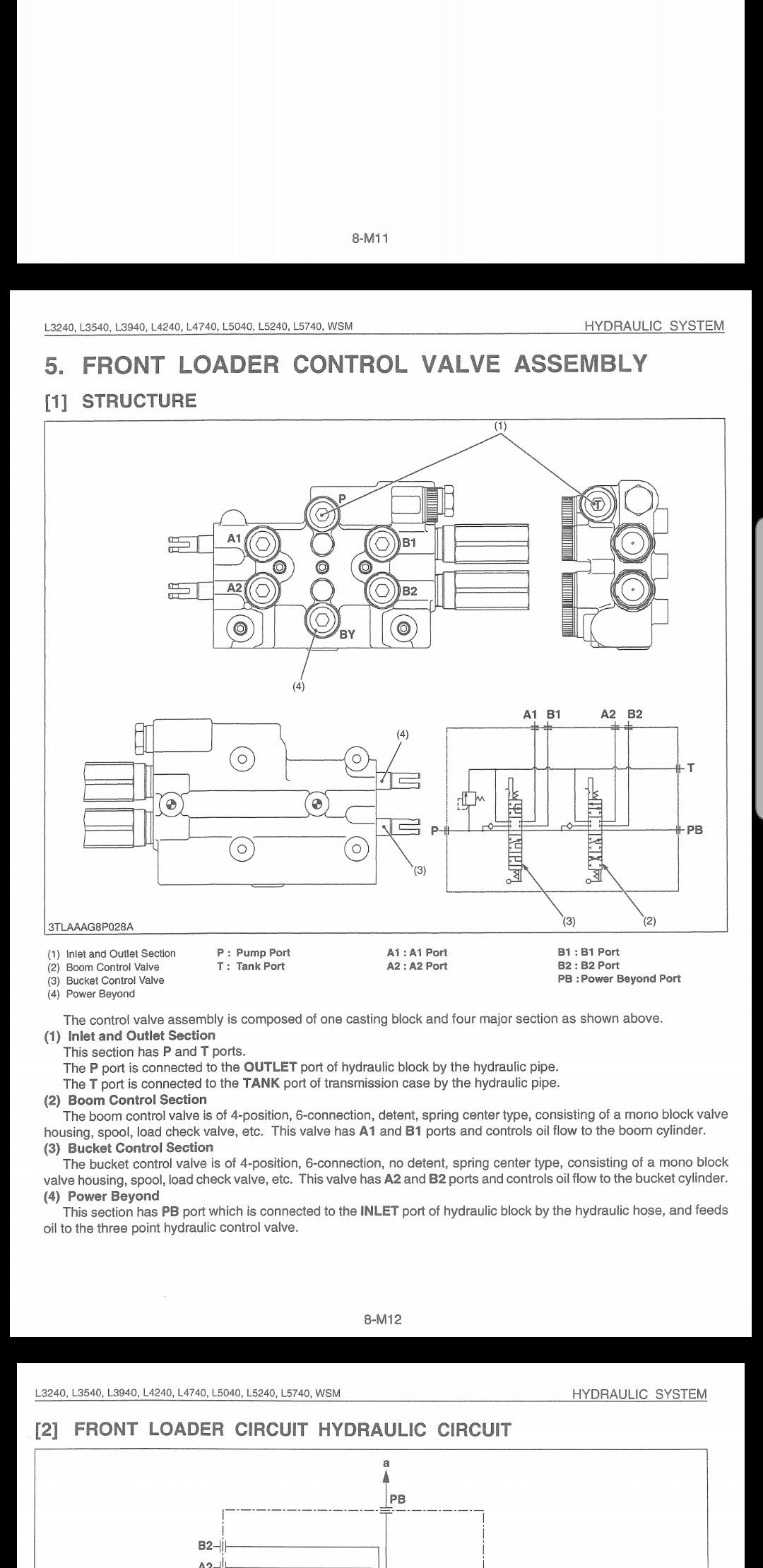

I have attached 2 screenshots of my loader valve from the WSM

You could always connect into the T line on your loader valve.

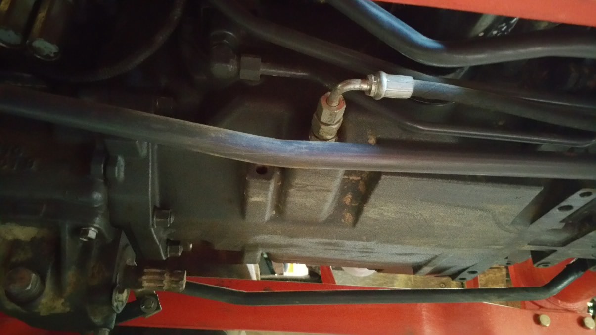

The front mount blower uses a hydraulic motor to rotate the chute. It uses 3 lines, two for pressure and a 3rd one that returns the fluid. I can look at my 4240 see how the factory does it.
   / Kubota L4740 return to sump #18
The bad news is it looks like you will loose a lot of hydraulic fluid as the hole is at the bottom of the transmission. It's just a 1/4" hydraulic hose.

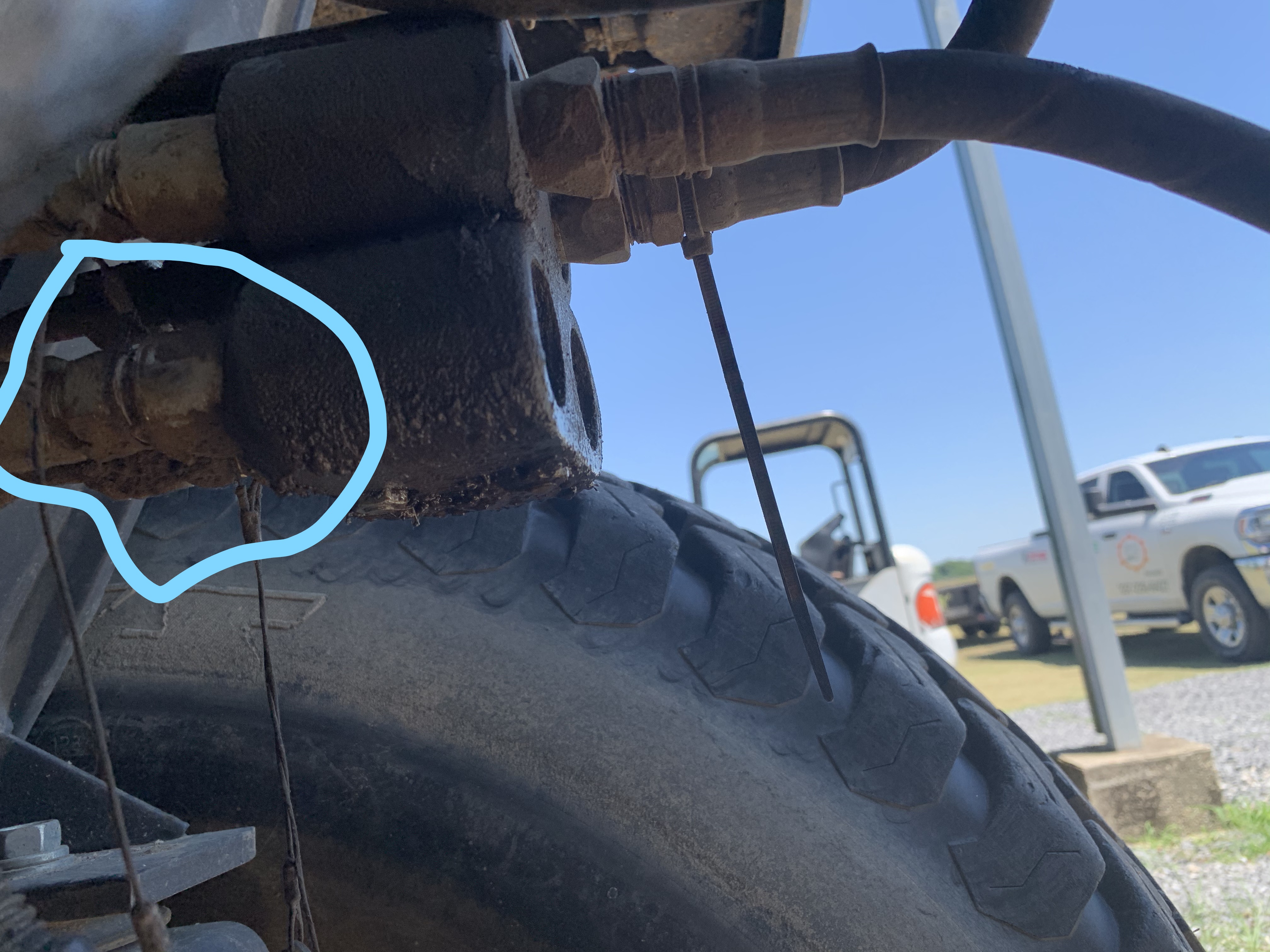

I would not say it was continuous flow, but I would consider it intermittent flow. As I am driving along, the blade automatically tries to stay at the same level, therefore it will automatically raise and lower many times during the process. I believe this would potentially cause more heat than continuous flow would cause.
Yes, I am still using it the same way as I posted 6 years ago, and have not had any issues since then. I would guess that I have 200-300 hours using it this way.

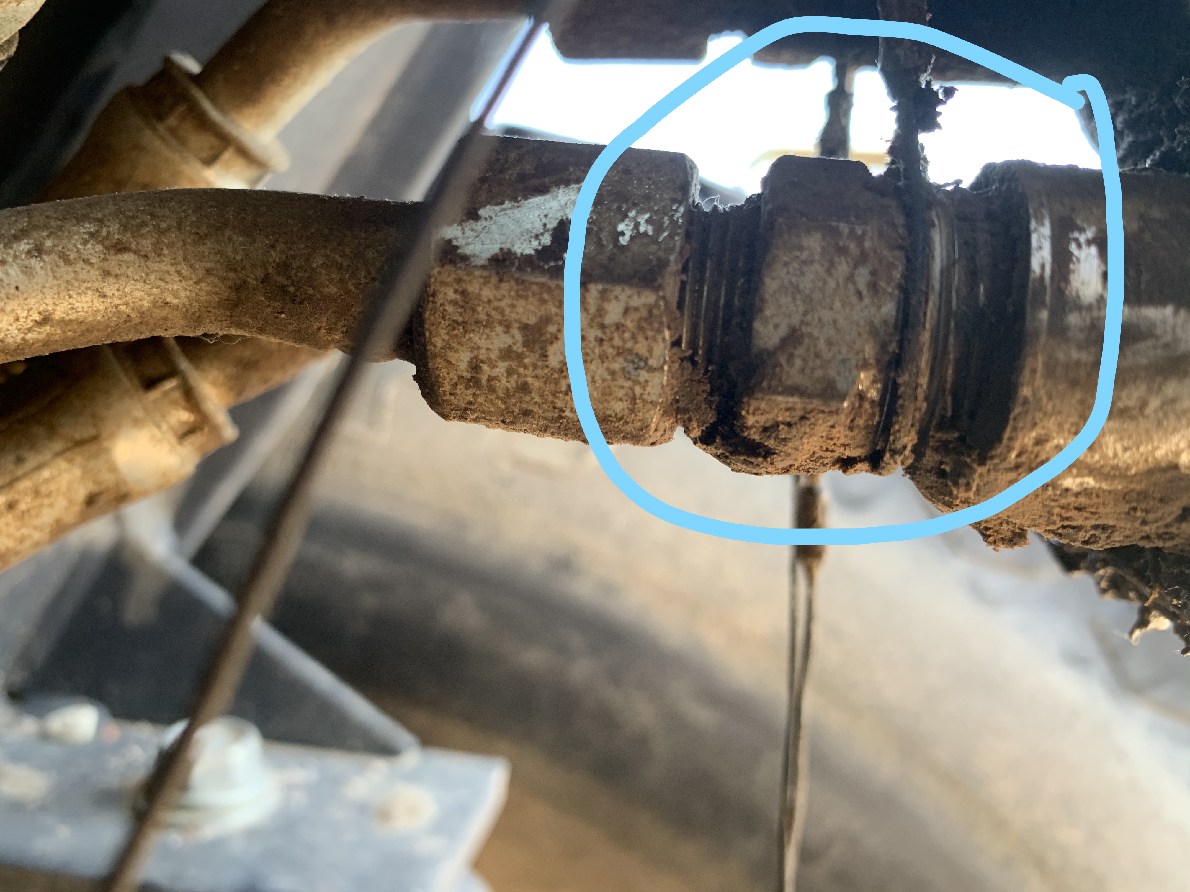

I have had some other issues with that tractor and I am considering using my L6060 for laser grading in the future. If I do use the L6060, I will attempt to just bypass the quick coupling fitting on the 'return' line. In other words, I will not dump the 'return' oil into the fill port, but will remove the quick coupling and connect the 'return' hose behind it.
I have purchased the fitting I will need for this, but I have not tried it yet.
Below are where I plan to install this fitting when I do try to use it on my L6060
