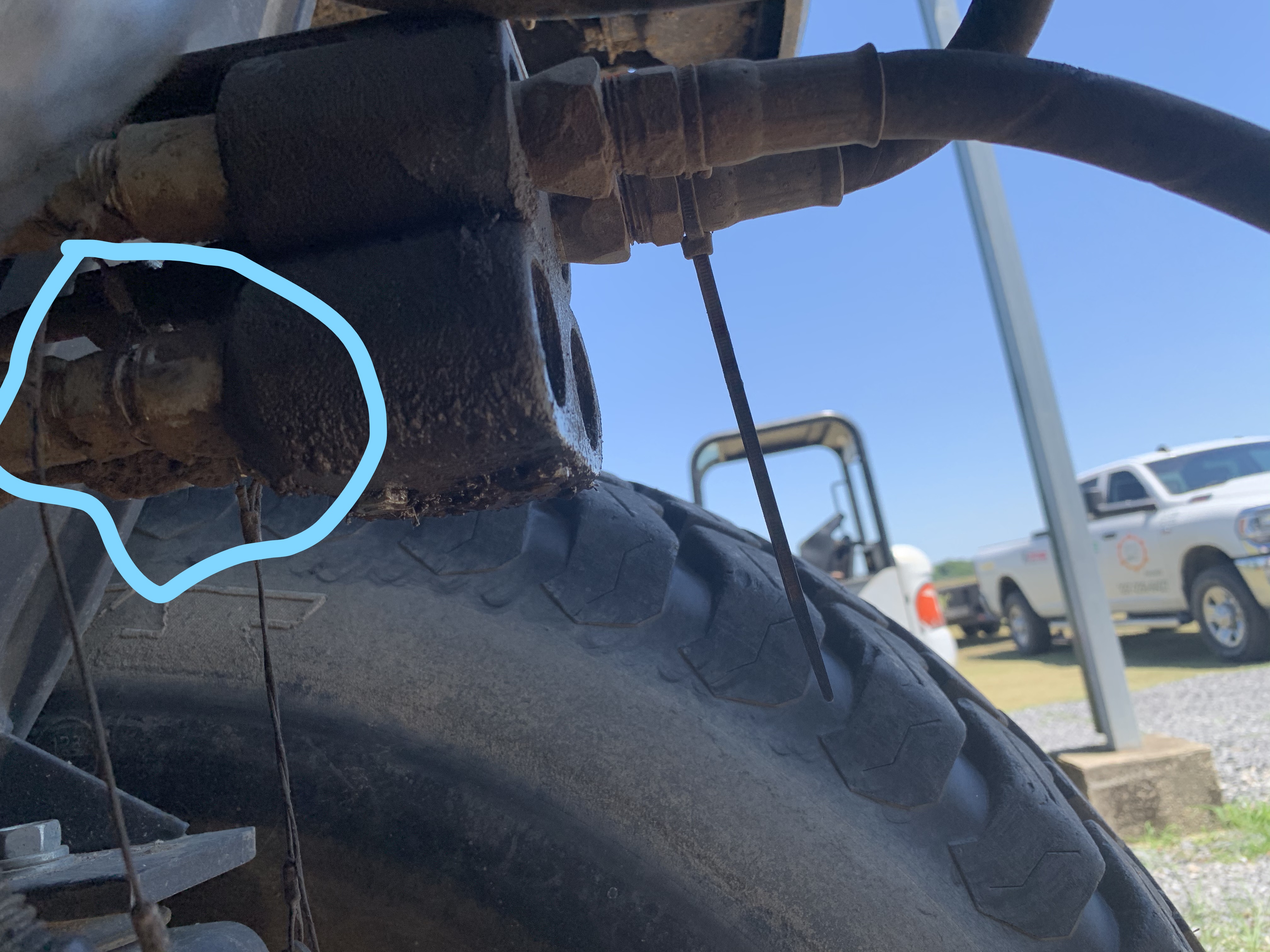

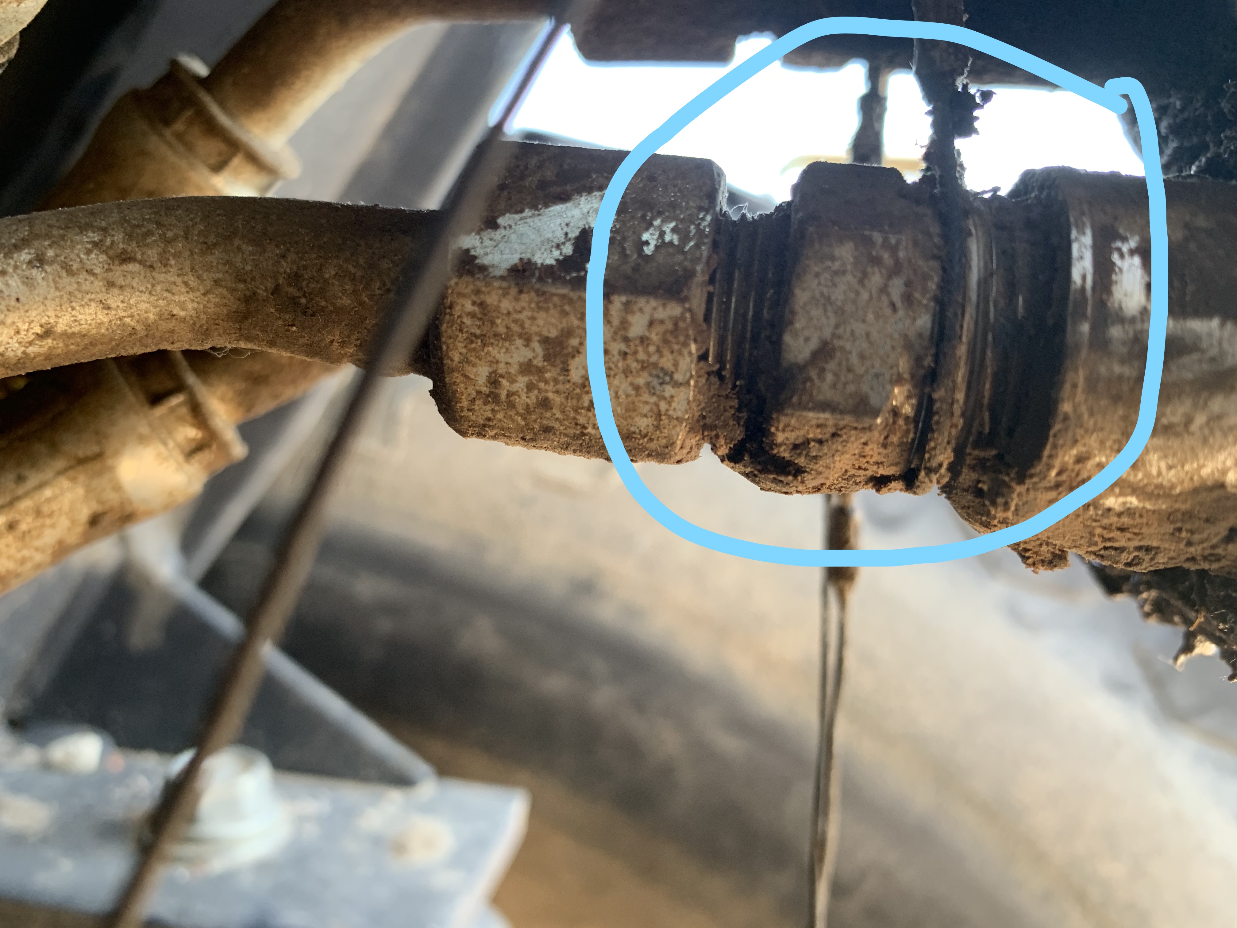

Have yall heard of the Laneshark. That is the fel bushhog l am referring to. I know they run them on tractors all the time and even much smaller tractors ( with a smaller hydraulic motor). They do not seem to have much experience with the grand L's. And not very responsive due to the COVID and everyone working from home. I also get no help from any dealer around. They all tell me it not possible to run a hydraulic motor off of a tractor, that is why most implements are pto driven.
The best place I can find to tie in is on the hard pipe from the loader valve to the sump.

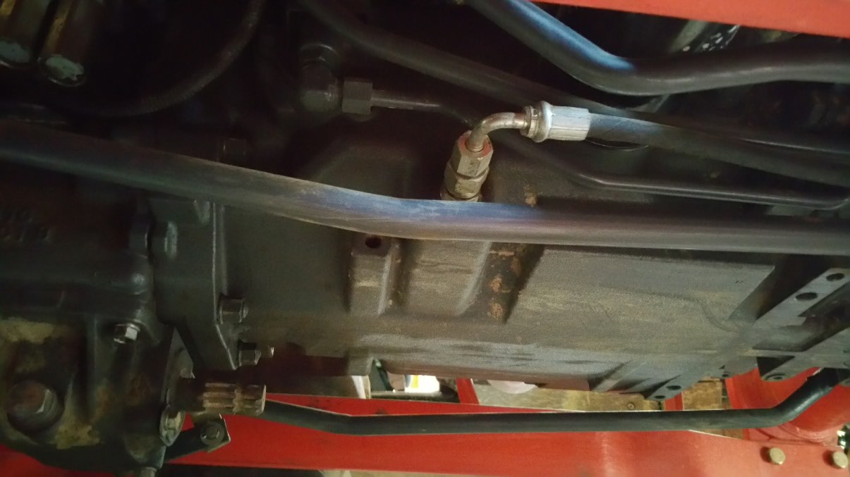

The front mount blower uses a hydraulic motor to rotate the chute. It uses 3 lines, two for pressure and a 3rd one that returns the fluid. I can look at my 4240 see how the factory does it.
   / Kubota L4740 return to sump #18
The bad news is it looks like you will loose a lot of hydraulic fluid as the hole is at the bottom of the transmission. It's just a 1/4" hydraulic hose.

I would not say it was continuous flow, but I would consider it intermittent flow. As I am driving along, the blade automatically tries to stay at the same level, therefore it will automatically raise and lower many times during the process. I believe this would potentially cause more heat than continuous flow would cause.
Yes, I am still using it the same way as I posted 6 years ago, and have not had any issues since then. I would guess that I have 200-300 hours using it this way.
I have had some other issues with that tractor and I am considering using my L6060 for laser grading in the future. If I do use the L6060, I will attempt to just bypass the quick coupling fitting on the 'return' line. In other words, I will not dump the 'return' oil into the fill port, but will remove the quick coupling and connect the 'return' hose behind it.
I have purchased the fitting I will need for this, but I have not tried it yet.
