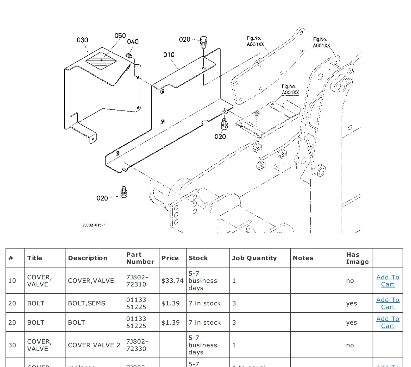

See how easy it is to be fooled? I don't know about the L48 but that FEL loader control valvesure fooled me on the M59.
It sure looked to me like my M59 FEL loader valve would be located in the loader valve tower by my right hand - just exactly as you say and I expected too. It would just make sense to find it there....
After all, that's where it is traditionally, directly under the control valve handle on just about every tractor in the world.
So I was surprised when I finally did find the M59 loader control valve. It's down underneat the floor of the tractor behind two steel covers and operated remotely by cables. I'll start another thread about my efforts to find and lube that M59 loader control valve so we don't get too far off subject here.
rScotty
I looked up the L48 parts diagrams before posting and they appear to show it being right under the stick, not down low like on your M59.

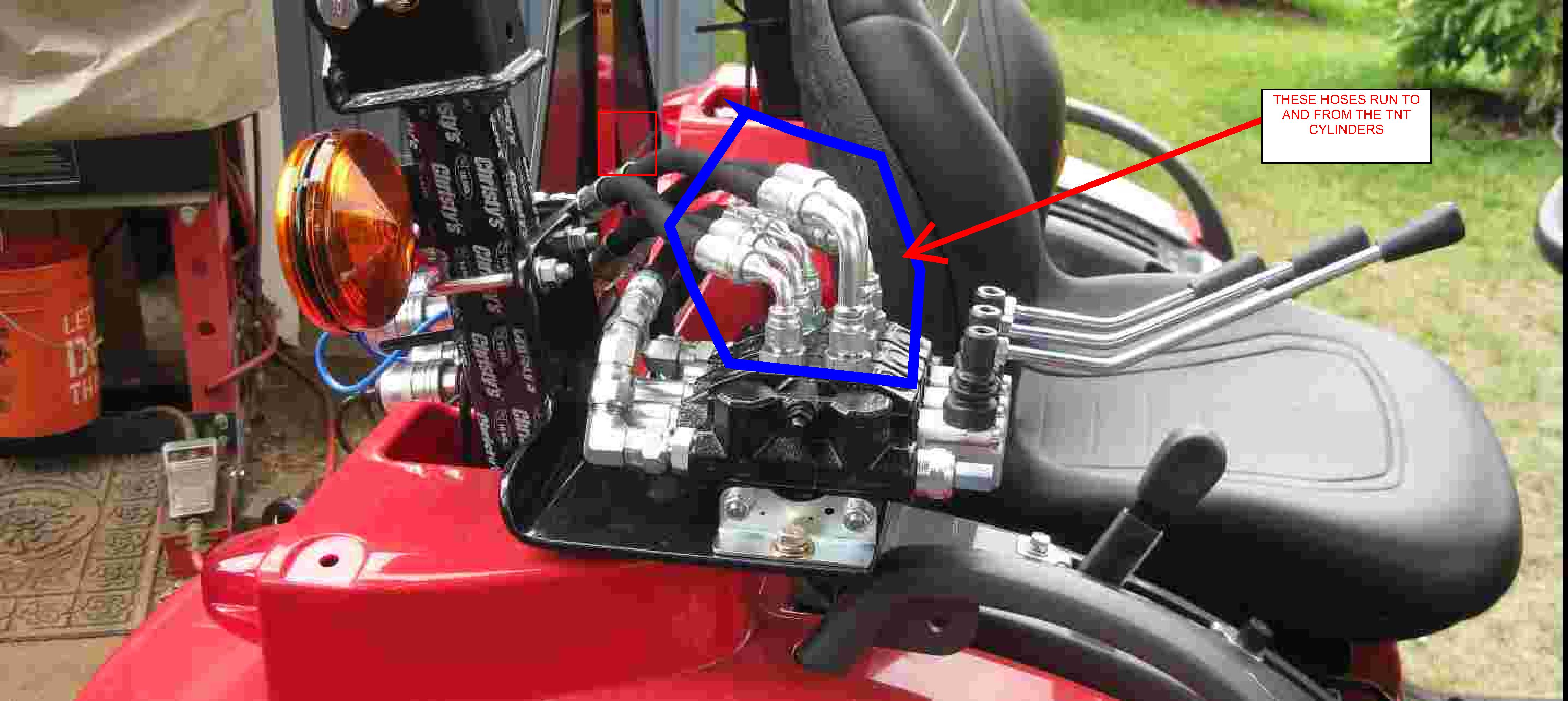

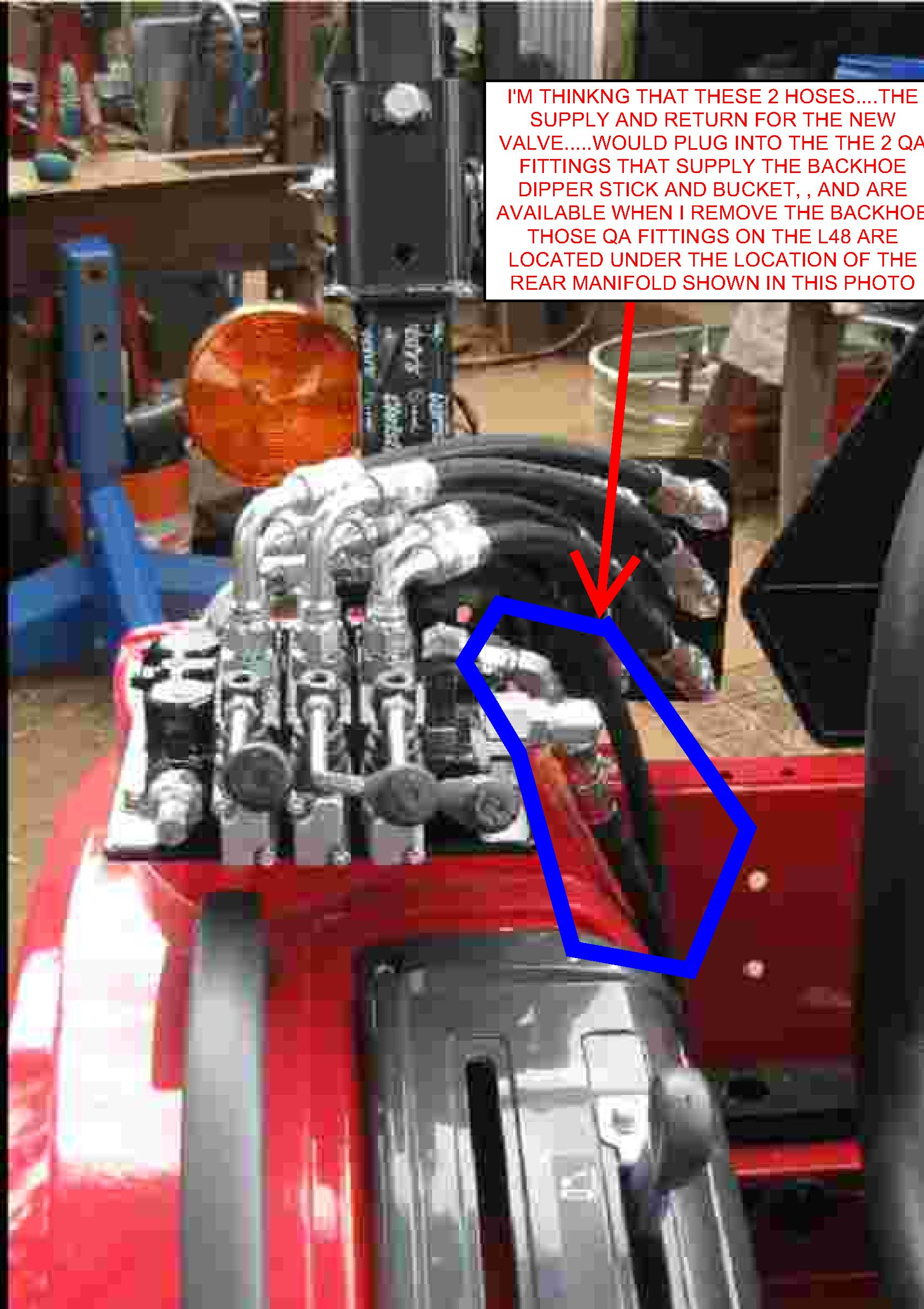

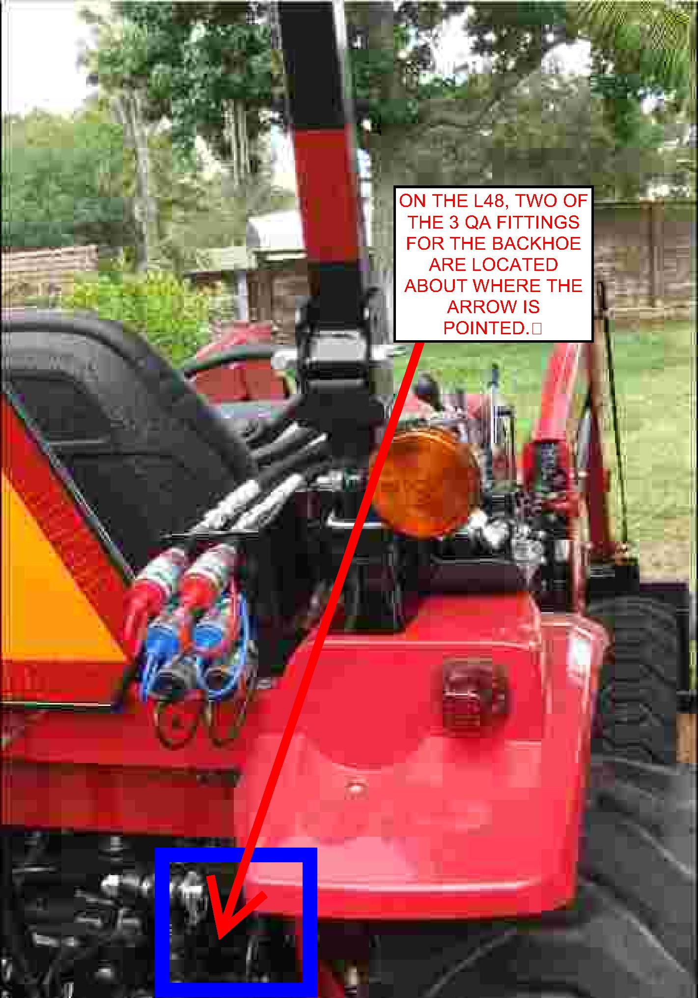

I'm going out now to start looking at it. Now......don't know if this has bearing on the idea of using the front loader valve but I do have a 3rd function hydraulic setup on the loader for a grapple or 4 in 1 bucket. I'm guessing that might be the only front remote and is now not available to use for the TNT......but I'll know shortly. Also, I was looking at post by Brian on Green Tractor Talk and he had pictures of a setup that looked like it would work for my L48 (if the loader valve won't work). Please see the attached pictures.I'm thinking I could mount the control valve on the fender like in these photos. The 4 hoses coming out of the top of the valve would go to a new manifold that would be attached to the ROPS. In the photos, the hoses that supply the valve and return to the tank are coming up from underneath the tractor somewhere. In the case of the L48, I'm suggesting that the supply and return hose would instead, plug into the 2 QA fittings on the rear of the L48 tractor, that supply the backhoe dipper tick and bucket (there is one more QA on the left side that provides for swinging the dipper stick). The backhoe valves are attached to the backhoe assembly and are downstream of those QA fittings. This would be a pretty easy setup to put together. Do you think that would work?
TNT 1.jpgTNT 2.jpgTNT 3.jpg.
View attachment 635732View attachment 635733View attachment 635734.
The problem with that is that I believe the valve which turns on the fluid out the backhoe valve turns on both the fluid for the swing as well as a fluid for the rest of the backhoe valve.
As such, you'll be flowing fluid through one while deadheading the other which is a recipe for a very short life on the pump.
You will need to verify if this is the case, if that is how it works you cannot do it that way.
The other issue would be that if it does work that way, when you have your new valve enabled, your three point hitch will be disabled, that would not be overly convenient from a usability standpoint.
If you're able to tap into one of the two lines before it reaches the selector valve that chooses if the flow goes out to the backhoe or to the 3-point.
I would follow the hoses coming off of your loader valve and see if you can tie in to the power beyond port coming off of your loader valve going back to the selector valve.
