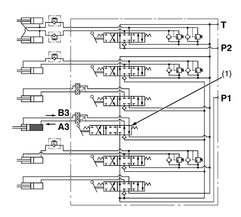

Here is the Hydraulic circuit for the backhoe and RH stabilizer extend.

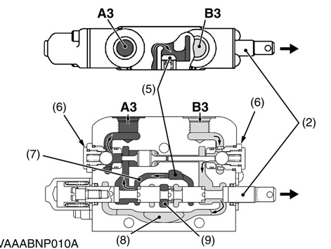

Valve block with side view.

KEY for the pictures in previous post.
(1) Stabilizer RH Control Valve
(2) Spool
(3) Inlet Section
(4) Outlet Section
(5) Load Check Valve
(6) Lockout Valve
(7) Bridge Passage
(8) Low Pressure Passage
(9) Neutral Passage
P1 : P1 Port
P2 : P2 Port
T : T Port
A3 : A3 Port (To Stabilizer RH
Cylinder)
B3 : B3 Port (From Stabilizer RH
Cylinder)

The lockout valve may be sticking. This is a pilot operated check valve that will block both ports of the cylinder if there is no pressure, i.e. main spool centered. It is intended to reduce drift of the cylinder. To check it, put your gauge on the rod side port of the cylinder and extend the cylinder. Pressure should be low as this the return line. Less than 100 psi when the cylinder stops moving. If pressure builds higher than that then the check valve is not opening. Take the lockout valve (item 6) apart and clean it.

What bothers me is there seems to be a check valve in the diagram for the RH
outrigger cyl base A3 (extend), but not the LH cyl. I assume the LH cyl is
just above the RH in the diagram.
The lift problem you have affects both cylinders, so the culprit should be something
that both share. I like STONEHALLER's theory about the lockout valve (check valve),
but I do not see how that can account for both cylinders failing to lift properly.
