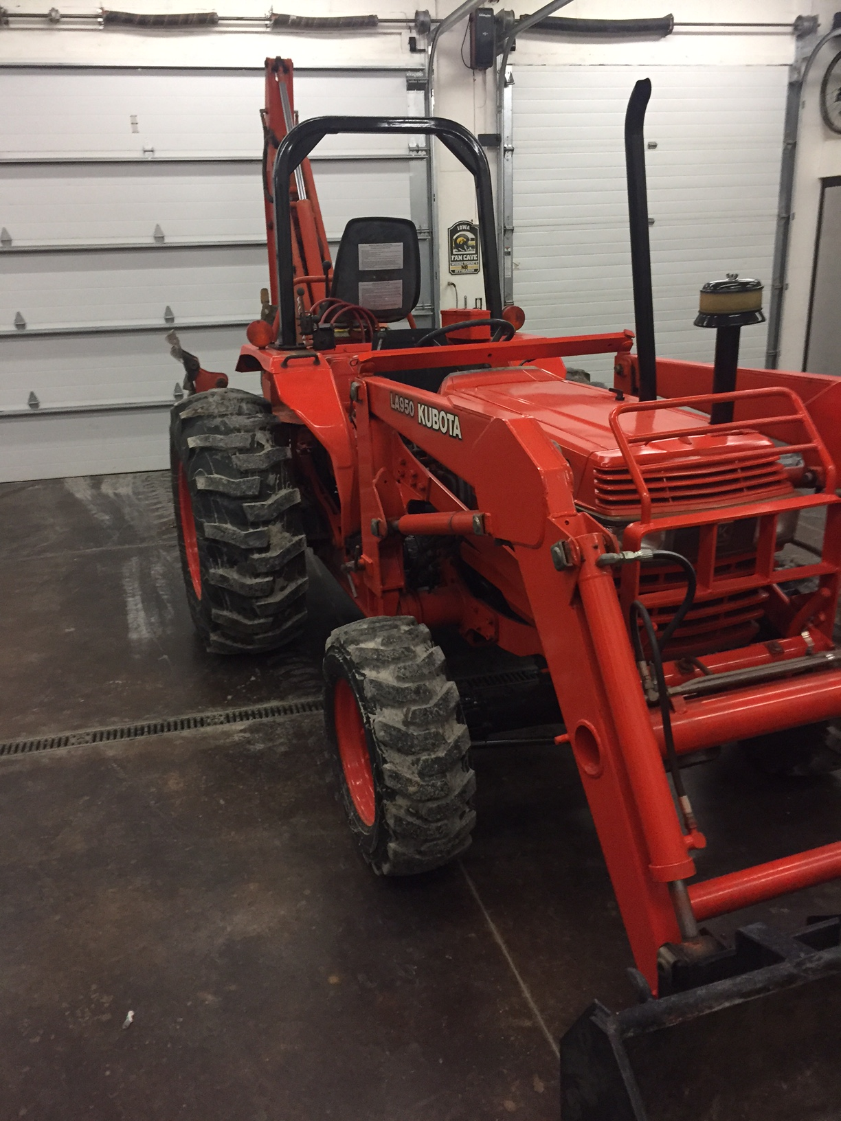

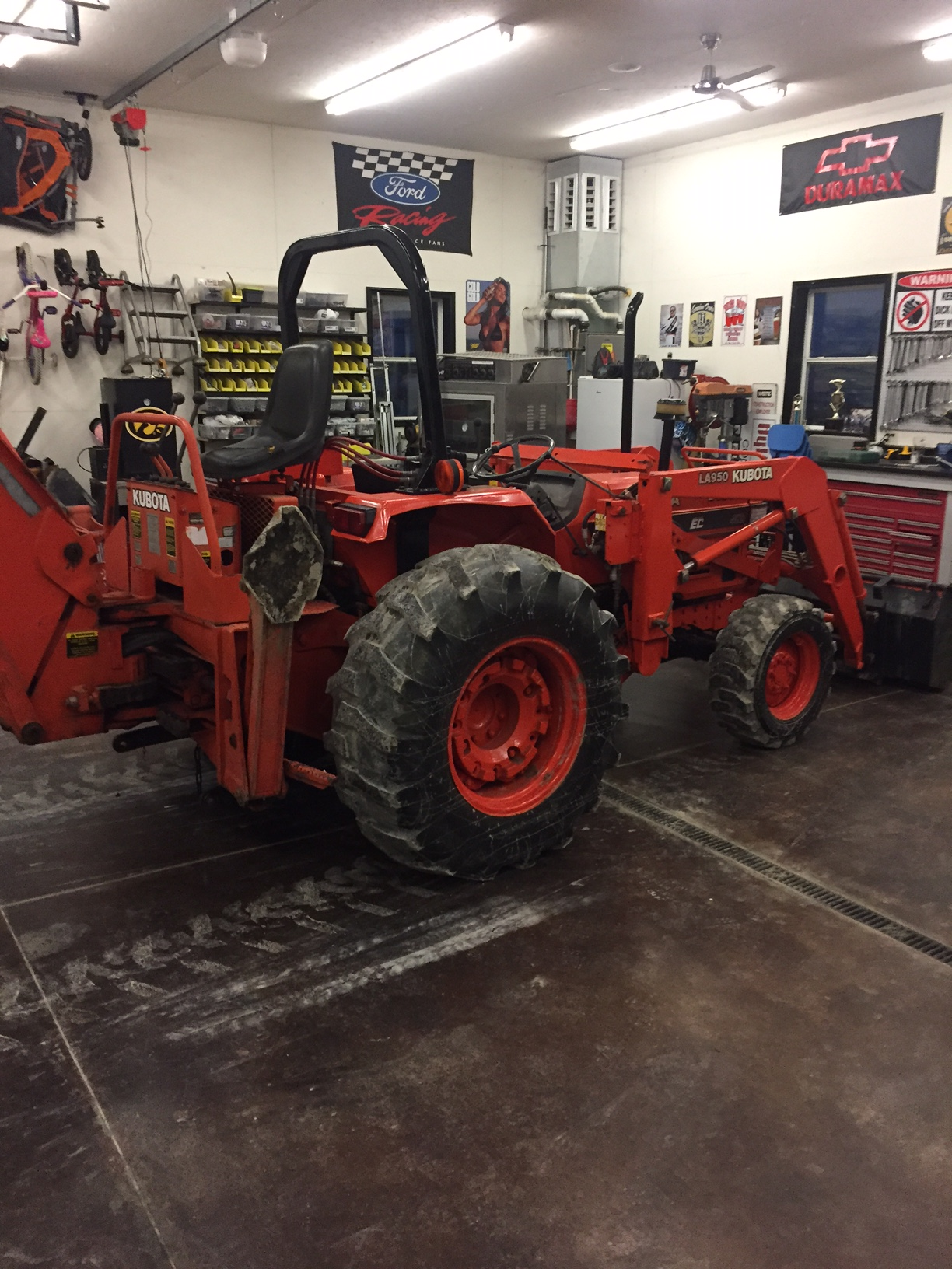

New member here and I just bought a Kubota L4850 with a L5412 backhoe and had a few questions. I originally signed up to get some opinions on the price, but my membership wasn't approved in time and I thought I'd miss out on the tractor. This tractor has the hydraulic shuttle shift with the ever clutch and I was looking for some operating advise. After I got her home I thought I might have got screwed, it was really tricky to get the tractor going in the high gears, but I notice the brakes were dragging and the inching clutch was missing a spring and not completely engaging. Those issues have since been fixed and everything seems to function as it should. I even read somewhere that when the clutch starts to go it will drag, so I jacked it up and put it in gear and then took it out of gear and the wheels stopped, so the clutch seems fine.
The dealer I bought it off of told me the only time I should use the clutch petal is when I'm moving and want to shift into higher gears. Is that correct, should I avoid using the clutch petal and use the shuttle shift?
Do I need to worry about what gear the tractor is in when I shift the shuttle into drive? Say I'm going down the road to fuel it up, is it OK to start out in 5th or 6th and can I do this at high idle? Then use the clutch petal to shift into 8th and do I need to idle down doing this?
Do I need to idle down the tractor before shifting the shuttle from forward to reverse when I'm doing loader work in the lower gears?
Is it OK to use the clutch petal when hooking up 3 point equipment or the backhoe when you want to slowly back into somewhere?
Any preventative maintenance or things to look for on this machine?
I really like it and it seems like a tank and should do everything I want it to. I have a 30 acre hunting property that needs a lot of brush clearing and I do about 5 acres of food plot, I also have gravel driveway maintenance. I am also looking to build a new house in the next few years and the backhoe should come in very handy.
I have a operators manual and work shop manual ordered to hopefully answer some of these questions, but they haven't came in yet.

Can't help with any of your technical questions. Nice looking tractor. If it isn't a re-spray, that's probably the nicest original 4850 around. Good luck with it.

It was a re-spray, not sure why they did it. I don't mind it though, makes it look nice.

Very nice tractor! Those models are renowned for being rugged and superbly engineered. You're lucky to find one in such good shape.
/ Kubota L4850 #11
Great purchase! I'm happy for anyone who finds and buys an L3 machine - the L4850 is an outstanding tractor, strong and bulletproof. This one has some nice options - air pre-filter, aux hyd oil cooler, wheel weights - is that a 4-in-1 bucket?
Don't be too concerned about the wet clutches - they are very strong. As with any clutch, excessive slipping isn't recommended. When using the shuttle to engage travel, its valving provides a uniform clutch application with minimum slip. Using the foot-controlled valve it's likely to slip more as it engages. Its an operator technique thing. From your questions its clear you already have the right things in mind - any clutch lasts longer if it slips less. Shifting at reduced rpm is sensible. Engaging with a smaller speed/rpm/direction mismatch is always easier on the clutch than with a big mismatch.
