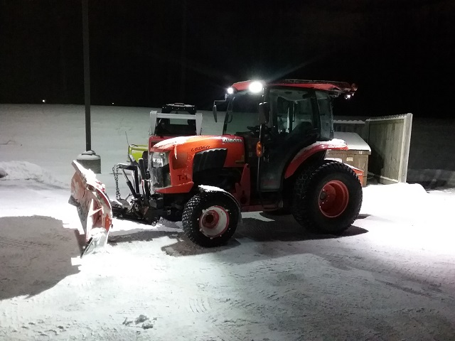

So, sure enough i just wasnt pushing the stick far enough to the right! Seems funny to be learning such simple things about a machine ive spent 1200 hours on. Im not sure if i necessarily like using the loader stick if i have to push it that far though. I guess i'll just have to see what feels better once it snows again. Hopefully my crossover relief valve and flow control valves show up in the next few days so i can button it all up.
   / Kubota L6060 custom front fenders and 900lb weight box. getting ready for winter.
#33

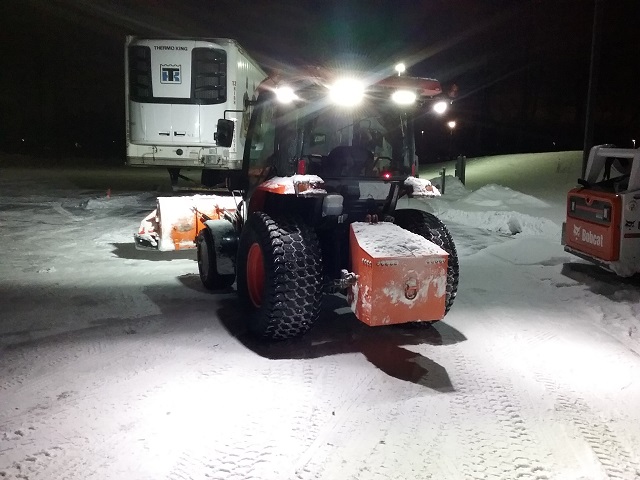

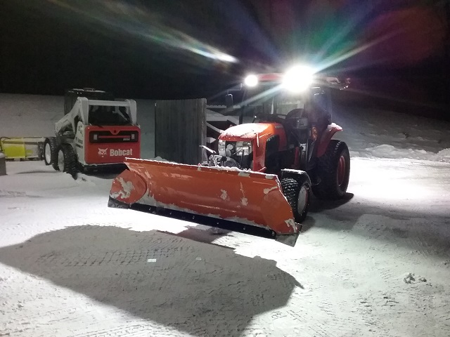

So, we finally got some snow to try out the new setup. We got a total of around 6 inches and i spent about 9 hours clearing it. Somewhat to my surprise, everything worked perfectly. The crossover relief was set at a good pressure out of the box. The flow control valves worked as they should despite being 12 dollar ebay valves and what im the happiest about is that the modification to the wings worked even better than i had hoped. I dont love having to wrench the stick far to the right for the tilt but it didnt bother me enough to switch to the 3rd function. I'll probably give the 3rd function a try for the next snow though.

here's some video of how it functions for anyone interested. Im still not happy with the lack of tilt angle or lift height but that's a result of the plow's design and i really dont want to hack it apart to make changes. Its still a 100% original truck plow that would just need the onboard hydraulic lines hooked up and the lights put back on to be ready for a truck. Im thinking ill be keeping an eye out for a Boss EXT or a Blizzard Power Plow for the next tractor.
