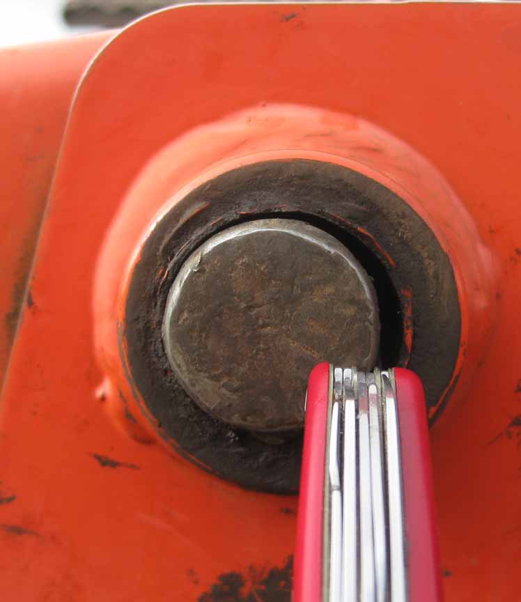

The rear pivot pins were originally 1.125" in diameter and were only slightly worn. The bores in the loader arms were egged out on each end by 0.060" or so, but the bosses in the side mounts had worn about 0.100" on each side. I have a hard time understanding how this could happen, as the pin is pinned in place so as not to rotate in the outer bosses. As such Kubota provided no grease fitting for the outer bosses; after all, they're not supposed to rotate. But the holes for the locking pins are significantly oversize for the locking bolts, and over the course of 2000 hours of operation, enough rotation in that unlubricated boss occurred to open them up. That slop put additional stress on the stiffener tube welds, which struggled harder to keep the arms parallel. When the welds failed, more side loads resulted in the bosses, creating a spiraling cycle of wear and weld cracking. It didn't help that much of the 600 hours I'd put on the tractor were spent shuttling landscaping materials around my hilly home site, most of it cutting across the slope face. That loading had caused the loader mounts to fail, and it became clear to me and others that had experienced the same issue that Kubota didn't plan for side loads and the FEL mounts, and now the pivots, were under engineered.
The most obvious problem is that neither the loader arm pivot bores nor the bores in the side plates were bushed, even though the front pivots (in the arms at least) were bushed. A contributing problem is that the pivot pin is allowed to rotate by the lock pins being lose in their holes, allowing the side plate pivots to wear. It was also apparent that the welds attaching the stiffener tube to the sides of the loader arms were subject to flex induced cracking, likely due to both the longitudinal seam on the tube and the location of the weld itself.

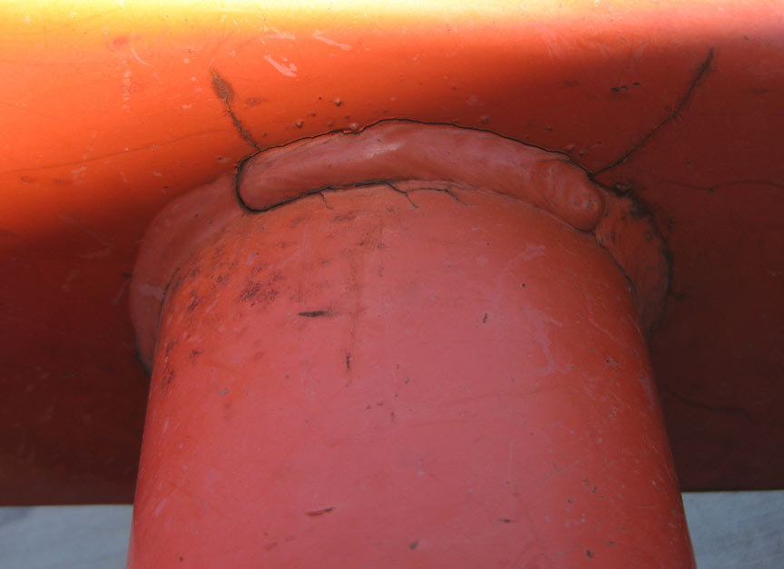

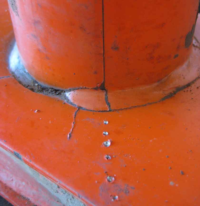

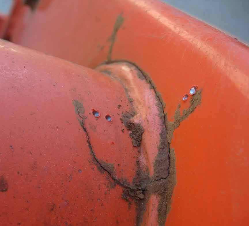

This photo shows a crack propagating from the end of the tube seam into the weld, then on into the loader arm itself. The seam acts as a stress riser, focusing loads into the toe of the weld and leading to failure. So in addition to enlarging the pivot bores for bushings, I'd need to re-engineer the stiffener tube attachment to keep the stresses away from the loader arm walls, channeling them to the outer edges of the arms.
The welds attaching the stiffener tube to each loader arm were cracked, as were the loader arms themselves. Repairing the welds pretty much meant cutting all the way through the tube to get to the bottom of the cracks, so I just ended up cutting the stiffener tube off. That allowed me to get each loader arm onto the vertical mill to bore out the pin bosses. But the kerf of the cuts shortened the stiffener tube. I had some 0.125" 4130 plate on hand, left over from repairing the curl cylinder anchors on top of the loader arms. There was just enough to make up gussets for each end of the tube that would span from top to bottom of the arms, and an inch or so fore and aft of the tube wall. The scope of this job had quickly expanded far beyond what I'd anticipated, but my small shop was (just barely) equipped to handle the repairs.

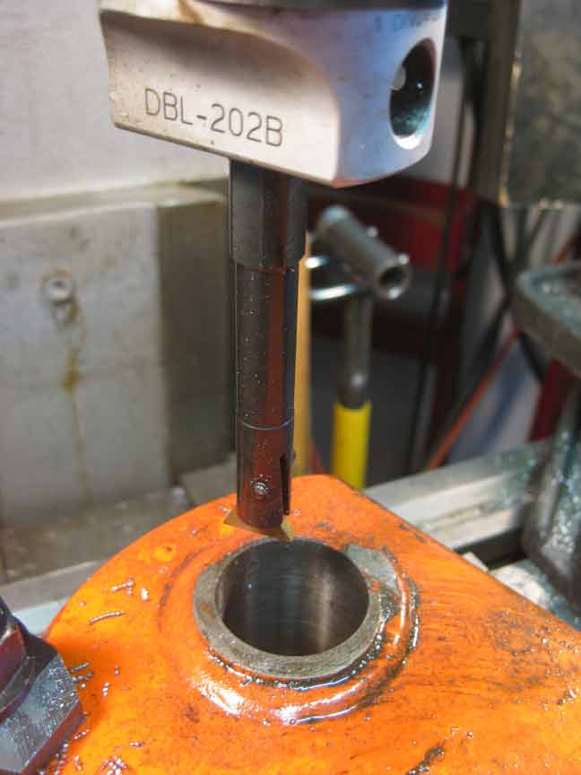

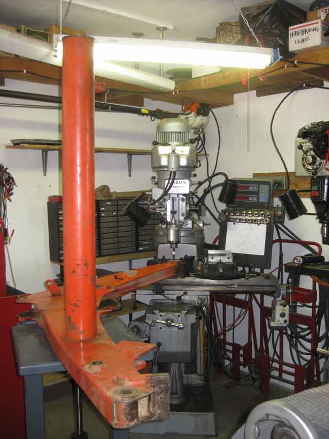

In my mind the highest risk part of the repair was getting the pivot bores bored and bushed. The size of the arms was right at my limit to lift and accurately position them, and it seemed likely that the bores wouldn't end up exactly perpendicular to the arm. I was also concerned I'd have trouble locating the center of the bores because of the wear that had taken place. I chose to start with the bores in the side plates, hoping any experience gained there would help out when it came time to do the arms.
The side plate bore was 3.100" long, and based on the D.O.M. tube I'd be using for the bushings, I settled on a 1.334" OD and 1.140" ID for the bushings. It would have been nice to use 1.125" for the ID, but the tube wouldn't clean up at that diameter, and I had enough bar stock on hand to make up new pins. I supported the side plate on 1-2-3 blocks and clamped it onto the milling table. I indicated off the outside of the side plate bushings to find the bore center, then bored the upper bore. My boring bar wasn't long enough to reach the bottom bore, and the ones that were flexed so much that the resulting surface finish was unacceptable. To get around that problem I flipped the side plate over, then indicated off the ID of the freshly machined boss to locate center. That didn't give a perfectly alignment of the two bores, as I found later that the side plates were slightly bent. But it was close enough that the pins were a light drive fit, which was actually a good thing since they weren't supposed to pivot.
That left the pivots in the loader arms themselves. I hadn't quite made up my mind to separate both ends of the stiffener tube from the loader arms at this point, so the photo shows it still attached. I have a small lift table mounted on casters, and that proved invaluable in supporting and positioning the outer end of the arms. Again the 1-2-3 blocks were used to support the bore end of the arms, and I used a level on the arm to adjust the height of both the mill table and the lift table. I don't have a lot of faith trusting level for precision work like this, so I backed that up with a try square against the quill to double check. That long bore came out with surprisingly little diametrical difference between top and bottom, likely due to the light finishing cuts I used at the end.
I started with the side plate bushings, which were 1.085" long including a 0.100" thick flange on one end. The ID and OD were as mentioned above. Once turned, I held them in the milling vise and located the grease ports for drilling. A little time with a deburring tool and a sanding drum on the Dremel took care of any sharp edges. The loader arm bushes were turned and drilled in the same manner.
