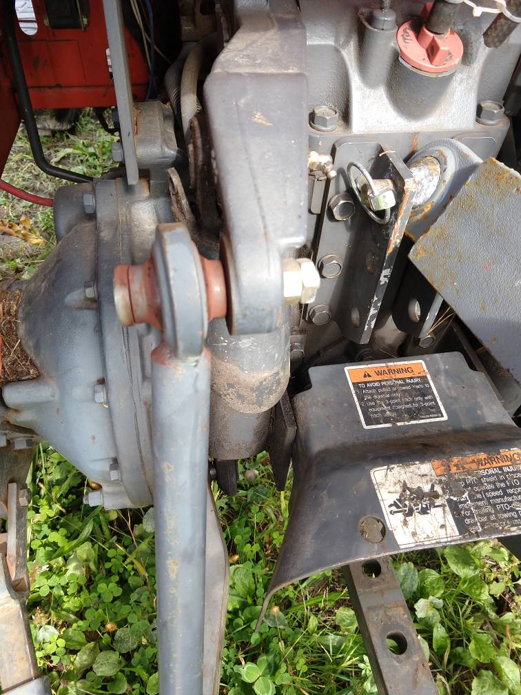

The pin I have on the lower arm is a cat 0 which has a 5/8 thread on it and no not even it would fit in the hole on the top arm I bought a cat0 to cat1 bushing and hooked the side link on upside down. pinned the yoke to the top with a half inch pin but it binds up when trying to spread the lower arms out to fit over the pins on my implement
   / kubota lift link question #12
Kubotas are metric for those parts sourced in Japan, inch for most parts sourced in USA.

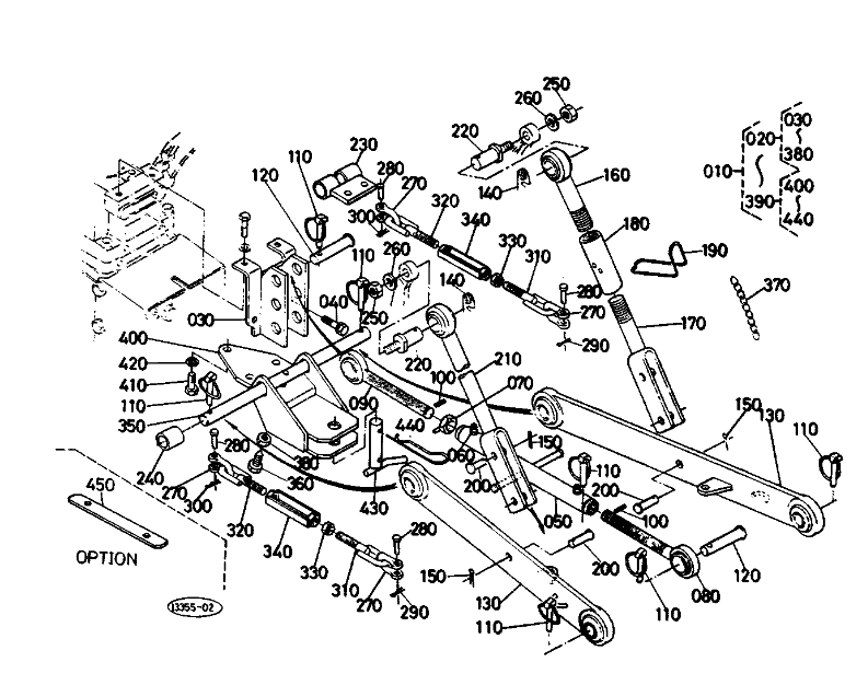

Per the parts book ( https://apps.kubotausa.com/illustrated-parts/ does NOT work in Firefox) you need the lift pin PN 66706-65280 Kubota: PIN, Part # 6676-6528
It is part 220 in this diagram:
623856d1570385513-kubota-lift-link-question-b71003pointlinkage-png
Alternatively, find the right size bolt to match the hole on the tractor side of the lift arm and use bushings on the linkgage side.

Do you need a picture of what the kubota arms should look like?
#16
thank you for the part number aczlan hard pin to find found one in Australia found one on messicks online store bought it. If I cant find another one closer I will just have to make one myself you guys have really been helpful I owe yall a picture when I get it all hooked up.
