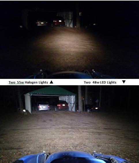

I had two 55 watt halogens on my ROPS. Replaced them with two 48 watt LEDs. Huge difference (see below). On Amazon, 2 for $19.00 with free shipping!
Sucool 2pcs One Pack 4 Inch Square 48w Led Work Light Off Road Flood Lights Truck Lights 4x4 Off Road Tractor Jeep Work Lights Fog Lamp for Jeep Cabin/boat/suv/truck/car/atv/vehicles/automative/jeep/marine - - Amazon.com
