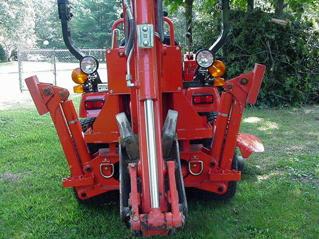

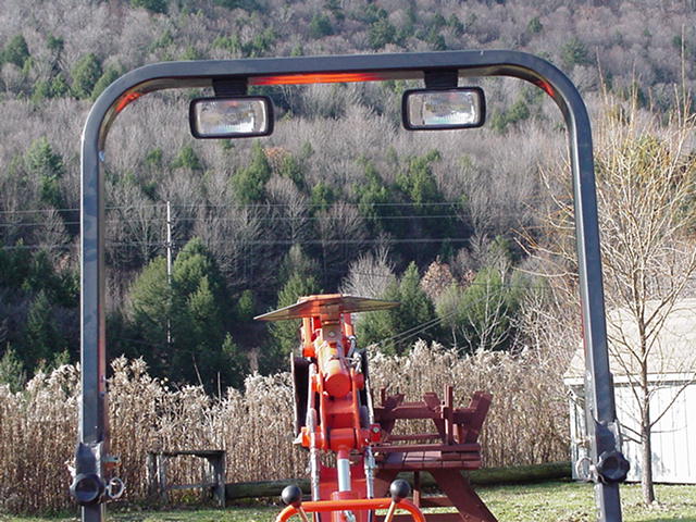

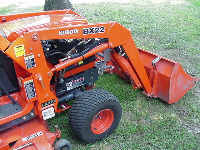

I think just about everyone on this site did a light modification
at one time or another.Attached are a few lights that I added only after upgrading the alternator.I was one of those guys that drilled the ropes among other parts of my BX22 that I drilled.As you can see we have forward facing ropes mounted lights,rear work lights and tucked inside mounted lights.For those that are familiar with Brooklyn, NY. ,When I turn them on it looks like "Coney Island on Wheels".
