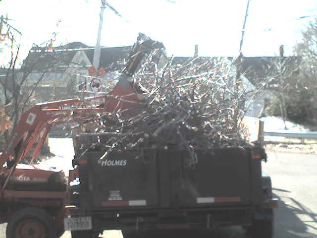

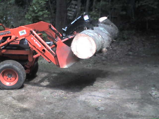

It is 20" per thier site... actaully 21" measured, and the bucket is 19"
I like the "underbite" allows me to pull stuff, mulch, logs, branches into the bucket with a firm bite....If the teeth meet at the cutting edge you don't get that strong of a bit on stuff...
I can grab a 30" log with this set up, and atleast a load and 1/2 of mulch verse with out the grapple......
The reinforcing of the bucket and the mounting plate raise the grapple approx 1-2 inches, thus the 20" grapple now ends up inside the bucket vs on the cutting edge...

I thought I had remembered the bucket being 19" but was not sure...I am in the process of designing my bars and working on a mock up to get the length rigth on the cylinder rod mount.
hauling loose material...
I am considering making up some bolt on "attachments" to the grapple bar to expand it's capabiliy in grabbing/holding (specifically) leaves...I think I will try and shoot for having the tip of the tooth grapples fall just inside or at the edge of the bucket bottom but on the bull nose of the bars I may weld a accepter plate to bolt to...
I was thinking about some sort of wide paddles made out of angle iron and maybe some expanded aluminum...that I can bolt to the grapple...
Thanks again for the measurements...
