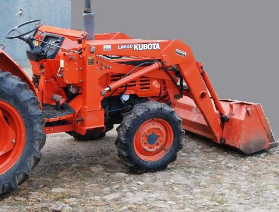

TractorData simply reports what was supplied on the tractor when new. The L345 was offered with the US made 1720 loader. The number was the load rating in pounds - the kilogram rating would have been around 780. The 1720's main drawback is that its not easy to take off/ put back for mowing.
The LA450 I put on my L345 is on the small side for it - If I were outfitting a L345 with a non-original loader today, I'd look for a LA650 loader from a L3250, L3450, L3650 tractor.

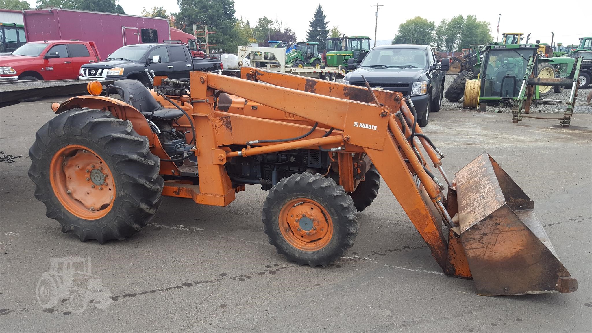

If you don't need a removable loader and want to go original, there's a rare used 1720 here in Oregon for $2k. Looks like the type that has a front pump & tank for the loader. The under frame on these is large with lots of bits & pieces, bolts, etc. Buying from a distance, ask seller to make sure its all included.
