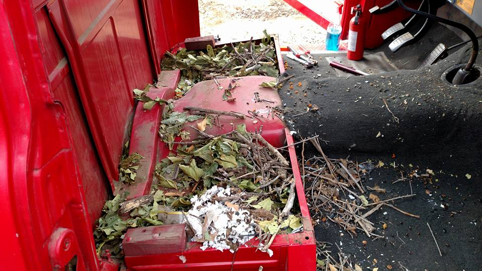

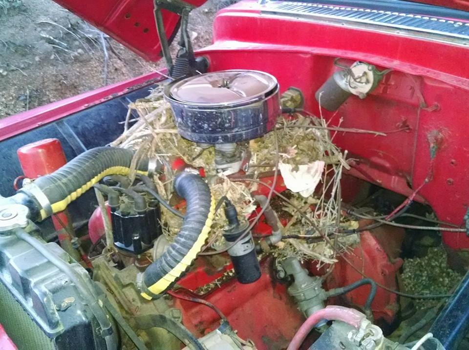

This happened to my IH pickup a few years ago. I found it before I started it.

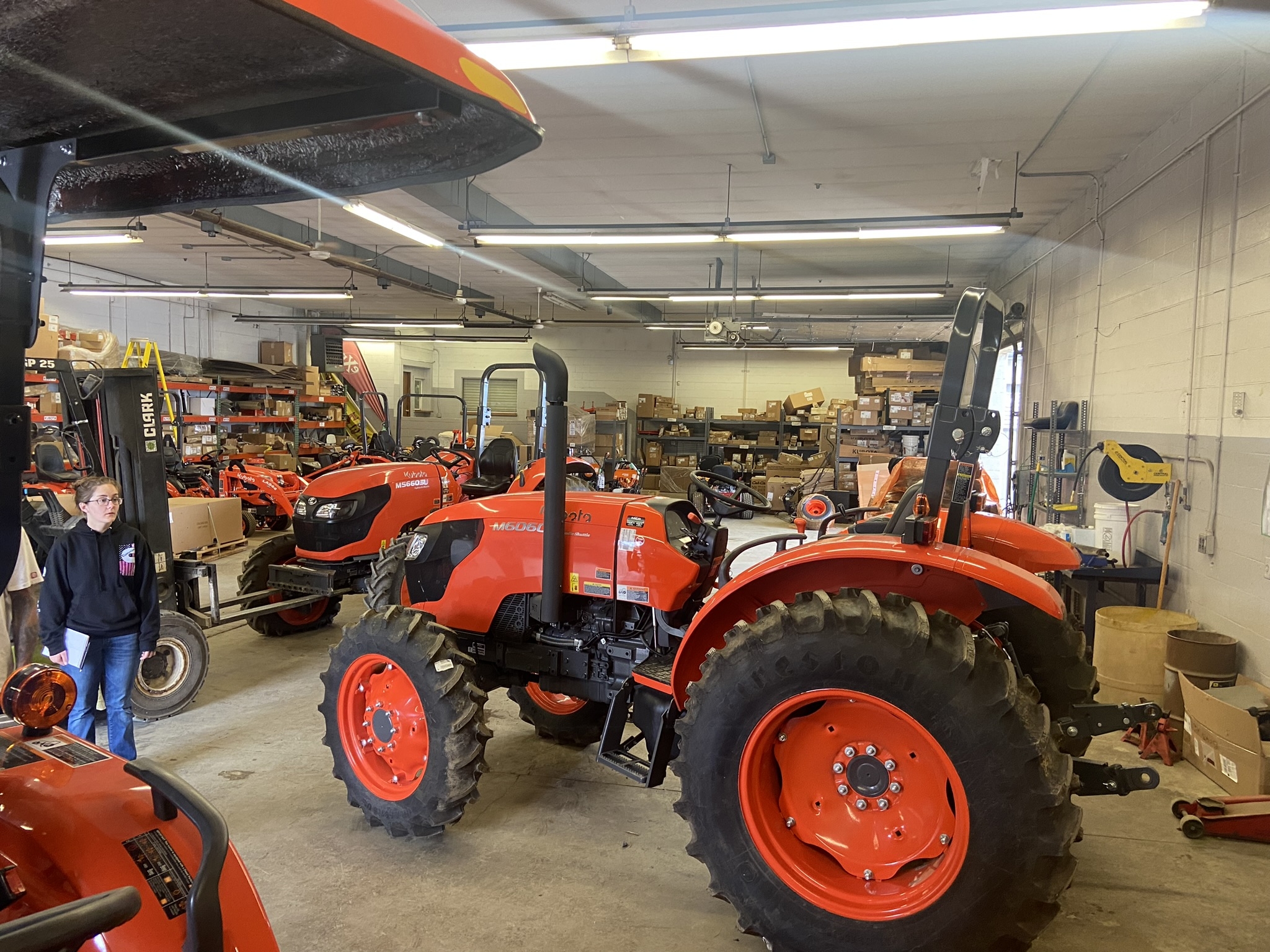

They were kind enough to transfer the front weights from old (on left) to new one.
And insurance was not bad (400/year via State Farm)
Funny part is that it does not look bad when they do 60 month/0 percent as when you pay cash.
