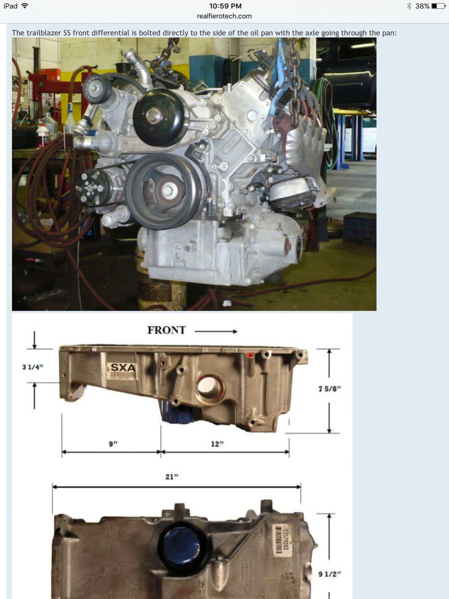

Didn't GM build a vehicle where the front driveshaft actually went through the oil pan and not just had the oil pan wrapped around it?
   / Kubota M6 axle in the oil pan #6
The Chevy Trailblazer had the differential actually bolted to the side of the pan with the axle going through it - some engineering there! - LOL

It was that Trailblazer setup that had me wondering, how to maintain those seals..., but not to worry,
this is old news, and those interesting features are already on the big tractors as MHarry has pointed out.
