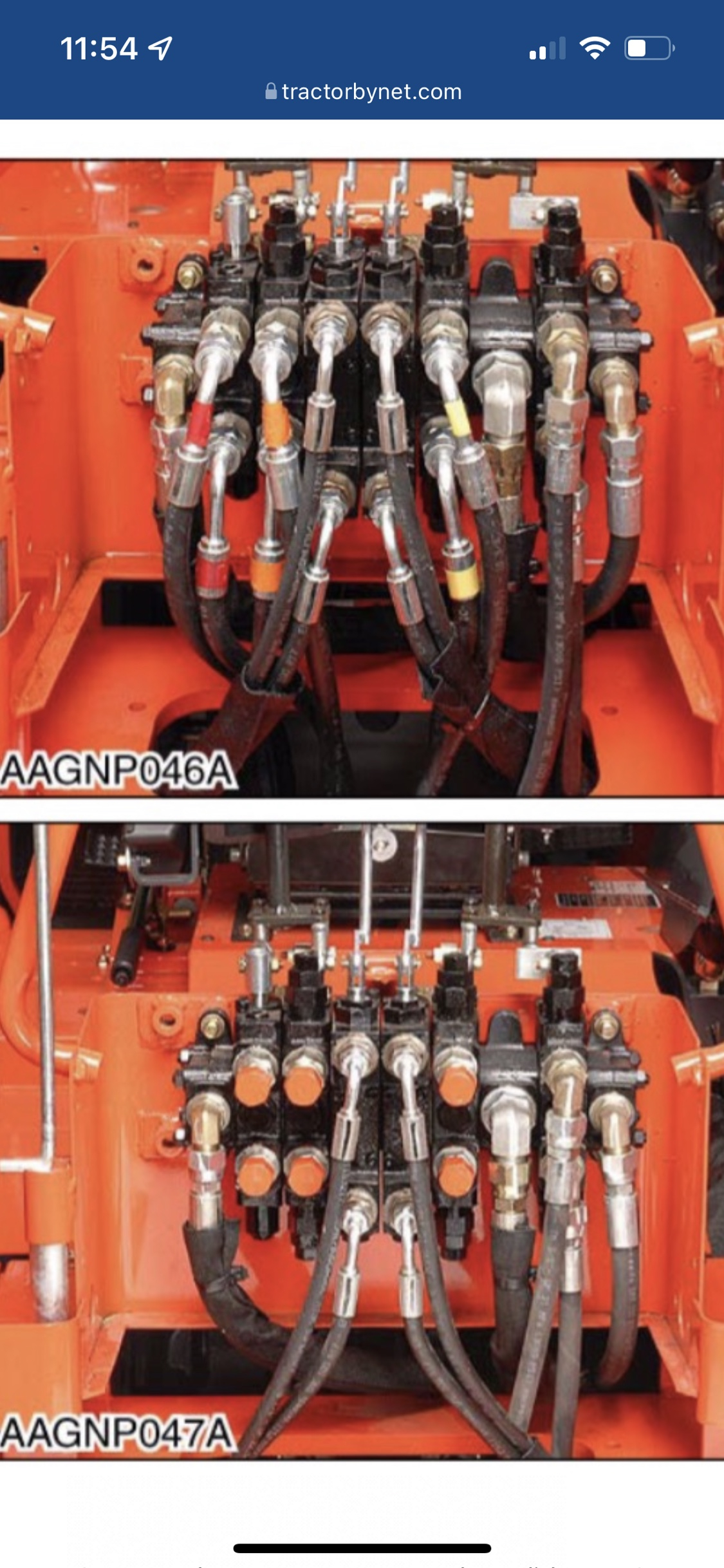

Here’s a picture of the main valve body. It’s the black thing on the top and bottom of each valve stack. I couldn’t find any apparent reason it was sticking open.

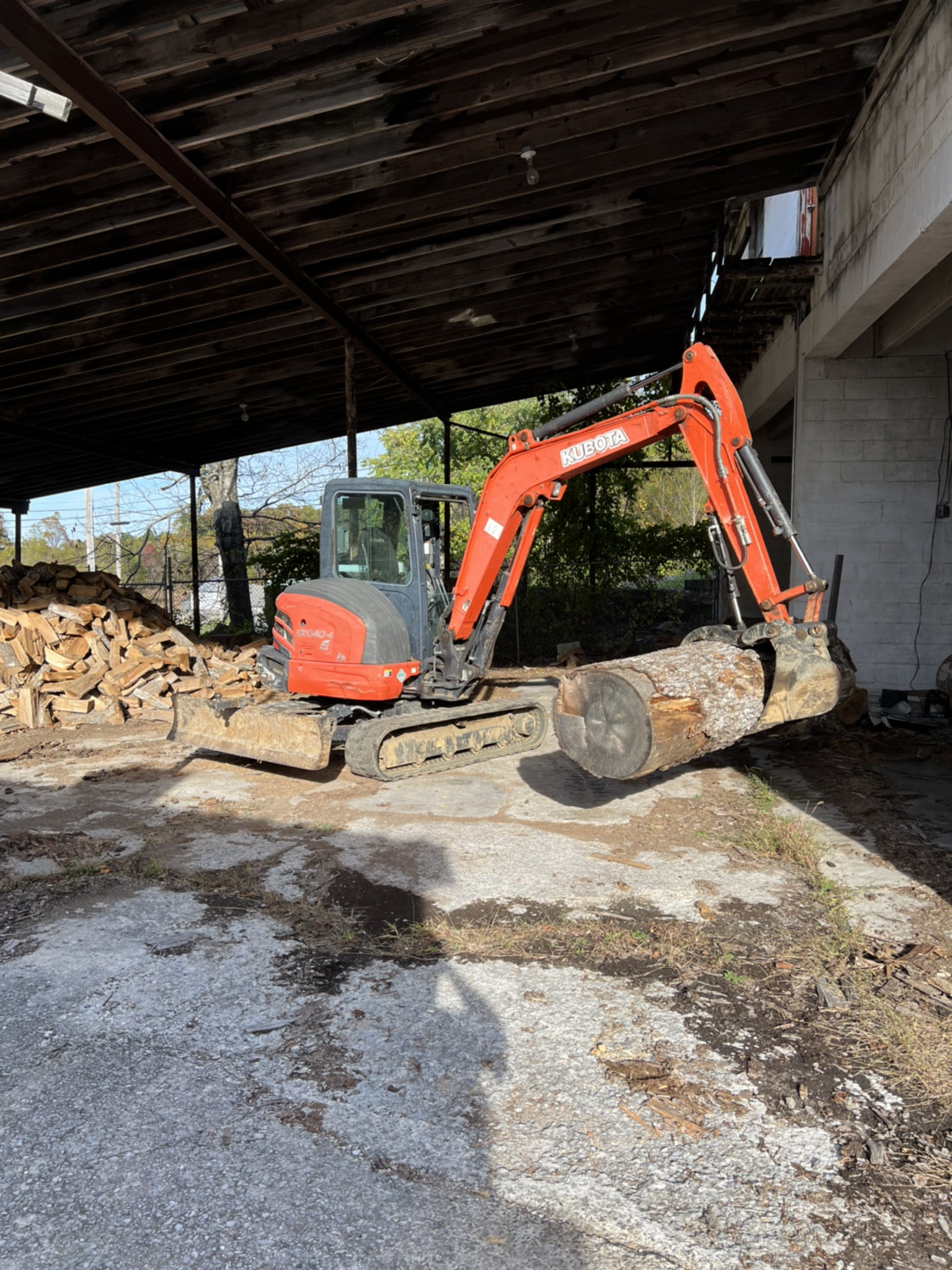

Some possible good news with our backhoe problem…
Because it happened right after reattaching the hoe - and I had been pretty careful about keeping everything clean - I decided it was likely either airbound or something with the diverter valves.
Cycling the swing many times didn’t alleviate the problem - which should have been improved if it was airbound. So that left the diverter valves.
I had pulled and pushed them correctly too. So it wasn’t just that they were set wrong.
I took off the cover plate below the seat to look at valves directly and the linkage on the right had not fully pushed the lever. I manually pushed it the final few millimeters and that solved the problem.
Or it was just a coincidence😊.
Thanks everyone for your helpful suggestions.
