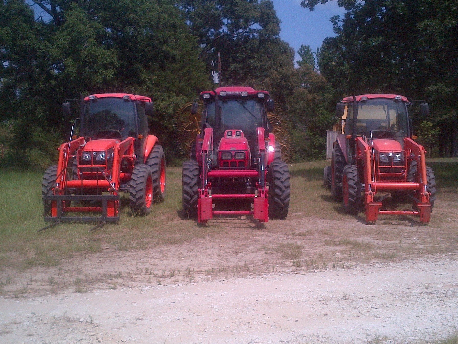

IMG-20130607-00325.jpg I have R1's

thanks foreman. nice machine! those tires look far better than the standard skinnies.

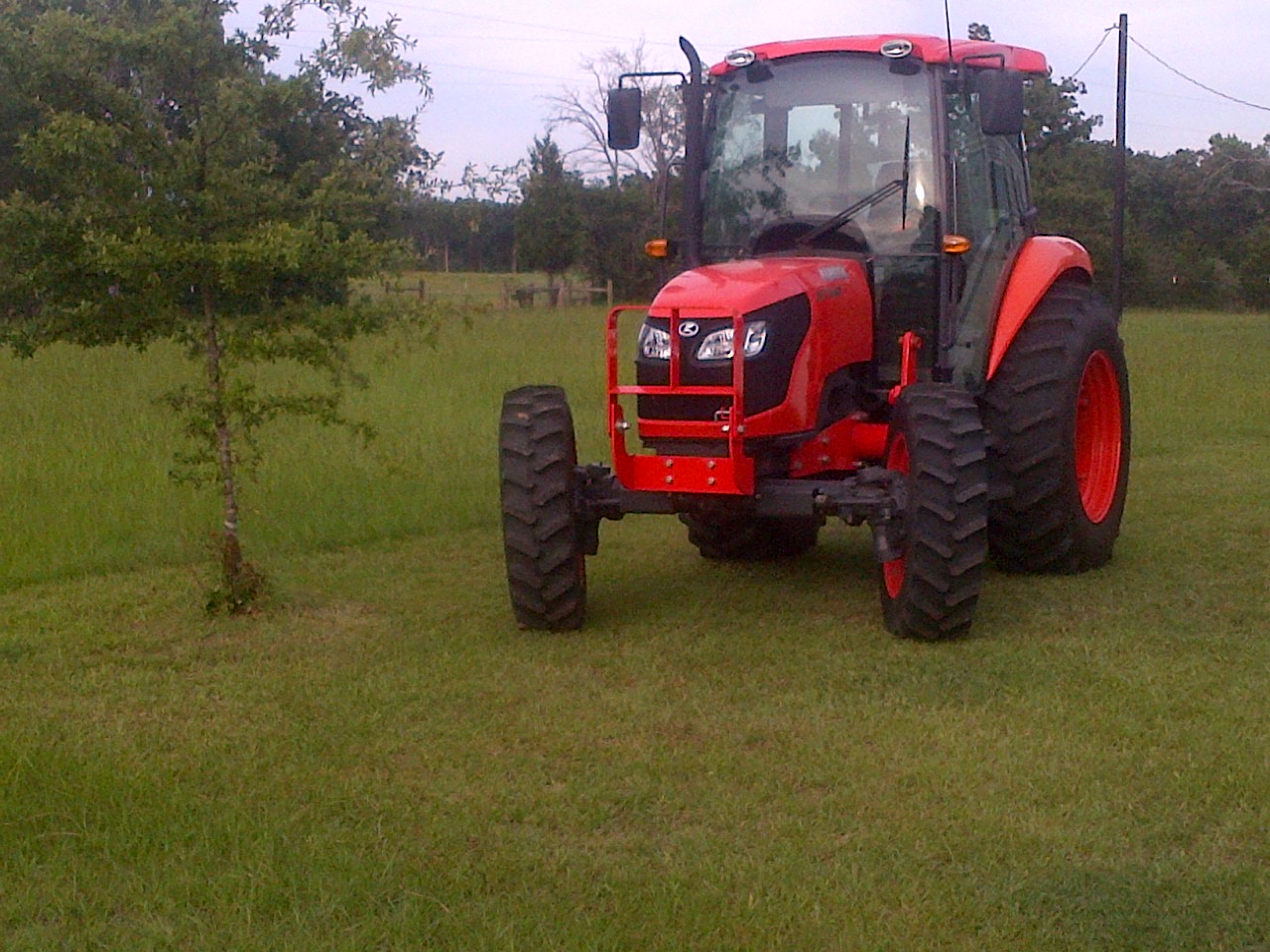

The cost is 900 for the two fronts with rims and the ride is way better.
I also have it widened out 6in. Front and back and the rears loaded,doesn't feel tippy at all been threwalot with it,now the stock one will scare you,after been in the new one trying the same stuff.

Like said, set those tires out farther and it'll feel like a different tractor. Loaded rears add a whole nother level of goodness! :)
