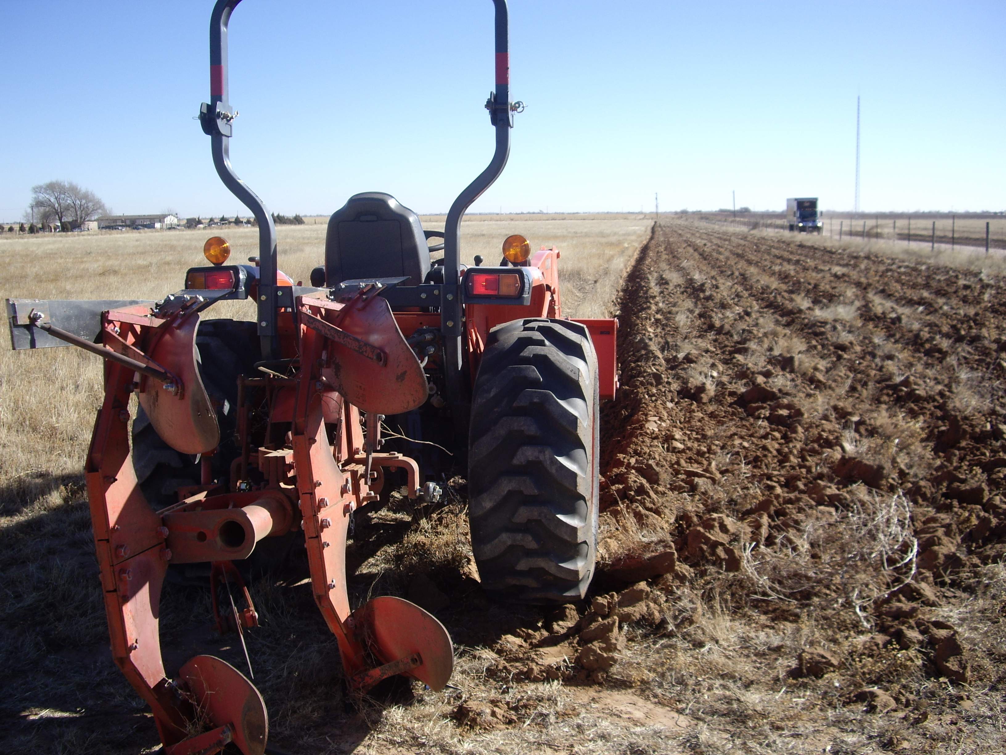

I know that :), but does he have these tires and not R-4's. Can't plow with R-4's.
Hmm.
I know this is and old thread but I was searching for something.
I guess I'll have to stop plowing since all I have are R-4's
:D

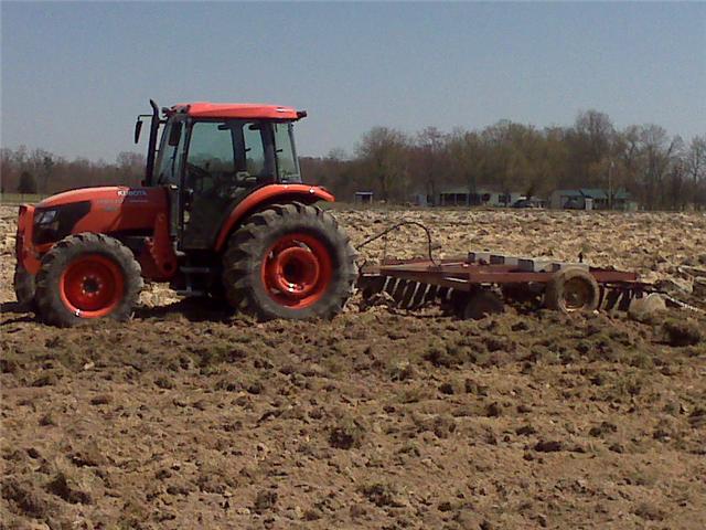

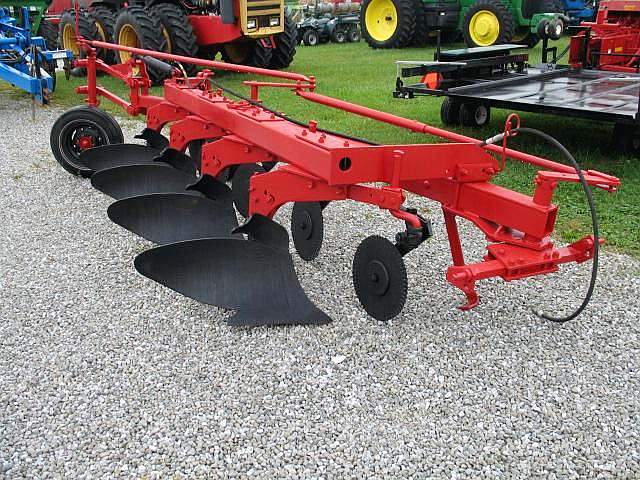

I would say that you will be fine with the M7040 and 3 16s. The M9540 did great in 4WD with an International 710 with 4 16s, I did add rear wheel weights to reduce slippage. I was impressed with the performance. Here is a pic of the plow. Another pic using the disk. Sorry about quality. (cell phone)
