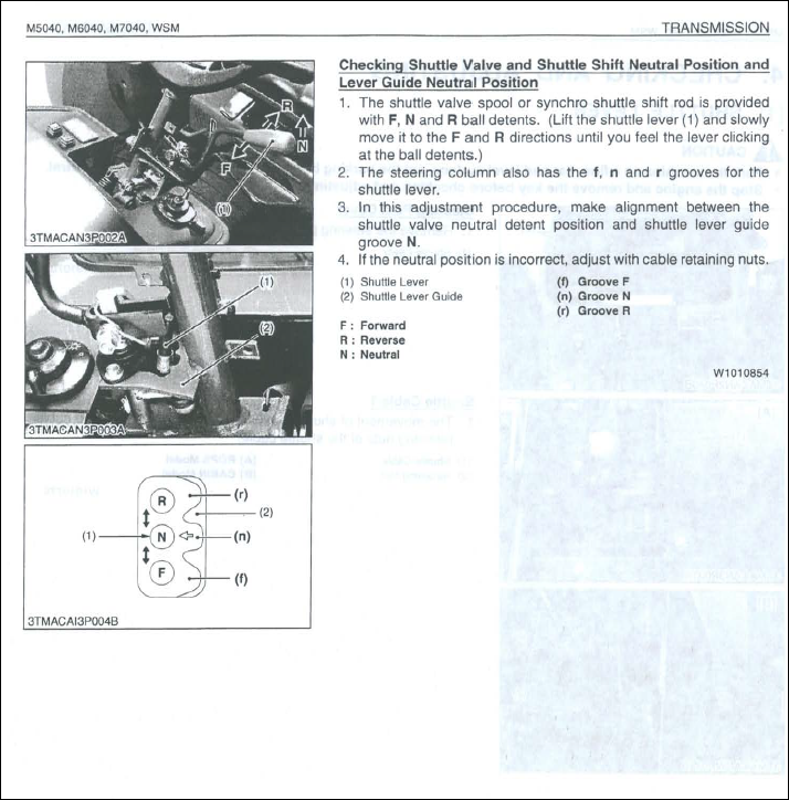

I would suggest to check operation of shuttle control cable & linkage. On a M4900 I once owned I had to R&R sync shuttle assembly because of failed synchronizers but it was stuck in reverse.

Thanks Tx Jim, that will at least give us a starting point. Hopefully that's the sole problem.
