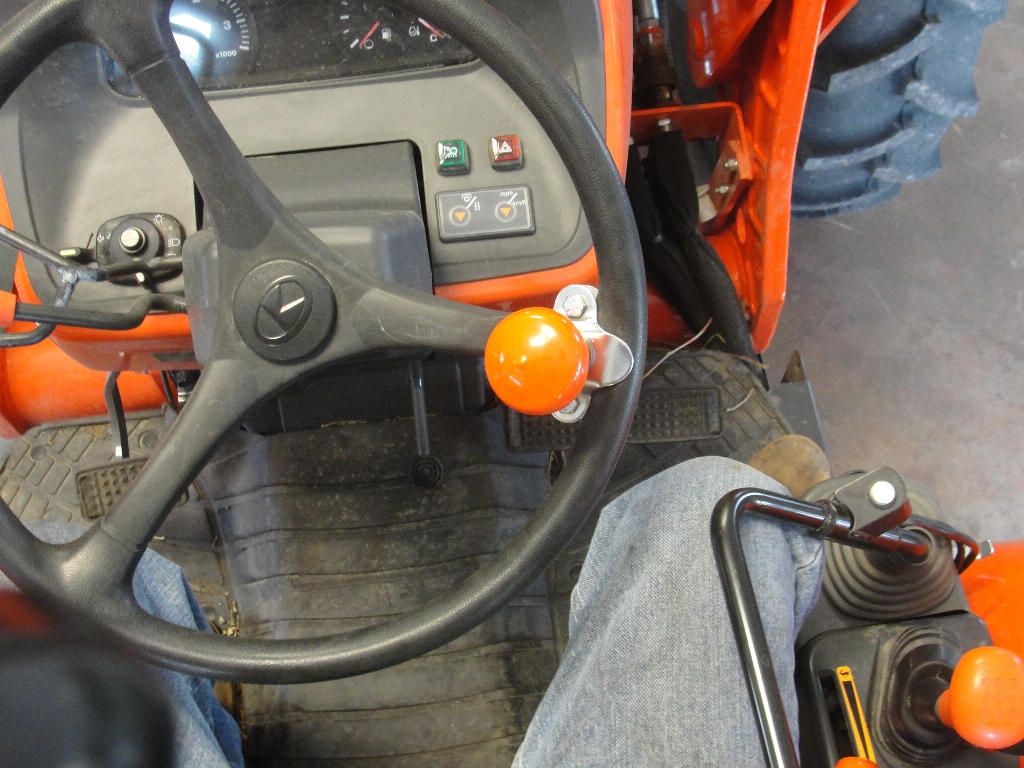

Interesting, I have an M7040 with a Kubota loader and the neat little switch that allows me to run a grapple, siphoning off fluid from one of the other movements to run a third function. Anyone have a picture of the electric cut-off switch? I don't remember seeing one, and am not near my tractor at the moment.
David from jax
   / Kubota M7040 with Loader hydraulic connections #8
See the little white button right and low in the pic. It's on the joystick stem.
   / Kubota M7040 with Loader hydraulic connections #9
Mine doesn't have that little switch, mine has a switch up on the top side of the handle for the loader. It diverts pressure electrically when it is pushed, and from what I can tell, doesn't do anything when it isn't pushed.
Thanks for the picture Ovrszd!!
David from jax
