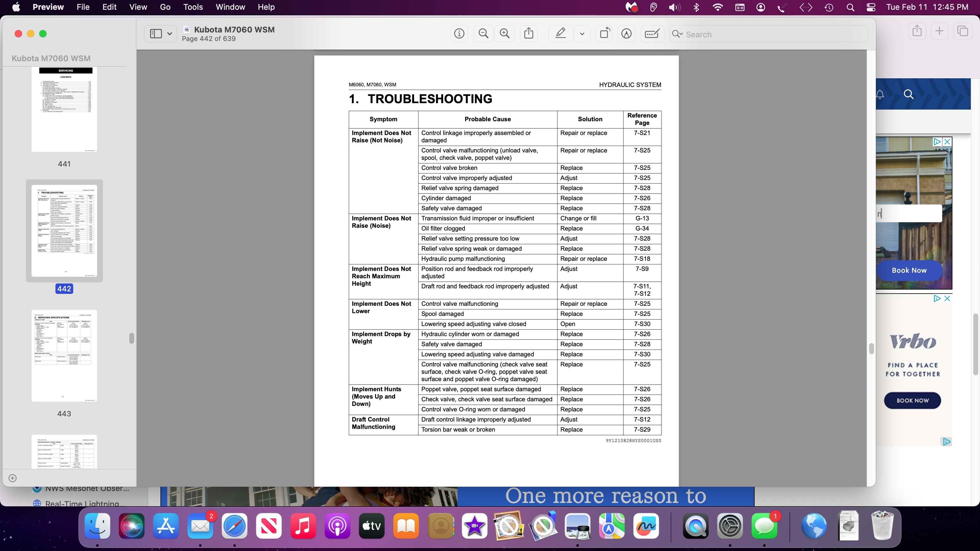

My 3 point hitch randomly stopped working yesterday. The arms are all the way down and will not rise. I have tried turning the knob beside the seat, I have also checked the draft position lever. Everything else seems to be working normal. Any ideas what I should do next? I had been using the front loader and the 3 point was working when I started working.
Dealer is sending a service tech after the snow storm unless I can figure it out - This is because he says it cost to much to haul it to there shop - what if for some reason it needs to get hauled to the shop but is not covered under warranty? Does this mean I will have to pay for the initial service visit plus the hauling to the shop and work and parts done there?
Any ideas what us going on?

   / Kubota m7060 3 point hitch not working #8
#9
I can post other pages if needed.
Thank you, I will let you know - Is that from the owners manual or WSM? I will look into the different probable causes.
   / Kubota m7060 3 point hitch not working #10
WSM. Downloaded it shortly after I got my 7060 but don't remember where I found it.
   / Kubota m7060 3 point hitch not working #11
the feedback rod may be jammed telling the tractor that the 3pt hitch is where the control wants it to be even if it is not. happened on my first tractor but it used to have a backhoe installed before I bought it so I suspect the linkage was not used very often.
