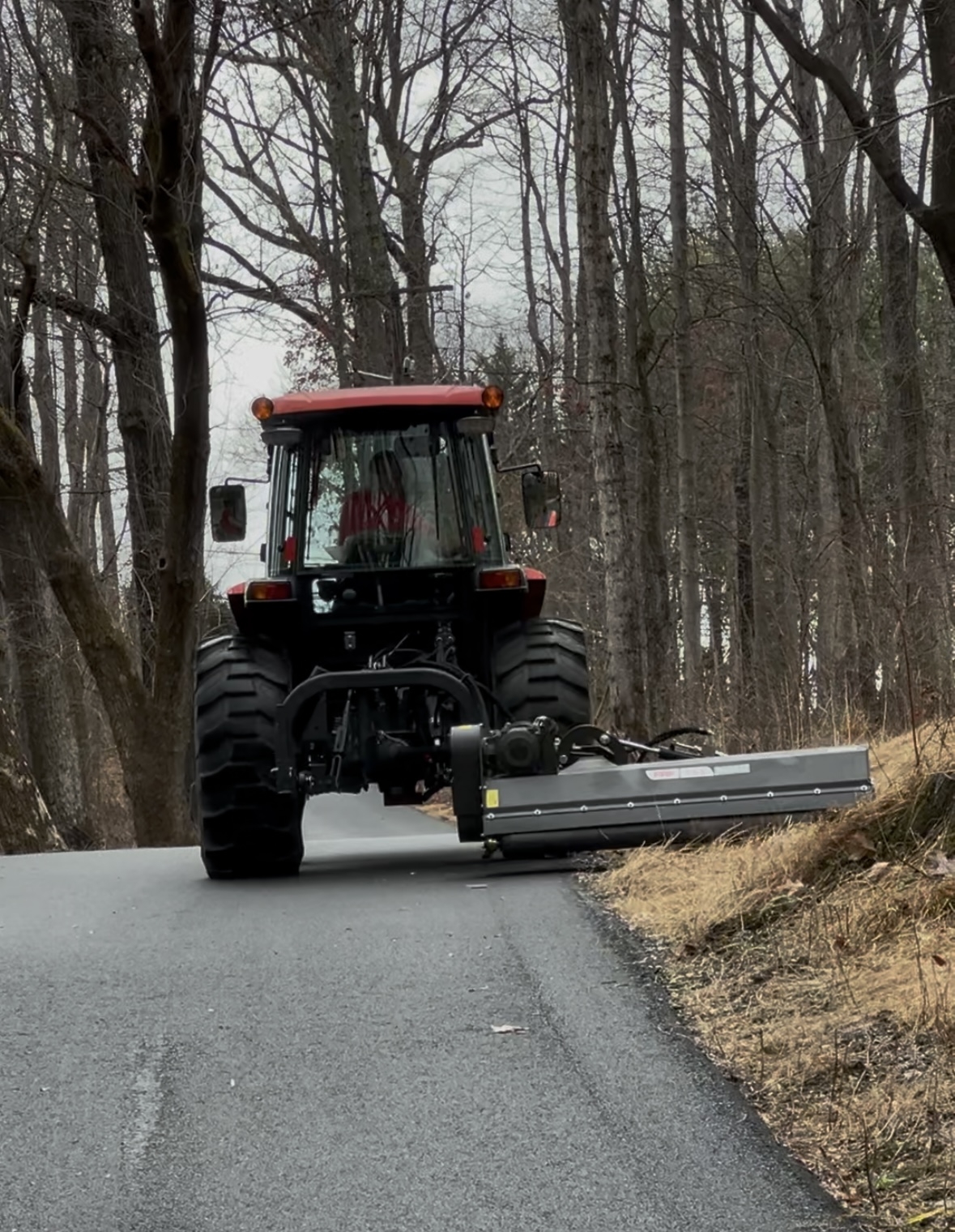

Resultantly I recently purchased a Ironcraft ditch flail mower. I didn’t want a china built mower. The Iron Craft mowers are made by Cosmo (Italy). I’ve only used it for a short time, but it appears to be well constructed for a budget option ($4,500). Might be worth considering depending on how often you are going to use it.
My mower is a FRF-165. (165 cm / 65”). I’m running the mower behind a Kubota L5740 with filled rear tires and max wheel weights. It handles the mower very well.
Could be a more budget option for you.

Del Morino (Italy) is definitely the gold standard in flail / ditch fail mowers, but my use is infrequent and I couldn’t justify the high cost for my application.
Thanks. Mine will be lower use as well. Can you share where you bought this from. That's more in my price range.
