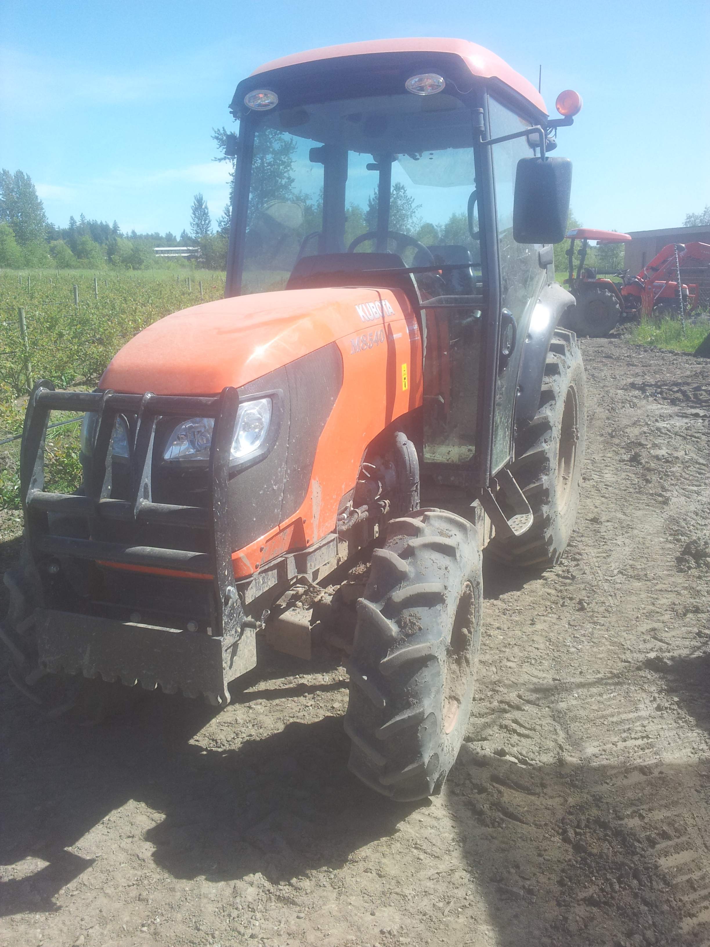

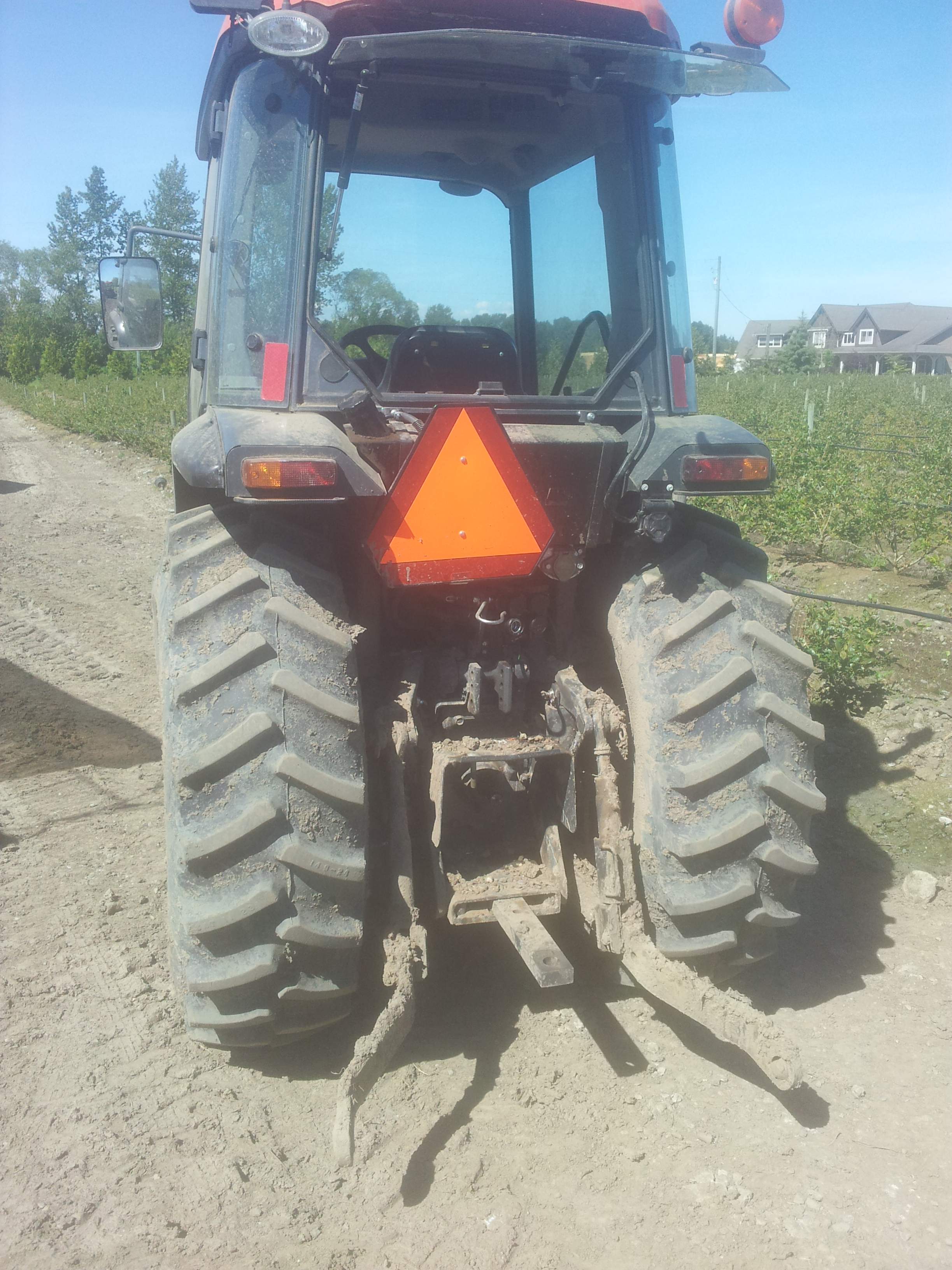

I meant that i have radial ags on both the front and rear, your tractor might be rough riding because of the different tires?
When did you buy yours and can you let me know the tire sizes? I have 380's on the rear but don't recall the front size and I'm away from the tractor.
I really don't know why they mixed tires like that but I would prefer radials on the front as well.

Interestingly, our M9540 (not narrow) is our roughest riding tractor too. I think it's due to the overall light weight and short wheelbase. Put something heavy behind it like a 15' batwing bush hog and it will wear you out by the end of the day.
I've weighted mine a couple different ways and tried to smooth it out and just can't find the proper setup. I have heard from others that the full frame M series are rough as well but I've never ran one to be able to comment on it.

I have ridden in some regular width Kubotas and I have come to believe it's the misbalance of weight coupled with the short wheelbase. In one case of an M7040 the addition of 4 rear weights total in addition to the cast wheel centers made a dramatic improvement. Prior to that the dipping and rising as the tractor "rocked" front to back was pronounced. Afterwards it was pretty much eliminated and the ride was much better. I believe their tractors--the utility ones--are too light in the rear. The bigger ag versions rode smooth.

rear tires: 14.9-24
front tires: 9.5-16
with no suitcase weights and a heavy duty rotary cutter 5ft on back and going at 10kmp on a smooth path, ride was decently smooth
