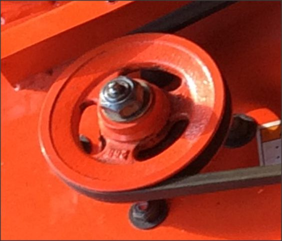

Looks like the pulley said HELLO MR ROCK OUCH!

I wouldnt think mowing tall grass with a 24hp diesel zero turn would be to much to ask. If it was I would expect the belts to be wearing out...this looks like the pully contact something and rolled it over.
Here's what I am saying:
In my opinion a mowers with deck pulleys like this (and sealed bearing spindles) were probably not meant for regular mowing acres of fields with fairly tall grass.
ZD1211 is a fine mower no doubt but meant primarily for maintaining established lawns.
This would be a big step in the right direction, but it's still meant primarily for established lawns, just more hours of use:

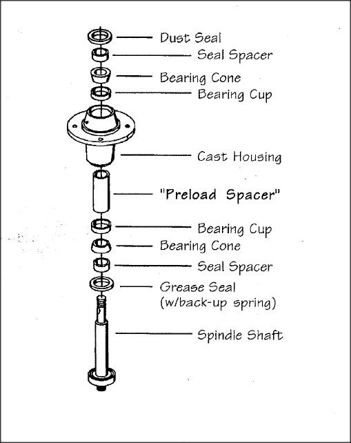

Theres a grease fitting right in the pic of the "sealed bearing" spindle.
   / Kubota Mower Deck Pulley Failure #14
Yes that's pretty funny, realized that from an earlier post - the photo in post #12 with the cast iron pulley is different though.
Conical roller bearings, the exact same as 2000# trailer axle bearings, but it's still meant & designed to be a lawn mower.
