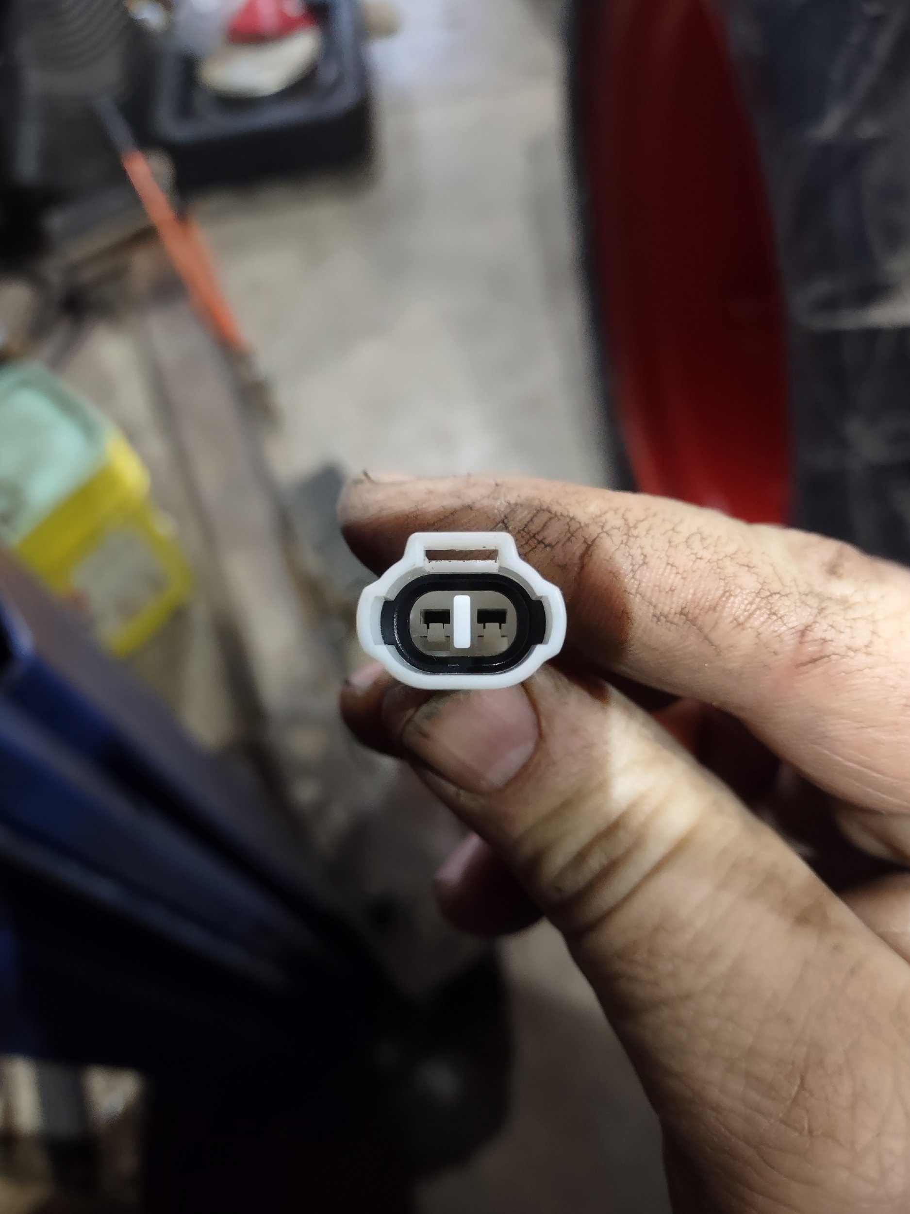

Some customizations to our new MX6000:

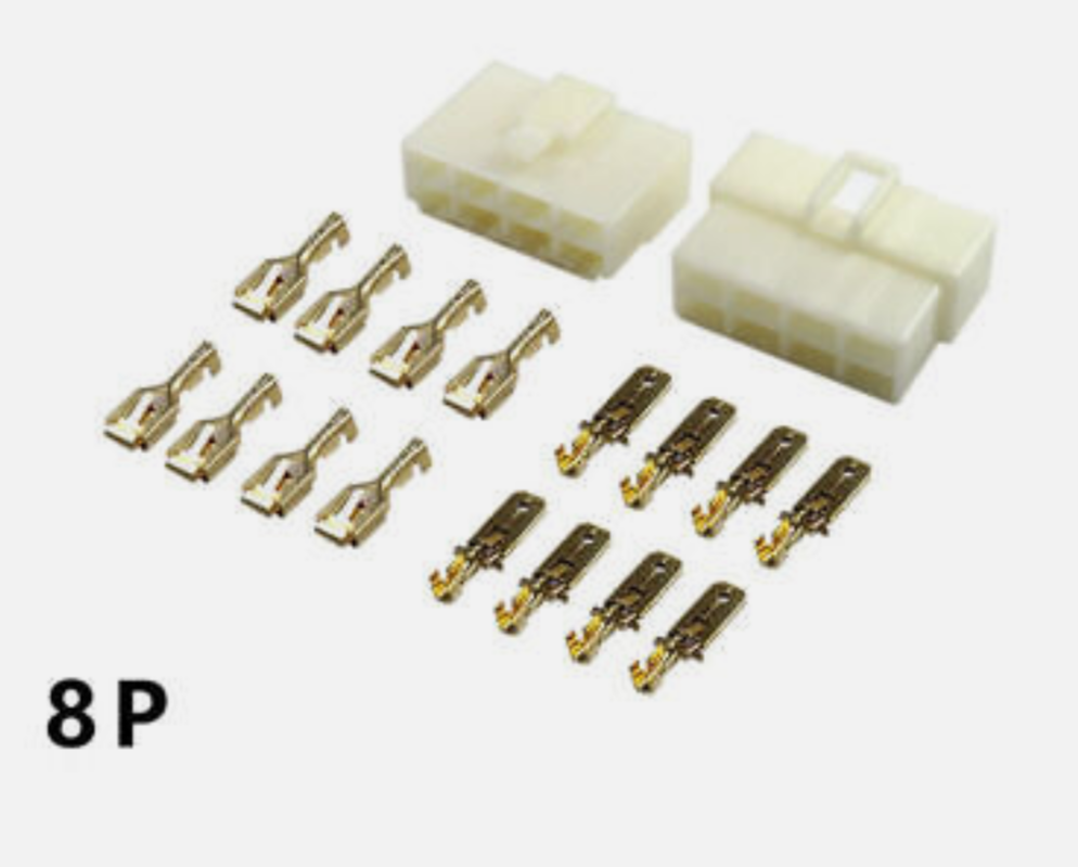

Trailer hitch wiring plug, didn't want to spend $200 on the Kubota trailer plug, only to have to adapt it to our existing trailers.
I found this plug on eBay for $6, plugs right in: 1 2 3 4 6 8 Pin Auto Car Connector Plug Male Female Socket Terminal Set 6.3mm | eBay
I will wire a 4 pin plug into it to match our other tractors, will wire turn signals up and a separate switched power for the running lights so I can control those separately from the tractor lights.
Relay for switched power:

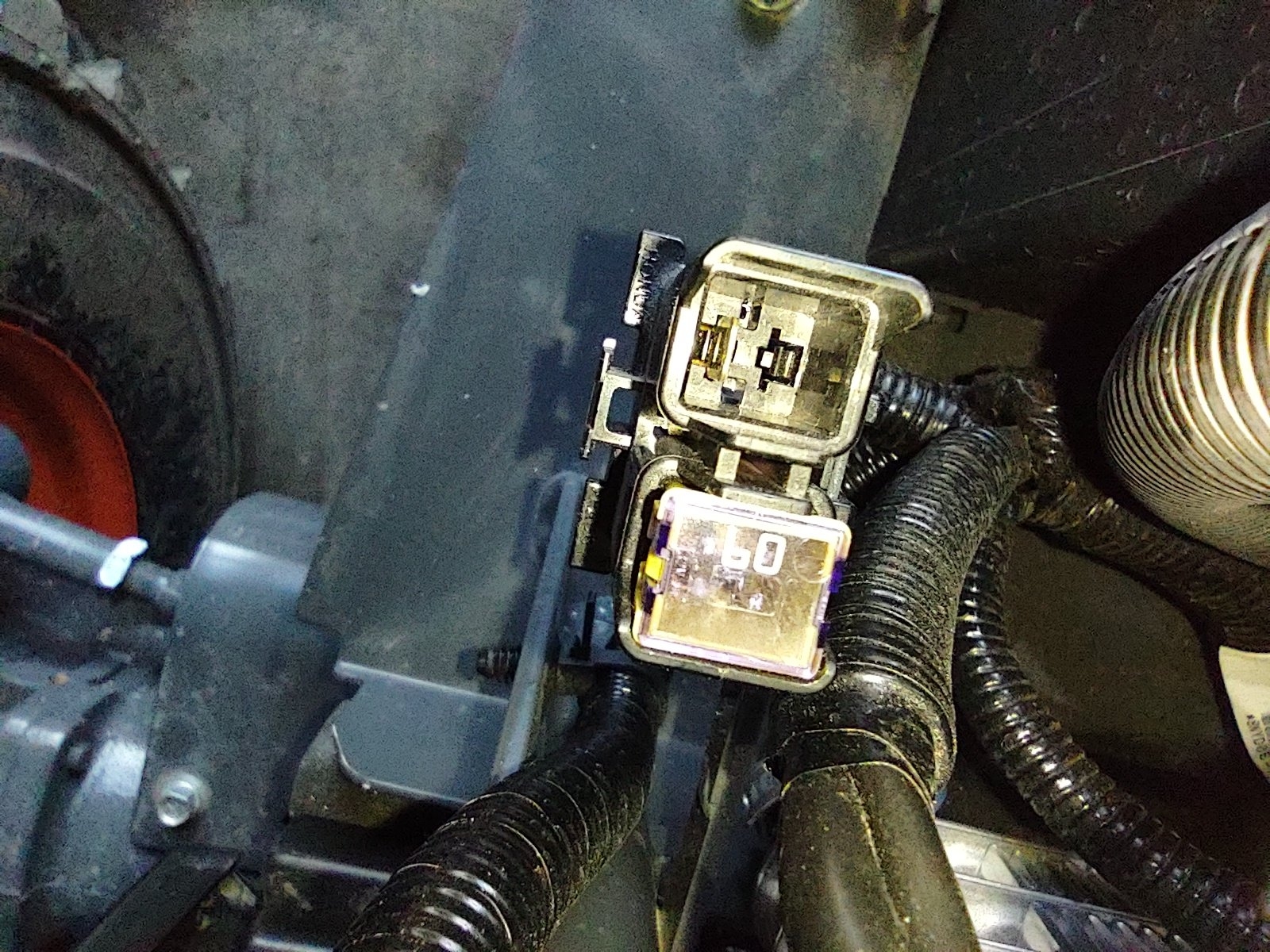

Under the hood by the battery is a empty fuse holder, it has constant power, but the "load" side of the fuse holder is empty:
Digging online, it appears to be a Yazaki 7114-4122-02 which is available from Mouser ( https://www.mouser.com/ProductDetail/Yazaki/7114412202 ) per the details I found at a Ford Fiesta forum: Fuse Box Info, Custom Circuits, Terminal Part Numbers…No more Fuse Taps!

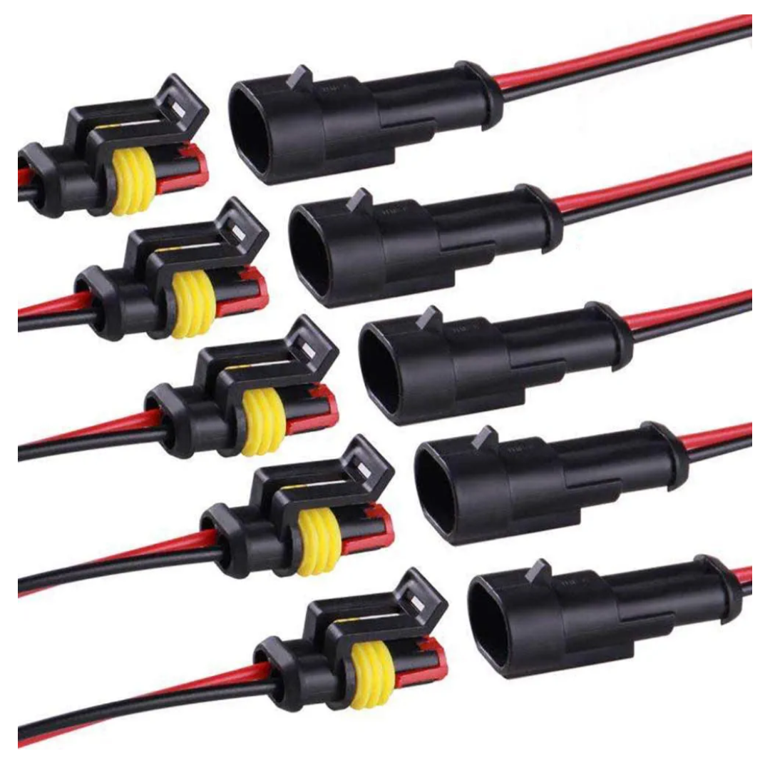

On the right side under the hood there is a 2 pin plug switched power plug which is used to power the diverter valve (or at least, the install instructions I found for a aftermarket diverter valve plugged into there):
It looks like this plug will fit: https://www.amazon.com/Connector-waterproof-Female-Suitable-Connection/dp/B08579V5ZJ/
How I will put it all together:
I plan to connect a relay into the unused fuse with the new connector and trigger it from the 2 pin connector, then run a wire to the back (off of the LR corner of the seat) and put 4 switches there:
1 for trailer running lights
1 for the front light bar (to be added to the canopy)
1 for the rear light bar (also to be added to the canopy)
1 for a 2 pin plug at the top of the ROPS to plug a strobe into

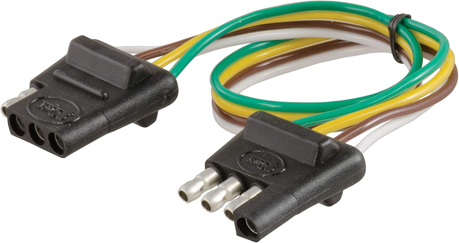

The plug I will put on the back will be something like this: https://www.amazon.com/CURT-58380-4-Way-Connector-Socket/dp/B001EOYJEE
May also put a 7 pin "RV plug" on there as well for the big trailer lights, but that will just be teed off of the 4 pin plug.
As to why:
Lights:
The stock lighting is marginal for working at night (especially with a loader on the front), I often end up cutting or moving hay after dark and want to see where I am going.
Our L3830 has a Nilight 126W 20" bar (from this set: https://www.amazon.com/gp/product/B06XPHPMQ4 ) facing forward and 2x 27W 4x4 lights facing back (these: https://www.amazon.com/gp/product/B00ECVMOIY/ ) and it needs one more forward facing light that can be aimed to the side (for cutting hay at night)
There is a key switched work light circuit on the MX, but it is fused at 15A (or 180W), that is enough for the worklights on the L3830 on paper, but I want a little more overhead and will be adding at least another 18W.
Trailer plug:
We have haywagons that are setup with a standard "4 pin flat" trailer harness running from end to end for lights and a set of magnetic lights that plugs in at the back (the trailer wiring is stapled onto the wagon frame from end to end and the magnetic lights have a 12" harness on them so you dont have to secure a wiring harness to the trailer every time, just stick the lights to the metal plates on the haywagon frame, plug them in and go), our L3830 has a 4 pin trailer plug spliced in so it has turn signals and a switched power for the running light plug.
The magnetic lights also have a 2 pin plug tied into the running lights to plug a beacon into.
The method to my madness:
I am more or less duplicating/improving on what we already have on the L3830 for our new tractor and trying to keep all modifications "plug in" friendly (ie: no stock wires getting cut if possible, everything off the shelf and duplicateable).

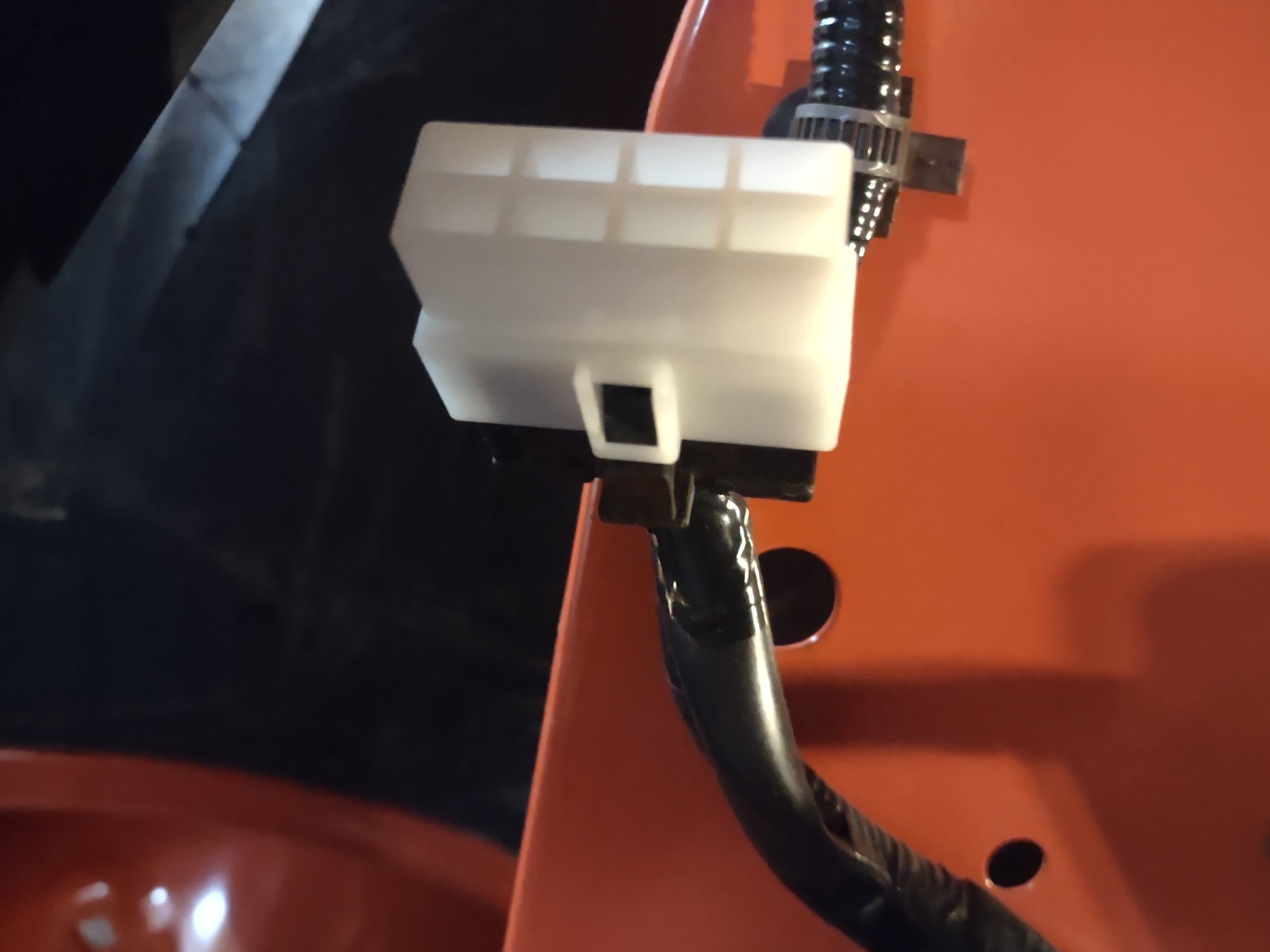

A 7 round pin (I think tractor trailer) came on my tractor and I made a converter to the 7  flat RV in the hope of having lights and eventually electric brakes.
Most if not all of the pins are dead and I was having trouble finding information. This was years ago when I just gave up. It's not really high on my to do list and I'm hoping to learn something from your project Aaron👍

Got a picture of the plug?

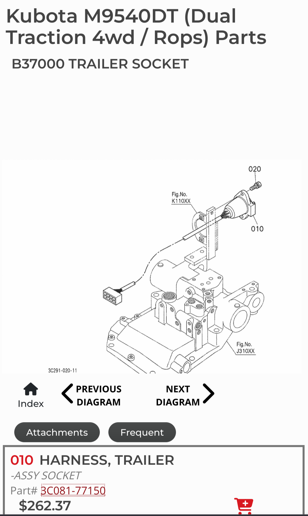

Edit, from the Messicks parts diagram for the M9540 I bet the same plug could be used:
The battery harness looks enough different that the fuse holder probably isn't there.
