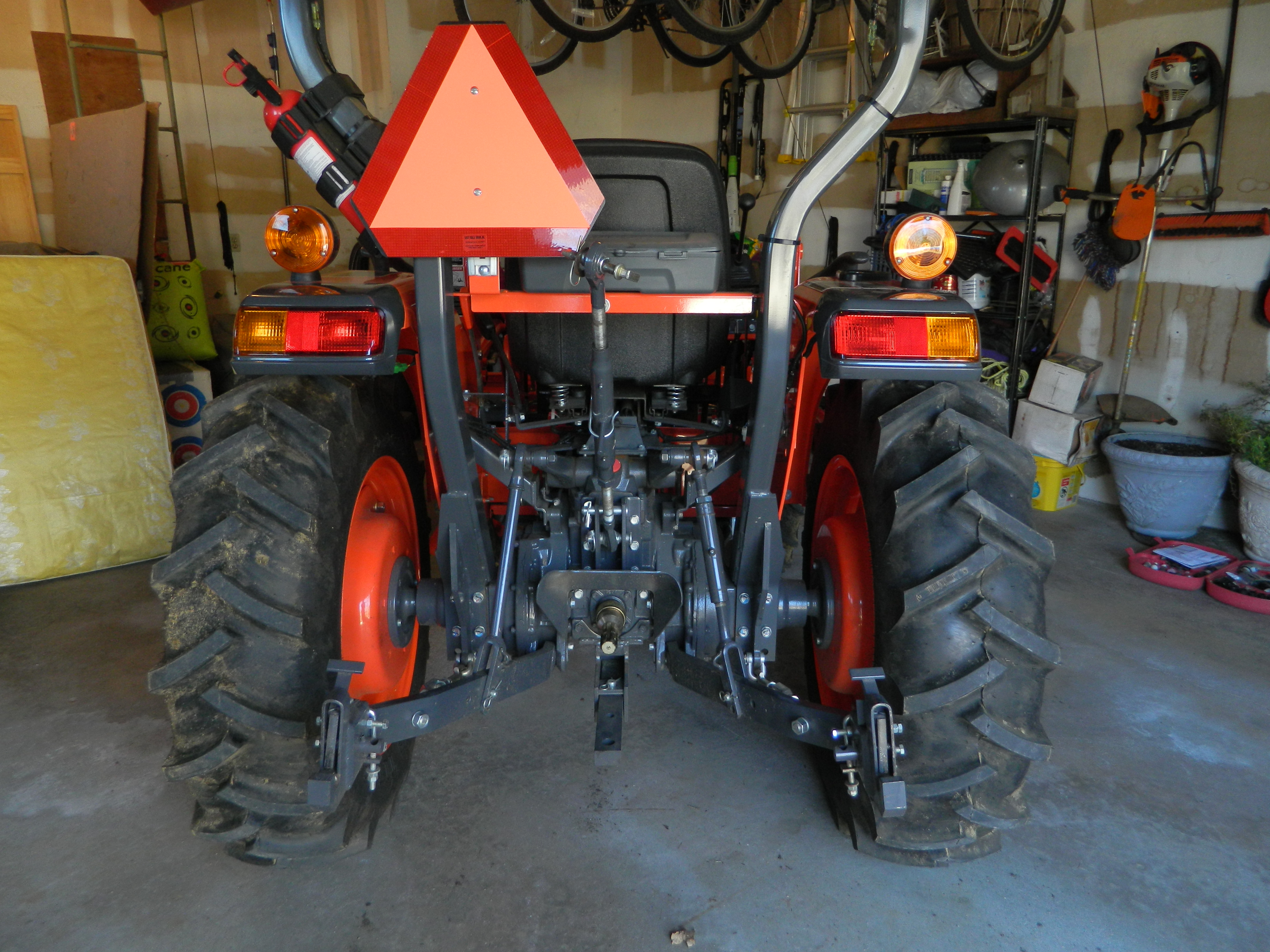

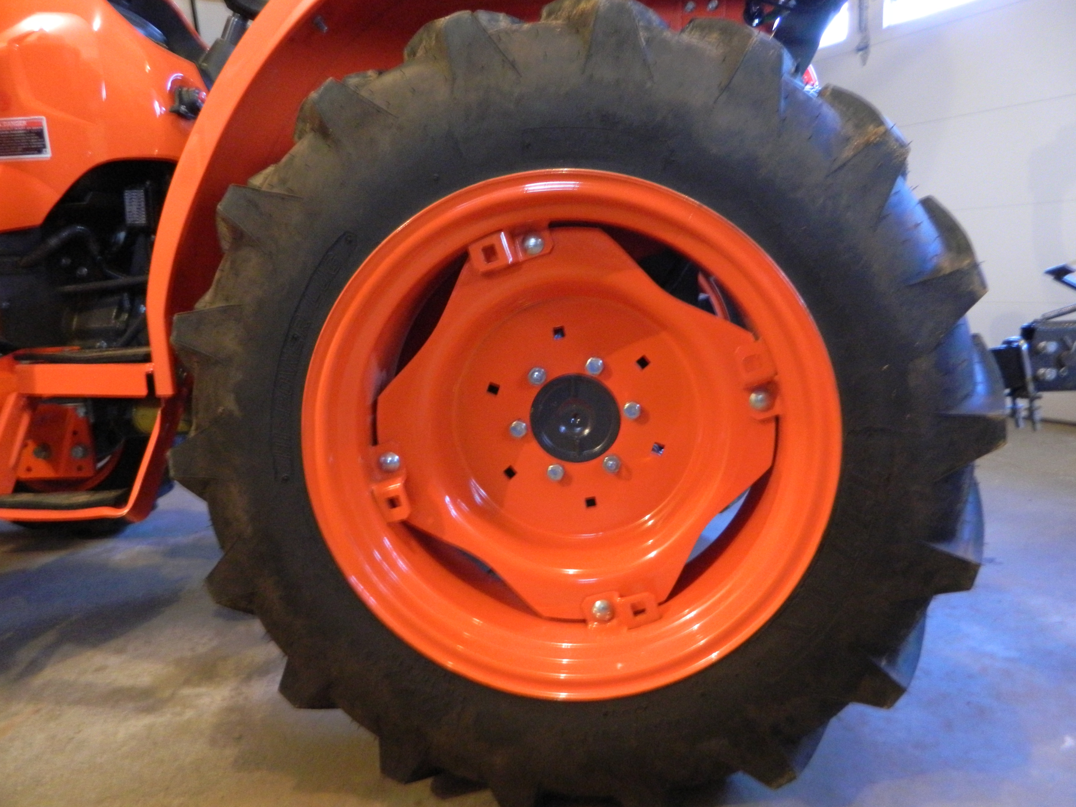

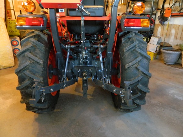

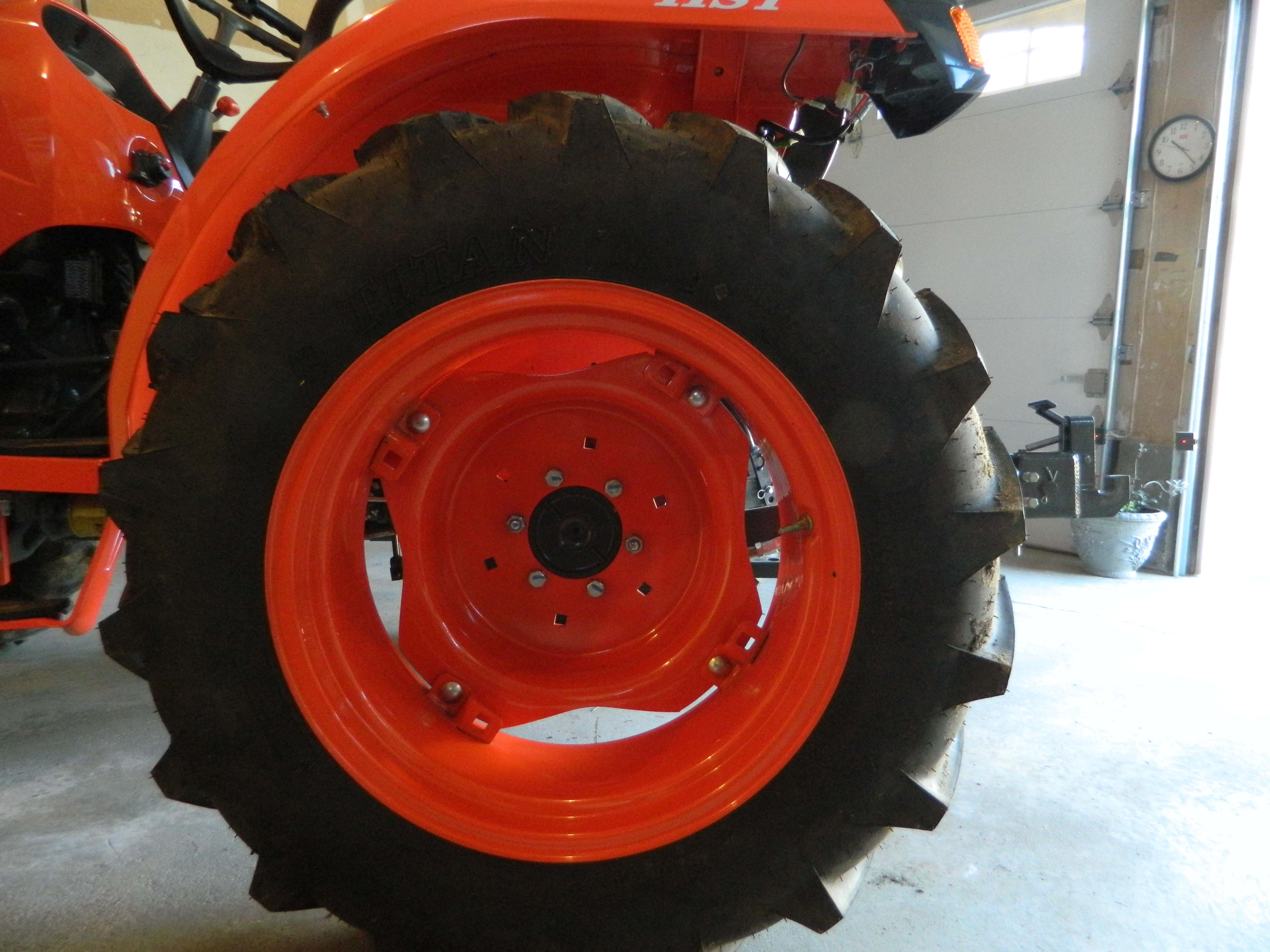

I though my L3400 had a pretty generous amount of wheel spacing options on the rear.
Hub can be mounted dish in or out thats two options.
Rim can be mounted two different ways on the hub
And the tabs on the rims are offset, so you can swap sides and get two more options.
2x2x2 = 8 different ways to mount. I think as narrow as 50" or so....out to 63" or so wide.

1) The L3400 user on my farm added 6" spacers on both sides (over $700) because the wheels would not go out far enough for reasonable use on steep ground. If they only go out to 63" as you say that is NOT very wide. NOT comparable to Deere or Massey in the same size machine. NOT comfortable bush hogging on steep slopes. I call anything over 40% fairly steep and anything over 50% I stay off it regardless of machine.
2) Smaller Kubotas and virtually all of them prior to 2000 were notorious for failure to have enough rear wheel spacing for use on very steep ground. The entire industry knows it as did most customers. It was widely known, accepted, assumed. Not a fresh discovery. Just a fact. People either cope with it or buy something else. Kubota sold well & gained a tough reputation in spite of it.
3) In recent times (since 2000 generally) the larger models of Kubota have offered better, more nearly competitive rear wheel spacing. Still NOT as much as Deere or Massey but probably adequate for almost everyone.
4) The 8 different combos of mounting you listed are the right ones for any normal utility tractor in medium size and above. However if the thing was too narrow to start with that still may not get out to comfortable widths. And many of the smaller Kubotas have no such options. Take a look at any Deere or Massey in the mid utility size range. They go much further out.
