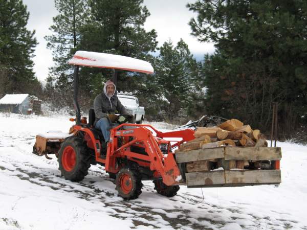

Here is the Factory Shade that my dealer installed prior to delivery for a cost of $400 I think. I mounted lights using holes already in the shade frame.

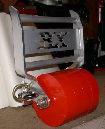

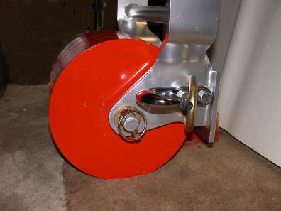

Fran3, I also wanted a front weight system, but I wanted to keep the grill guard on, and I did not want to spend what they want for suitcaes weights. The way I did it you can use any barbell weights, I used the old wheel weights I made for the last tractor. 4 plates 10" dia X 2-1/4" thick about 50 lbs. each.
   / Kubota OEM Front Weight Bracket #14
Without the tow hooks you could continue stacking weights on the outside of the grill guard also.

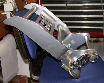

Now I will have to work on a fixture to put on the floor jack to install the weights when the grill guard is installed. This was a easy mod from 3/8" x 4" flat bar. Good luck maybe this will work for you.

Tom, here is a quick sketch and I think at 100% size it should print to scale. The bar that holds the weights is 1" dia. solid. I made the bracket so a 10" dia. weight just clears the grill guard mounting bolts.
