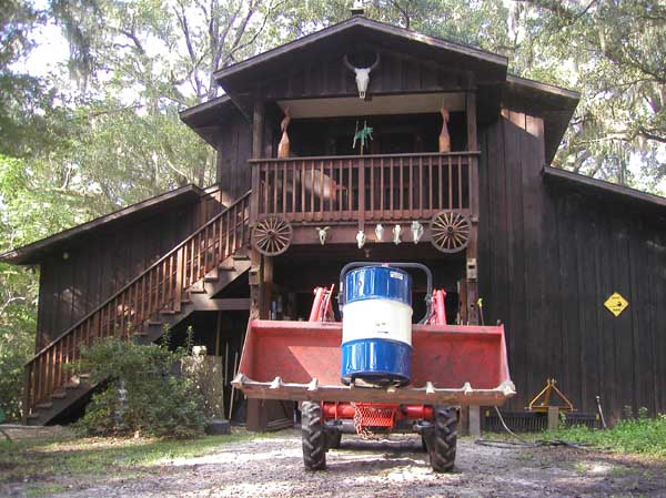

Amsoil Synthetic Hydraulic Fluid (ATH) or Chevron Synthetic Hydraulic fluid (THF) or PetroCanada Synthetic Hydraulic Fluid (DURATRAN).
   / Kubota oil vs. off the shelf brands #16
The utilization of any of these synthetic hydraulic fluids really makes for some smooth operation of the FEl, BH, GST, and HST! :D
