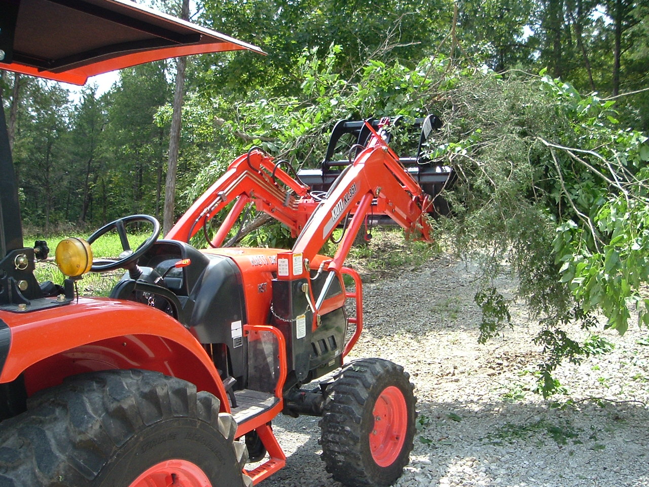

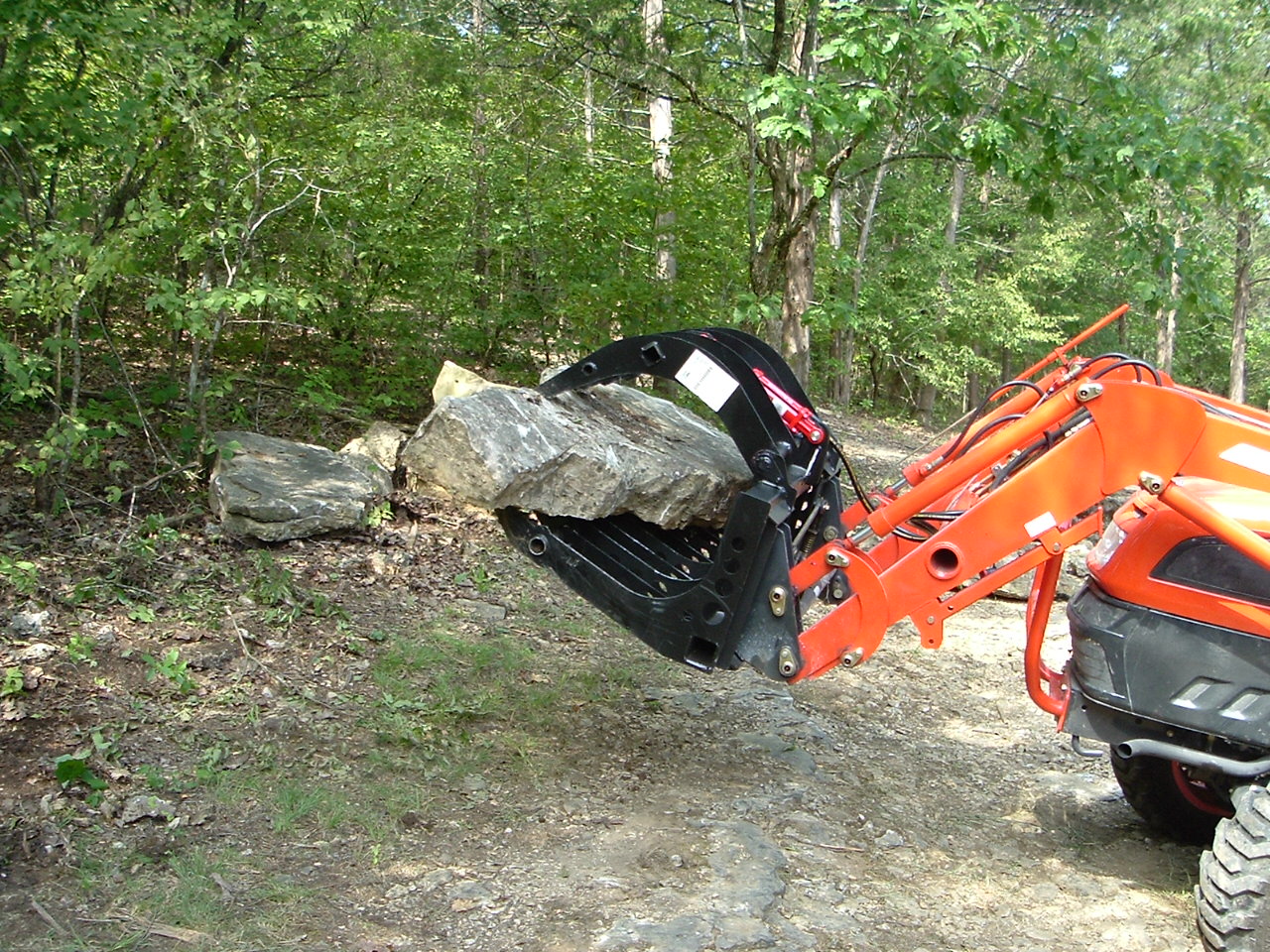

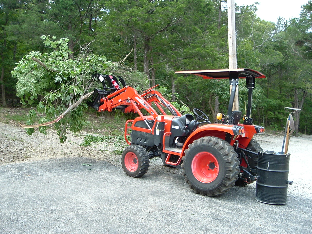

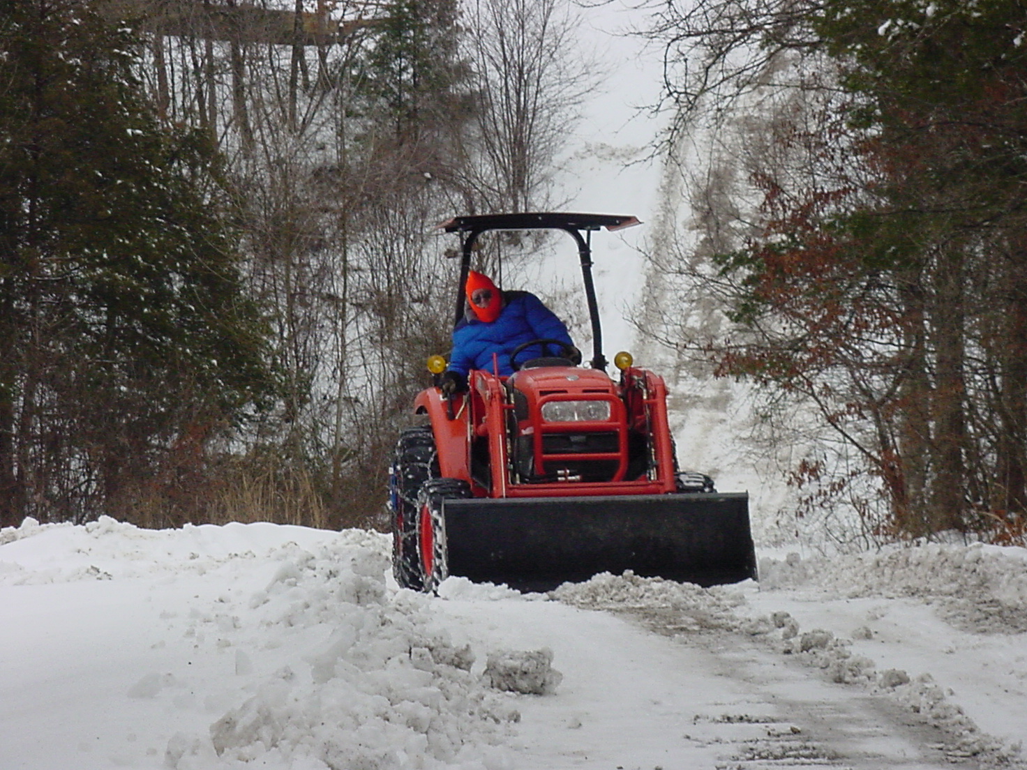

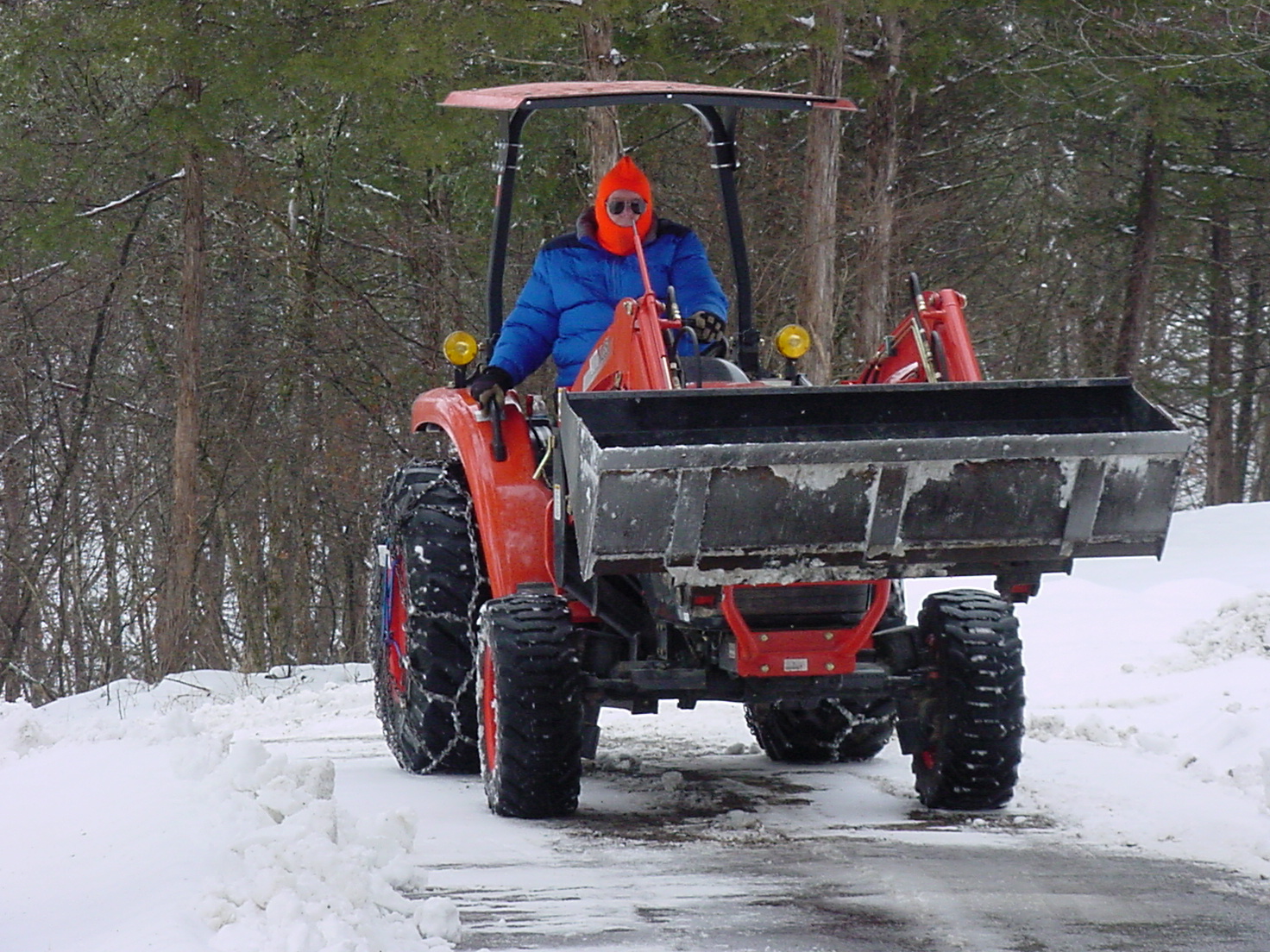

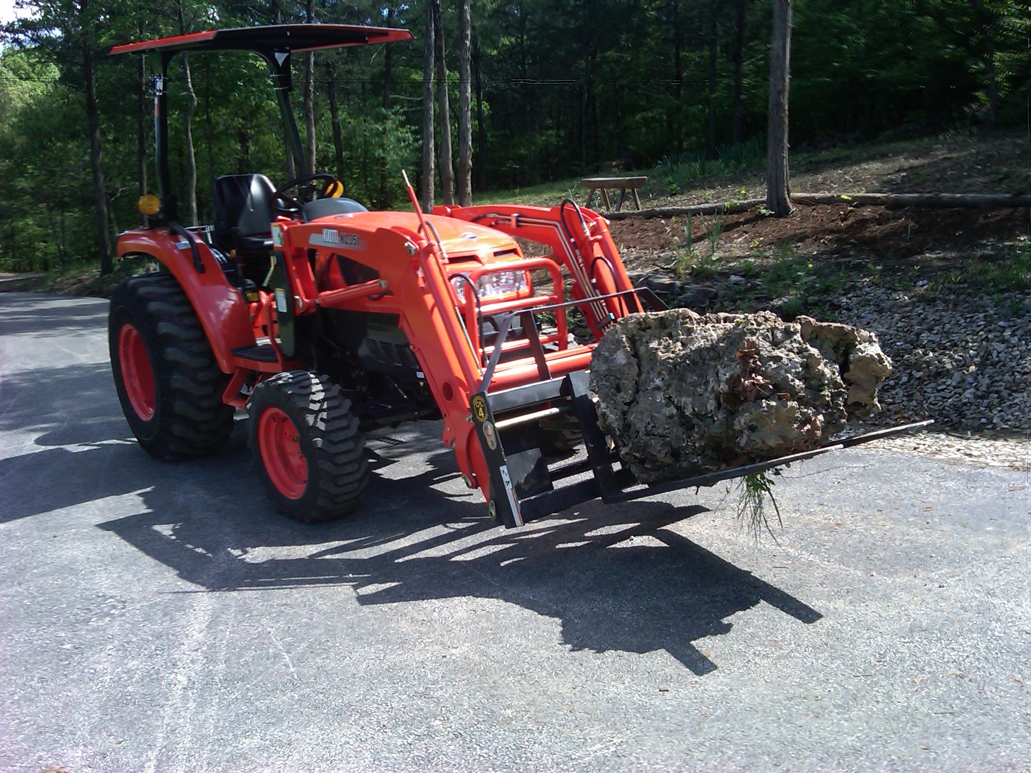

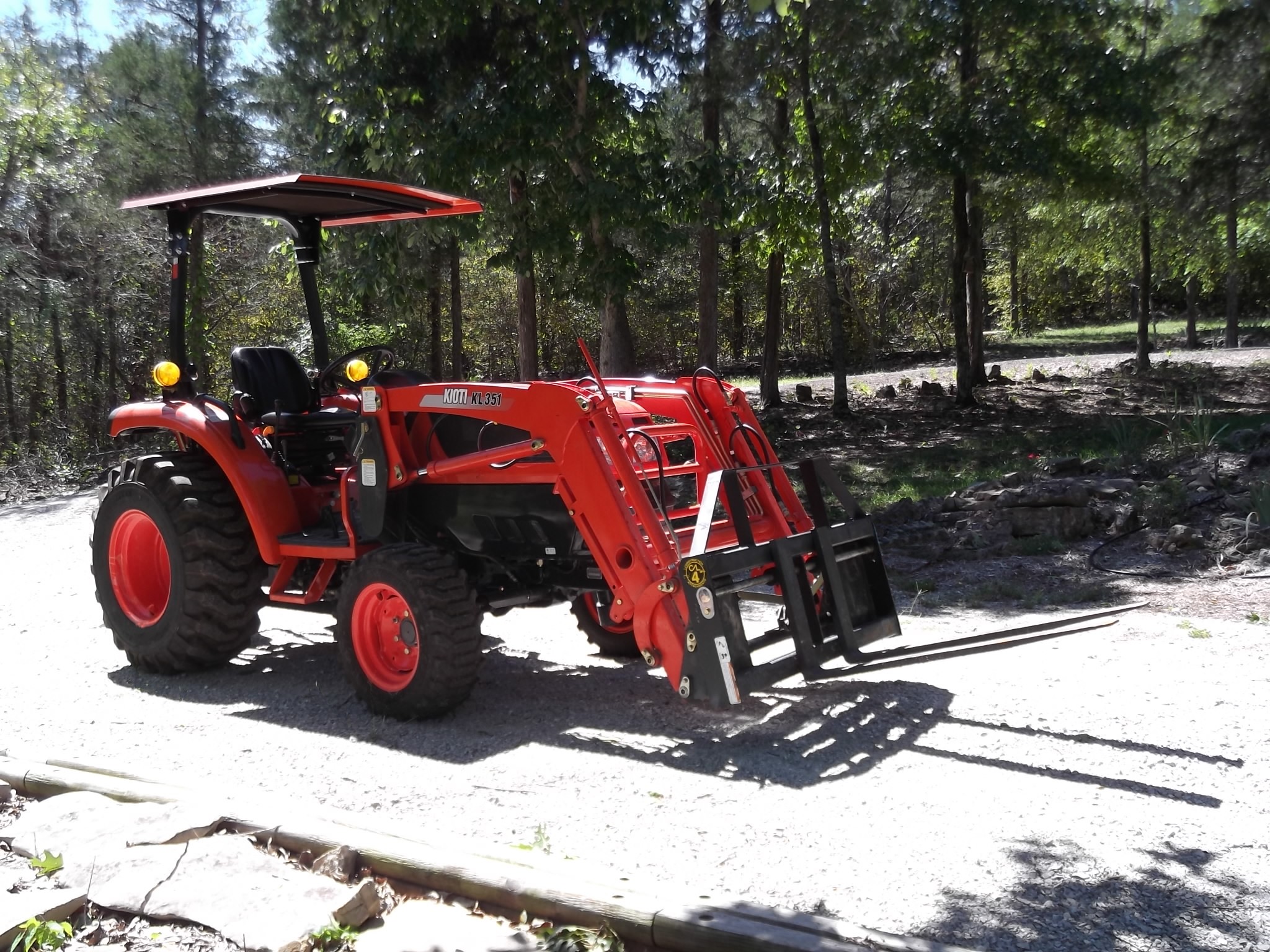

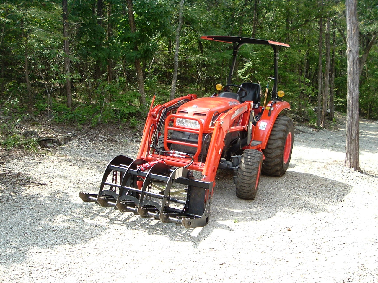

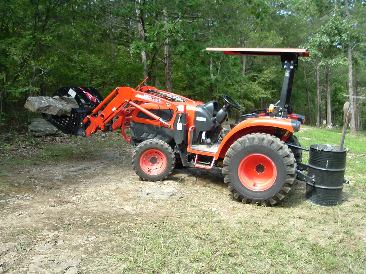

I have owned 2 Kubota's and 1 Kioti. I presently have the Kioti DK35se. With loaded tires, Loader and home made rear ballast. I have a grapple, and pallet forks, and two buckets. I am not going to go down the Kubota/Kioti , who is best road, as they are both good. Pick the one you like the best and which one your wallet likes the best. I believe my tractor would do all that you may need to do. With my ballast on the back. I am around 6000 lbs. More weight means more push, pull and "grunt" in dirt work. I don't know about pond work, unless it is really dried up. Keep tractors away from water.:D
Some of the reasons I prefer my tractor is because of heavy construction, more weight than some, and many deluxe features. If you can afford a grapple, like is on the front of mine in the avatar photo, get it. They are great to move logs, brush, and stones. A couple of other good brands to consider is Mahindra, and LS. As for working a tractor in the creek, just make sure it has a rock bottom and not a mud bottom.. I have worked tractors in creeks, and if the bottom is rock, it is OK, and the water is not too deep, but if the bottom is mud.. look out. Good luck in your search.
DSC00013.JPGDSC00011.JPGDSCF0555.JPGDSCF0554.JPGDSCF0550.JPGDSCF0548.JPGDSCF0547.JPGDSCF0551.JPG090812 007.jpgBranson-20120417-00027.jpg

Photo #1: Nice to know what you look like, James.
Did you get the Balacava as a 'freebie' at time of purchase?
/ Kubota or Kioti - Which Model #8
That is not a very flattering photo is it? I was pretty darn cold after a couple of hours on that open station machine.

Oh, all right, I will post my photo too.
