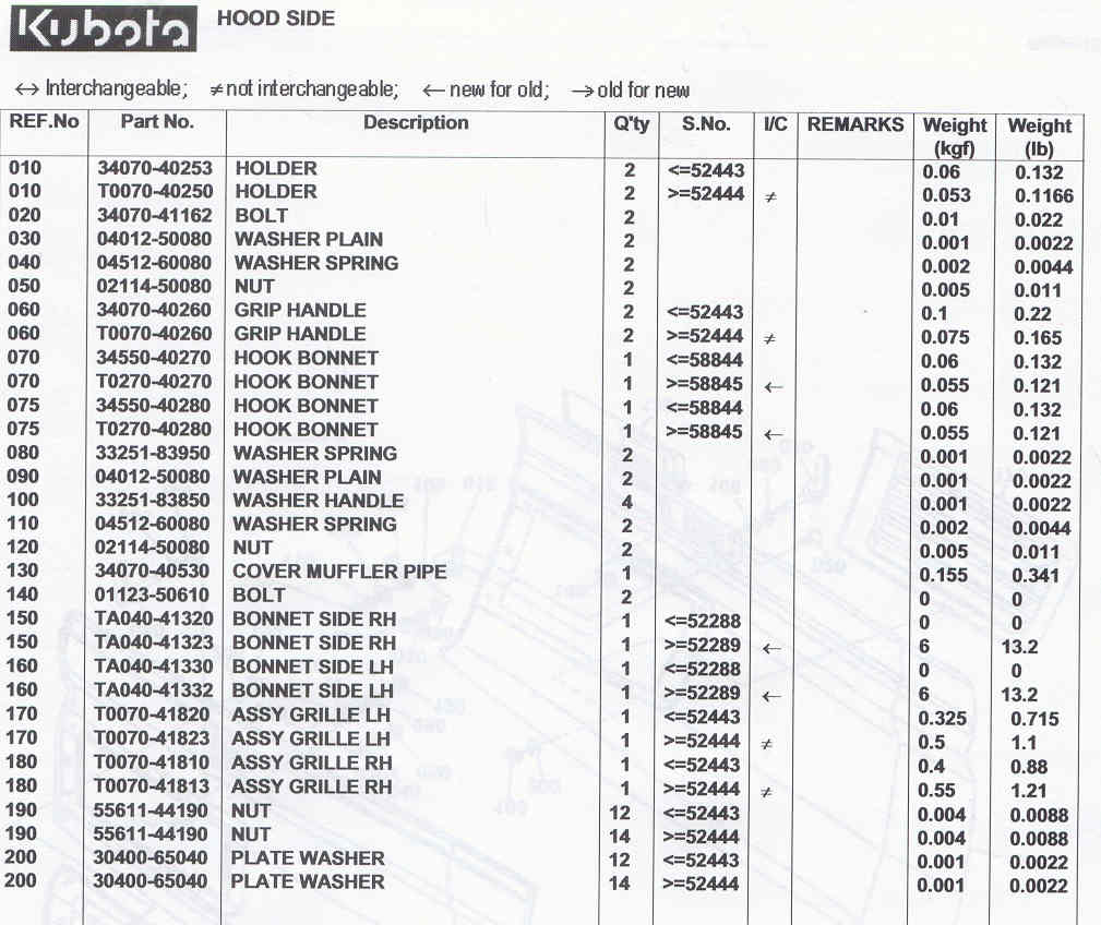

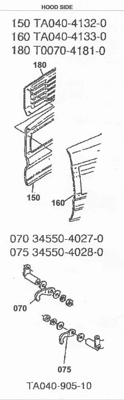

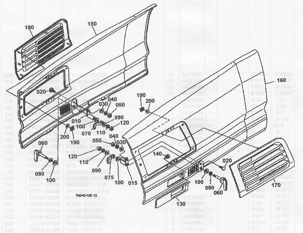

On a slightly different note, this si the first tractor I have had. As such, I'm not real sure how these side panels attach. Could someone explain or maybe post a couple pics? I'd greatly apprcieate it.
Thanks again and have a great week.
Mike
   / Kubota Part Number Cross Reference/Engine Panel Help #7
... I'm not real sure how these side panels attach. Could someone explain
Mike
Mike...The Top of each panel is folded over like an upside down U ...
It hangs in the troff on the edge of the top piece...
Then is held in place by handle clamp on the bottom. I'll attach a parts breakdown that shows this better...
KennyV
