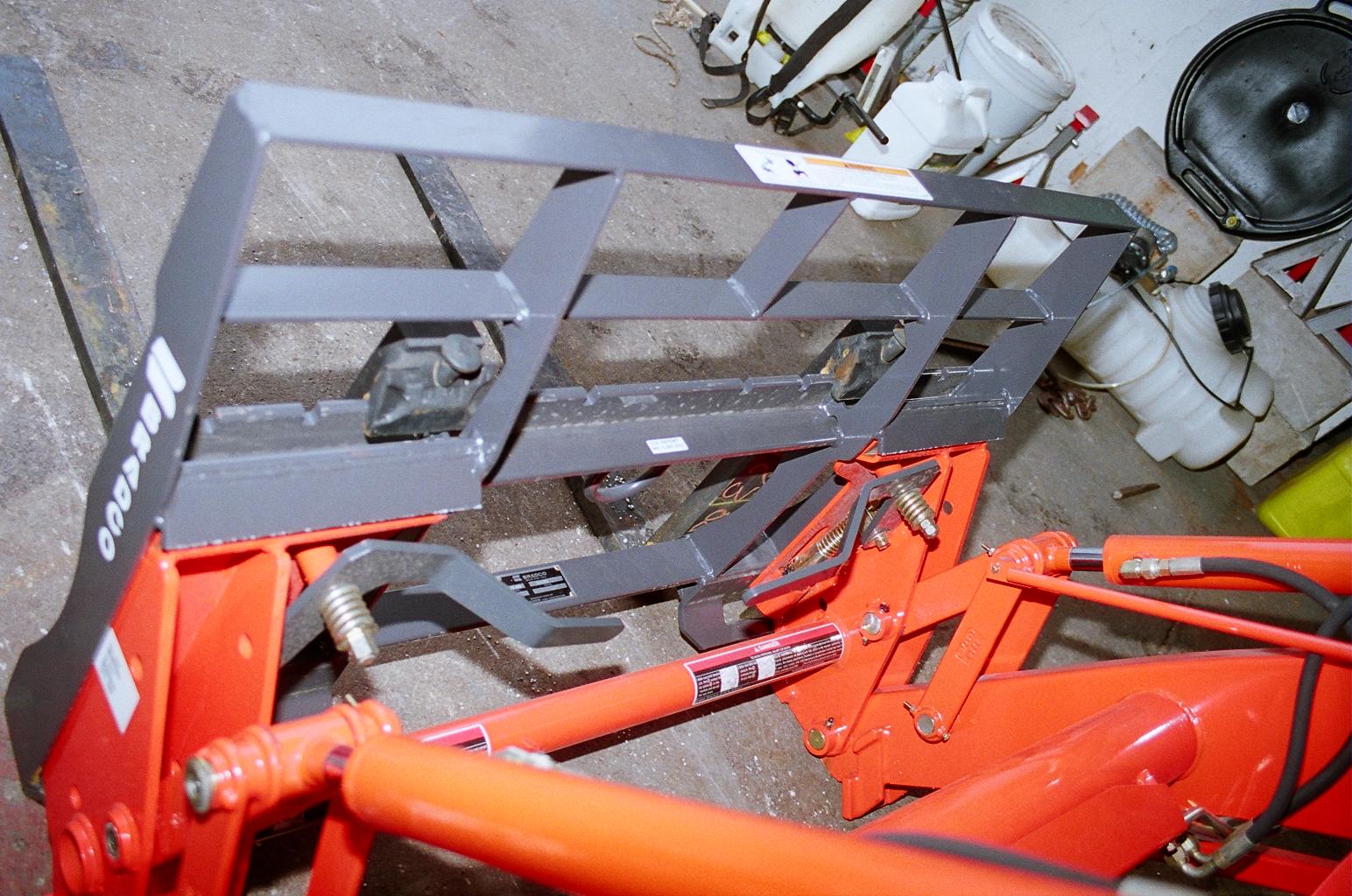

New QA forks on my 3540.

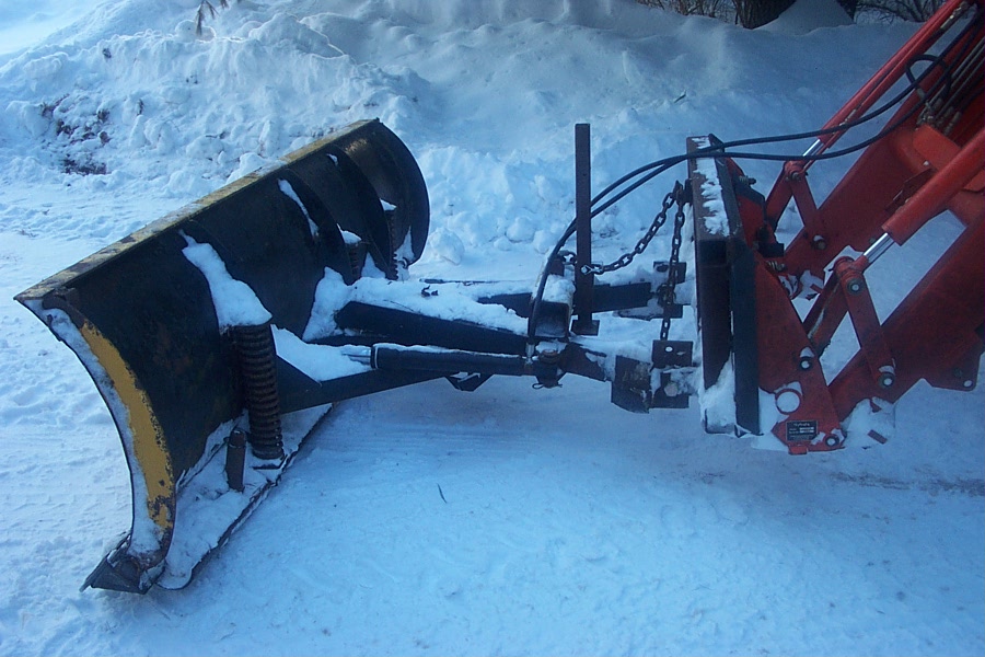

I would have to say that you do not know your L 40 very well then. I had a 7'6" on my L3830 for 5 years with no problems.

Those pictures are plows, not pushers. Im fine with plows, box blades or pushers is another story.
