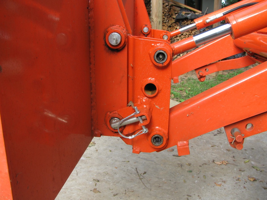

I've been searching trying to find the answer to this question. I've seen it asked several times but never really answered directly.
I have a B3200 and I'd like to add a Kubota quick attach, not a SSQA (which is where most conversations go when this question is answered). If I add the Kubota QA, can I still use my regular pin on Kubota bucket or do I have to buy a different bucket to match the Kubota QA?
I really don't have a need for grapples, etc and I'm trying to avoid the extra wt and loss of lifting capacity with the ssqa. I'm probably only going to be using a bucket and forks.
Thanks in advance for any experience in the matter,
Tom
   / Kubota quick attach question #2
You remove your bucket, put on the quick attach then re-attach your bucket. The top two pins stay with the bucket, the bottom two you put in/remove when you change attachments.
So yes, you use the standard Kubota attachments with that quick attach.
   / Kubota quick attach question #3
I just bought one. My tractor is in the shop so not installed yet. Looks real simple and yes the regular bucket still works. It appears to move the connection out about 3" so some weight capacity will be lost but not near as much as the SSQA. I am looking forward to making other attachments to use the system.
