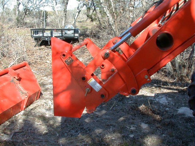

I am working with a friend to make an implement to attach to a FEL with a quick coupler. I called a local Kubota dealer to ask about purchasing the quick attach brackets to weld on the new implement and they stated these could not be purchased from Kubota and I would need to fabricate the parts. He didn't sound very sure and I am not sure that he understood exactly what I was asking. Does anyone know if the brackets are available from Kubota?

I just bought a set for a FEL LA1251A(on a M9000), part # was M1295.

Here in Canada, all the M series above the MX5000 come with a Kubota badged ALO Quicke loader that uses a euro style tool carrier quick attach. You can buy the bucket side plates from Kubota or through the loader manufacturer. I don't think they carry bucket sides for the skid steer Q/A's though. I think you have to go to a bobcat dealer or the such for that.
Someone just posted a few days ago about a place online that sells them for 100$.

I attached a pic of a bracket on the tractor if you are interested. When I bought mine I had no idea what they would look like. They are very nice. I didn't like the price. /forums/images/graemlins/frown.gif
I don't think Kubota does a good job of making info available about what is available for the tractor.
