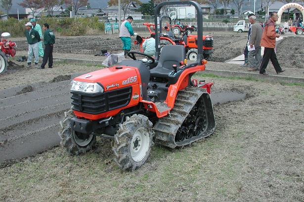

In some cases this may be done because there are narrow and standard width versions of the same tractor.
I don't know, but perhaps when a narrow version is produced, they then only have to install shorter axles rather than produce two different housings...
My B2910 has about six or more inches of axle protruding beyond the axle housing...
There are also rear track assemblies that bold onto the rear axle housing in Japan that are used in place of rear wheels. Maybe this has something to do with the design also?
Attached is a photo of a small tractor with tracts installed (15 hp) but I have seen them on larger tractors as well...

Henro, that may very well be why it's designed as it is and one less style of casing to stock - neat pic of the Bota' w/ tracks !

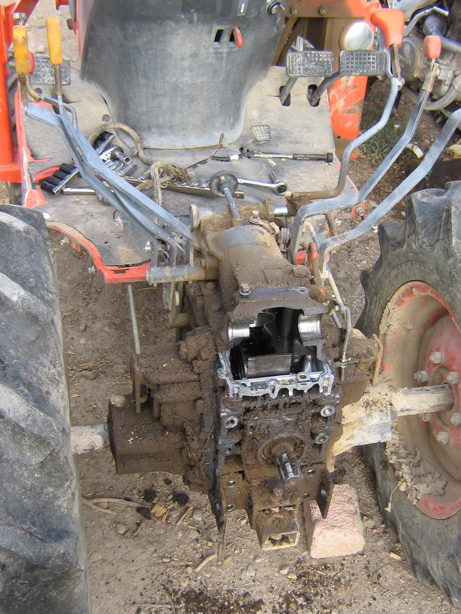

With the idea that bending an axle would fracture an imaginary extension to the casing ... what do you experienced folks say about this situation? My 17hp Kubota managed to (over-)load it's 3 point system to such an extent that it now has a ruined [fractured in two] hydraulic cylinder case and a badly damaged top rear edge on the differential case; the edge damage is a consequence of the hydraulic cylinder case getting ripped off of the tractor.
Looking at the damage causes me to wish the tractor had been designed so that an (over-)load would break the lift arms rather than allowing them to transfer the (over-)load to their shaft which then fractured the hydraulic cylinder case.
The tractor did not overload the 3-point, the operator did.

Were you using a logging winch or 3 point backhoe? Common damage from that type of use on compacts.
Re the axle length, my 5030 doesn't stick out far beyond the casting. Take a look at ag tractors with axle mounted duals, they have about 3 feet of axle sticking out beyond the casting face.
