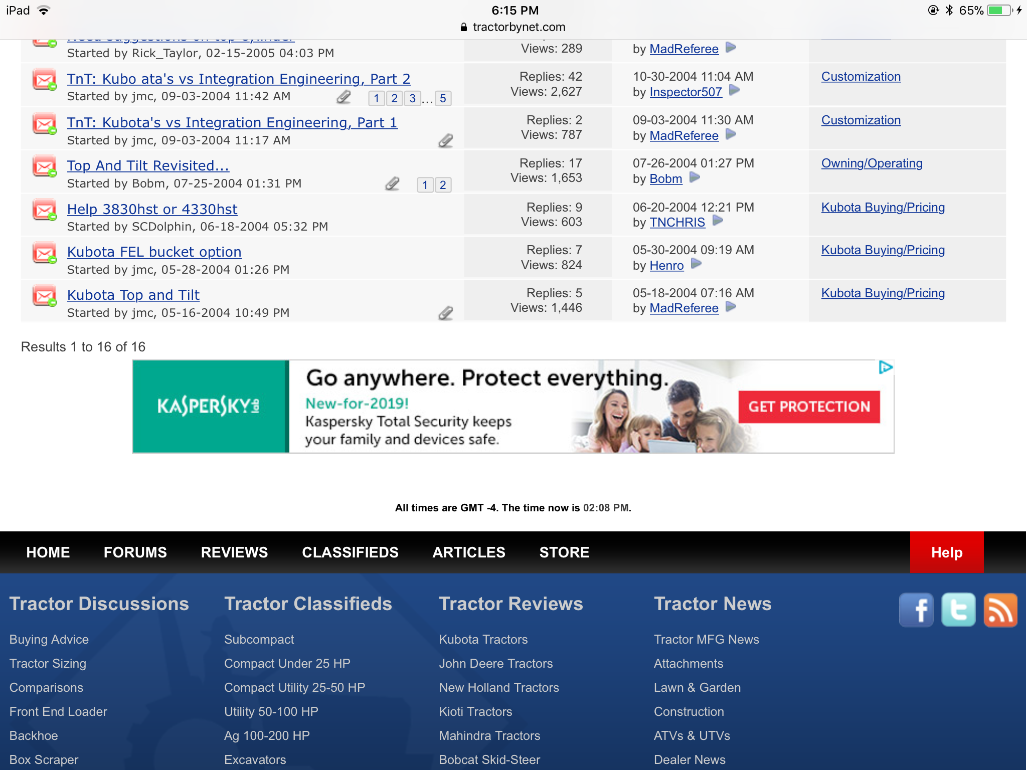

I ordered 3 Kubota installed rear valves (Without detents) in addition to Kubota's top and tilt components, along with my L4330. This was back in 2004 so things might be different now. There was no external leakage on any of those components. Both cylinders did leak down- no big problem on the top cylinder but too fast on the side cylinder for bush hogging.
I posted about changing those Kubota cylinders out for another brand with piloted valves. Below is a screen shot of a TBN search for parts one and two of the discussion, if you want to look them up:
