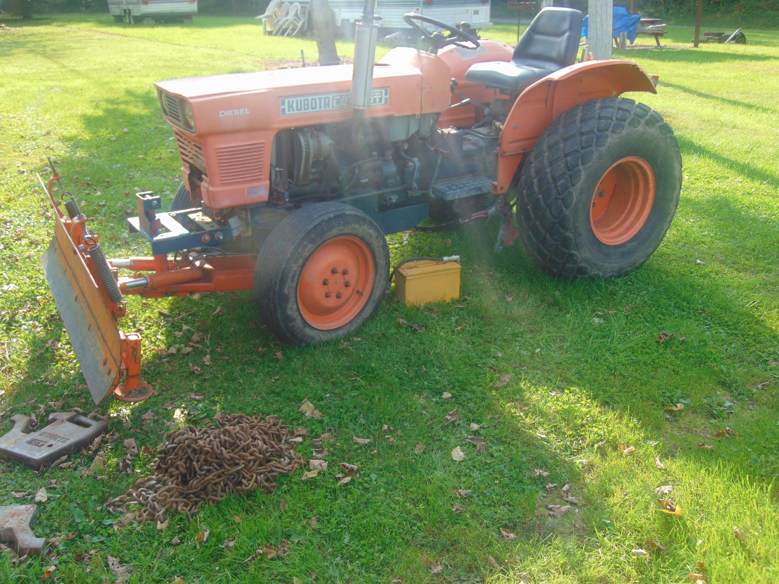

Certainly something to be said for that kind of simplicity Jimbo... unfortunately it is proven that the new systems produce less pollutants so we must all comply or buy pre-emissions tractors. I've had 2 older machines over the last 25 yrs or so.
Lots of them out there yet. For one I like the older better built models. I like the gear drives better than hydros. I have a hydro Bolens and it's an 1987 and no emmissions either.

I've never seen a pre-emissions tractor that burned diesel but didn't smell like it burned diesel. That one is a real keeper.

One of the biggest problems with emmissions is they need a computer to work with all the sensors. I own a 1980 vette, last year before a computer, and no sensors. I own a 1987 Bolens tractor, no computer, no sensors. I own the Kubota, no computer, no sensors. When yours starts going bad and have to take it to a dealer to fix you'll notice the difference. Mine are all simply to fix.
