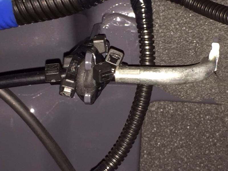

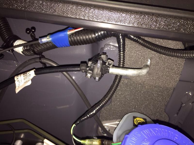

Hey guys I was at my dealer the other day and he showed me about a service bulletin on the new Rtv X 1100 and the other rtv x series. The pressure relief valve cable that when you press on the break comes through the firewall is suppose to relieve the pressure on the servo valve and make it easier to shift.
Problem is the cable is held in place with a grommet and nothing else if you look at the attached picture you can see the fix is to tyrap the grommet in place and take the slack out of the cable so it is not mis adjusted from falling out of the grommet and is stiff enough to work the cable and servo pressure relief valve.
I did this to mine and it all but fixed my problems so take a look and hope this helps. Oh this is under the hood of the rtv

Thanks for the info. Appreciate the reply and the pics. Makes it much easier to isolate the issue.
