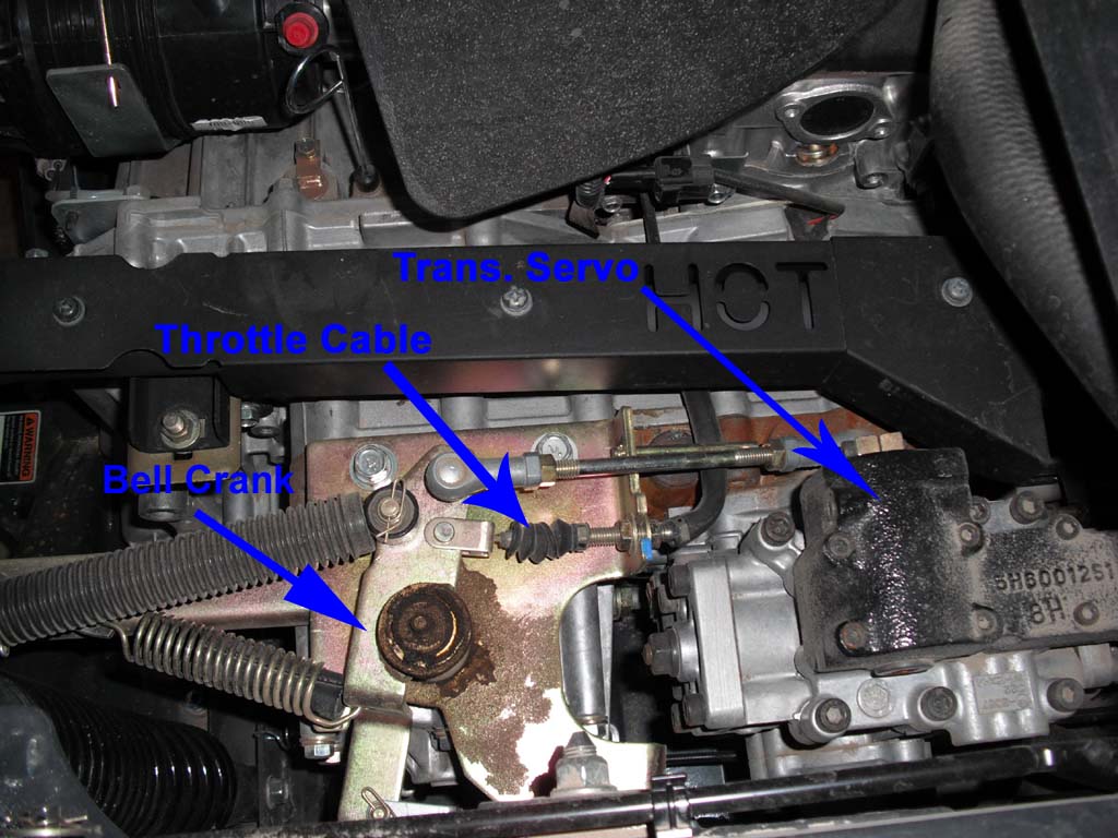

Timswi, I will have to check this weekend and let you know. My initial thought is that there should be a little free play to insure that the valve gets to the neutral position when you take you foot off the peddle.
   / Kubota RTV 500/610 mule Opinions #25
Stonehaller, I have about 1/4 of gas pedal before the linkage moves at the servo, is that the same as yours?
Timswi,
There is no free play between the peddle and the trans. servo on my RTV500. The bell crank and linkage to the servo move immediately when I touch the peddle. There is free play in the throttle cable that goes from the bell crank to the engine.
The free play on yours may not be an issue as long as there is enough travel to full actuate the transmission servo. Have someone hold the peddle to the floor and then see if you can move the bell crank any further by hand. You may have to disconnect the throttle cable from the bell crank when you check this to make sure that that is not limiting the travel. If you can push it further by hand, then you should adjust the cable from the peddle to reduce the free play or adjust the stop on the peddle to give you a little more travel. Leave a little bit of travel to go in the servo valve so that the bolt under the peddle is the stop in the system, not the servo valve.

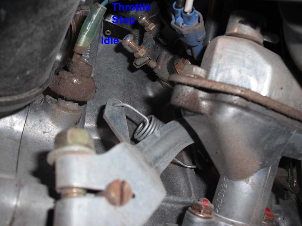

After adjusting the peddle cable and servo valve travel, you will probably have to adjust your throttle cable so that it hits the stop when the peddle is fully depressed. I see that there is also an adjustment on the governor linkage for maximum travel of the throttle cable. This adjust may be part of your problem with low power. There is an idle speed adjustment screw and a maximum engine speed adjustment screw buried under the throttle body. I labeled the maximum speed adjustment Throttle Stop in the attached picture. You could back out this screw a little before you adjust your throttle cable. This will raise the max speed that the governor regulates and potentially give you more power.
Remember the balancing act. When the peddle hits the stop, the servo valve should be at full travel, and the throttle should be at full travel.

Thanks Stonehaller...That was a very detailed explaination, and I will definitley look at all of your suggestions.
I did take a little of the slack out of the throttle cable so that there is about 1" of pedal travel before it engages. Before, the trottle cable didn't engage until 1/4 thottle was pressed. This really didn't do anything in terms of power. Might have a slightly higher to speed. Not noticable really.

You do not actually have to disconnect the throttle cable. There are two nuts on either side of the bracket. Just loosen those so the cable housing can slide back and forth enough to ensure that it is not restricting the bell crank when you push it by hand to find the full travel stop of the servo valve.
