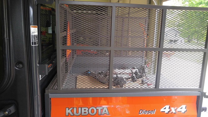

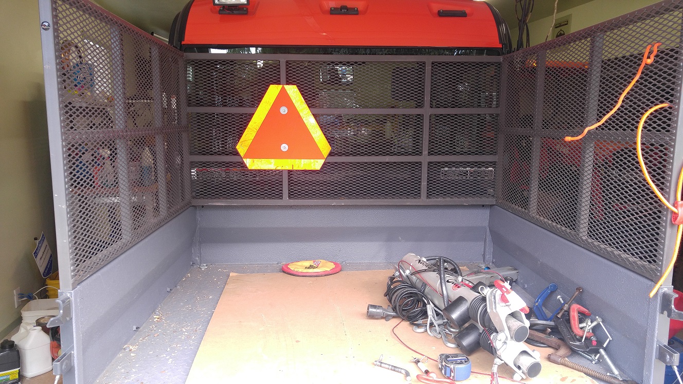

If you can get a secure, solid mount for a screen onto that front of the bed, it would be superior to a mount just covering the back window of the cab. As it is on my RTV1100, material can fall into the crack between the front of the box and the cab screen and build up on the engine. A screen on the front of the box would minimize this issue.
Yep. That was a primary concern for me when I built my rack. I wanted solid protection at the front of the bed to prevent material spilling onto the engine. I haul a lot of loose dirt and gravel.
   / Kubota RTV protection screen #12
Thought I had posted a pic with the bed empty but hadn't. Here's one showing the solid front.

I originally had the Kubota rear window protector on but I kept getting branches caught under it. So a few years ago I built this to increase hauling capacity while protecting the rear cab window. I can hang my yard tools etc.. on the sides.

From my perspective, maybe the best thing about your modification is that it keeps crap from falling down between the cab and the front of the bed and building up on the engine (I shovel a lot of manure and horse bedding into my RTV1100... both materials are flammable when dry).
   / Kubota RTV protection screen #17
That is the reason I built mine like I did. Minimize material dumping onto the engine. The first time I loaded my RTV I realized that wasn't going to be acceptable in my world. :(
