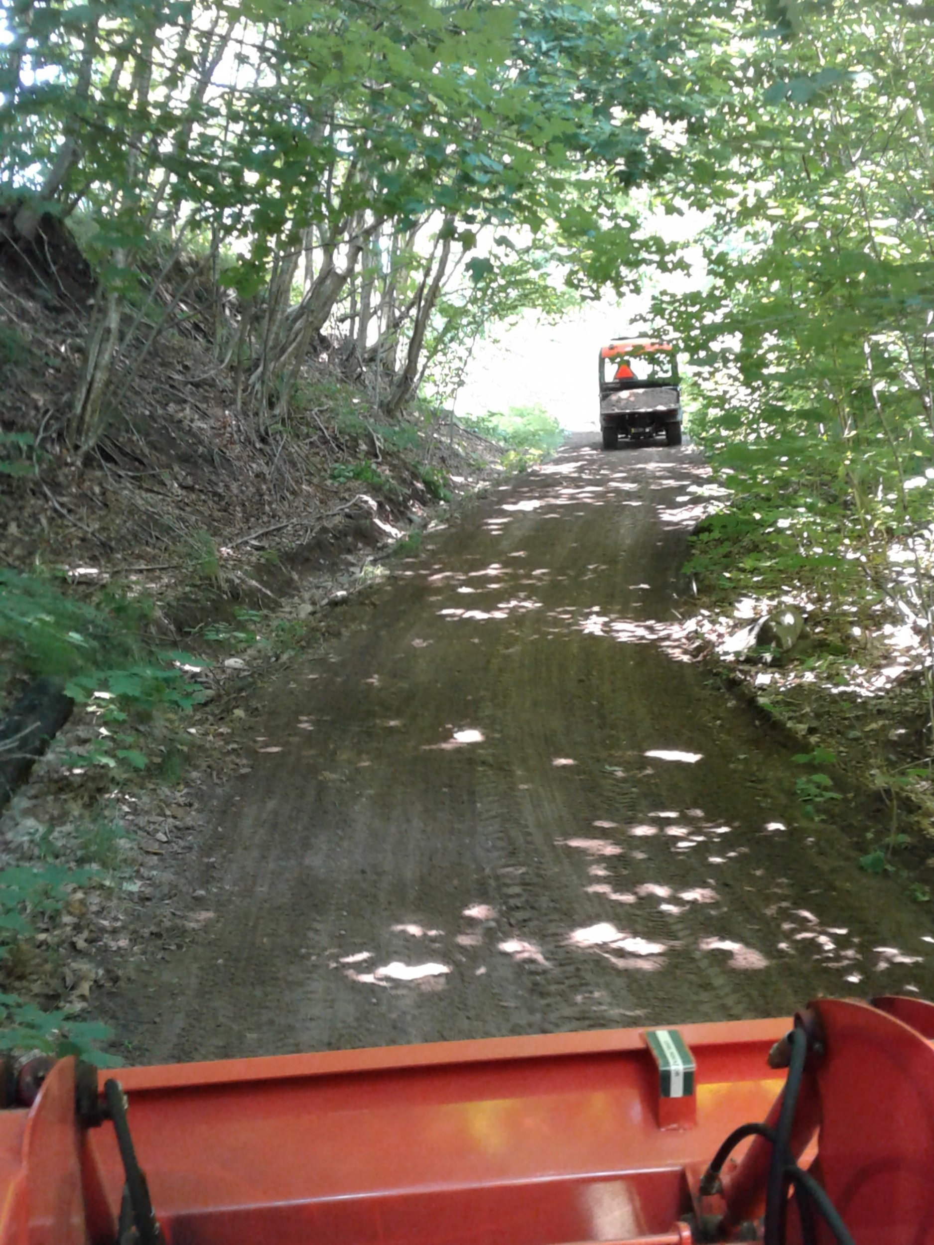

I seem to be pretty lucky with mine, or my dealer setup. Like I said, I can get up to 26 on flat roads and I can climb my hills with two bucket loads of dirt from my B2620 in the box at 9/10 MPH.
Hard to really tell the grade in pic but it is pretty steep.
