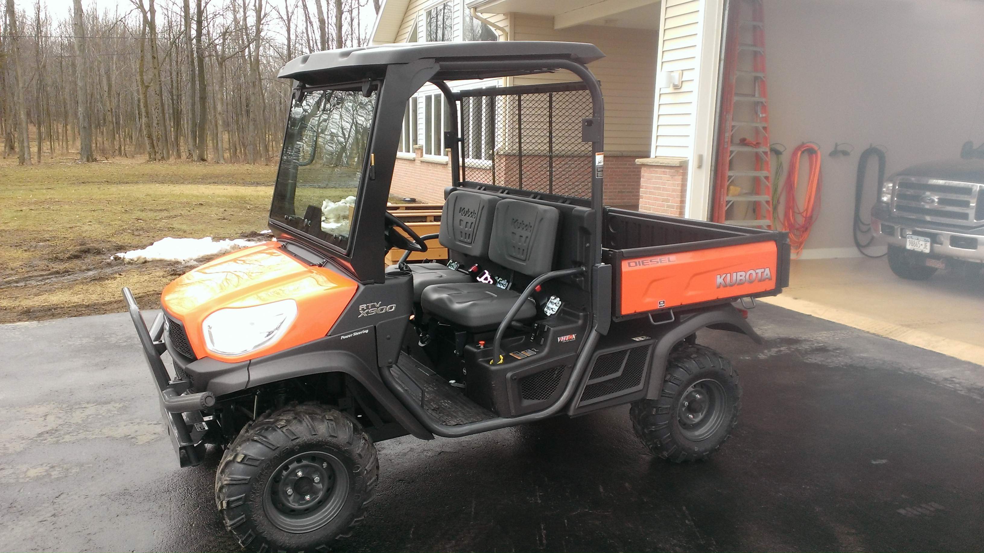

2014 RTV-X900 Worksite Orange & ATV Tires delivered last week.
Initial observations after a few hours and miles
  • Shifter is extremely hard to move between L H N R. Takes a lot of muscle to move it. This might have been a deal breaker when researching competition.
  • Shifter can become stuck in reverse when stopping on incline. Engine won't restart if stuck in reverse, needed another piece of equipment to take pressure off reverse linkages before shifter would move and restart engine.
  • Dump bed must be raised to check oil, therefore starting engine before checking oil.
  • Factory supplied battery is very small, doubt it would have enough power to heat glow plugs and still start motor in freezing weather.
  • Engine seems to labor and slow down on inclines, let off & full on gas and resumes original speed.
  • Seating is comfortable.
  • H & L ranges are appropriate for most use. Not fast, but strong.
  • Good storage under both seats. Glove box with door. Good instrument panel.
  • After 10 years of making this machine, I'm surprised on some of the obvious negatives, especially the shifter resistance.
  • $15,000 got me a RTV-X900-W-A, factory sprayed on bed liner, Plastic bed insert (V5229), Glass (VC5025) (not poly) wind shield, Hard (VC5011) (plastic) roof & delivery.

Mine shifted hard just as you described and would stick on an incline. My dealer came out and adjusted the relief valve which is right on the back of the machine right under the tailgate. Made a huge difference. It wasnt pushing the valve in far enough.
