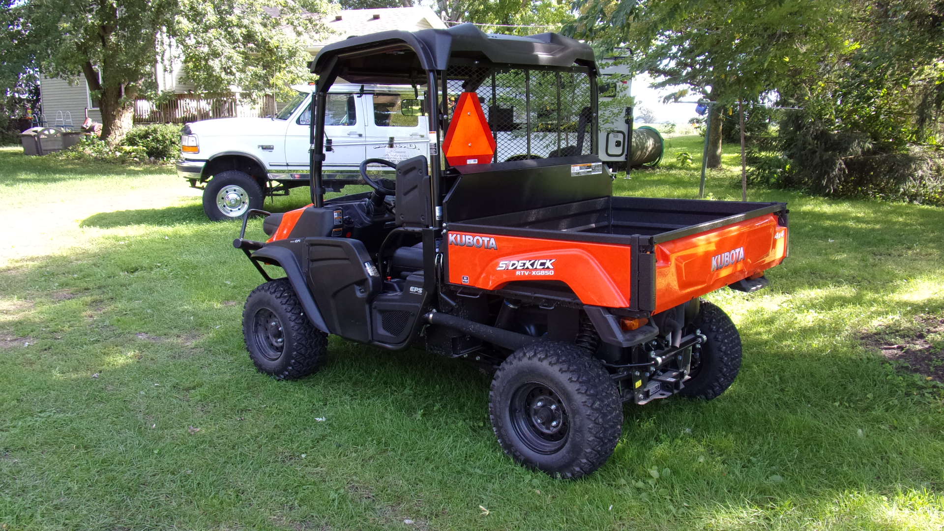

Sure has, you mean my wife's Sidekick, not mine. She bought it, I was happy with the Honda quad but alas, the quad is sold so I'll just have to get used to this... It scoots too.....
In process of installing a 5000 pound winch and I'll have to fab up a mount for my sprayer too...

I want one. What's going on in the back where the hitch is located? Looks like there isn't much ground clearance there?

Correct but enough. Been using the back receiver. I just flip the drop shank hitch over. Really prefer it low when pulling the big drag mat anyway and it pulls well. Used to use my Honda Foreman 400 and the drag worked it pretty hard. The Sidekick pulls it like it isn't back there. Very impressed. Sold the Foreman 400 to a good friend with no guilt. It was well maintained and he got a good machine.
Still have not had to use 4wd or low range. Nice buggy. Bought it road legal with everything necessary, horn, turn signals, fold down windshield and inside mirror and of course a SMV triangle. We drive it up town to the diner for lunch all the time.
