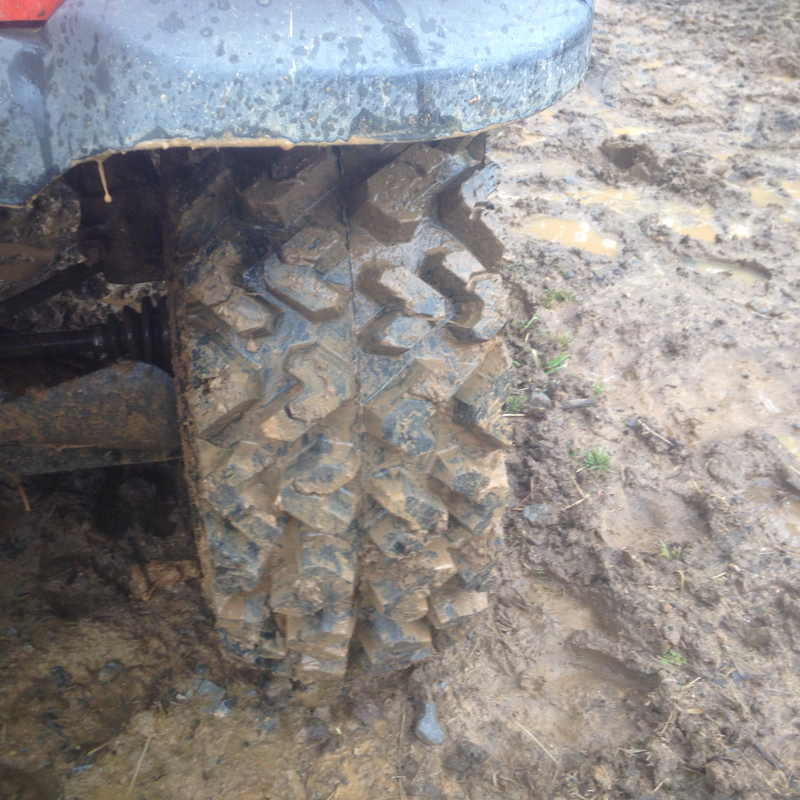

I paid $105 each for 26x9R12 fronts and $115 each for 26x11Rx12 rears. I wouldn't go that wide on the rear again.
Sedona Rip Saw R/T, 6 ply radial, 1 1/8" deep lugs.
Bought from Smith Family Power Sports on Amazon. Had them in three days.

Figure from $60 to $250 a tire depending on what you want. Around $100-130 is average and will give you a lot of options. Rip saws are good tires, Pit bulls are a top tire as well as many others. Mostly the stockers work decent everywhere but tailoring the tire to your conditions and use is the best way to go if possible.

- Tires are Carlyle USA made 25x10-12 knobby tires. Specs call for 20 psi, I put 16-17 in each of them.
