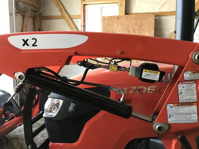

i have 'Soft Ride' on my Quicke (ALO) loader. i had to wait for it so got to use the machine for almost a year without it. Now having it, it is a nice feature. I road a lot into town. Even with the empty bucket/forks it helps with bounce.
Doing precise work is not easy with it 'on' as the loader is spongy feeling and will bounce a bit when you stop moving.
I'd likely get it again, but could live without it if I had to. it was a $1000 touch here in canada.
Does your accumulator setup have only one manual valve and a pressure tank? Do you have a part number on your reservoir? How do you discharge the reservoir?
   / Kubota "Shockless Ride", SoftDrive or equivalent accumulator? #22
yes, a manual shut off valve on the accumulator. I'm on the road for work till end of august so can't look but if you look on Quicke's website you should find the soft ride kit, maybe look in their manual section. There is no discharging the accumulator. The instructions say to lower the loader to the ground, shut off tractor, relieve hydraulic pressure then turn the valve (on or off). mine came from an AGCO dealer.

Nice feature. It is useful on washboard travel or at road speed even empty; anywhere that FELs tend to get bouncy. It takes about 75% of the bounce out.
That should reduce wear on the whole loader & hydraulics.
...maybe on the front axle pivots too.
JD calls their version "Comfort Ride". It engages/disengages when stopped via a dashboard solenoid switch. The solenoid switch makes it handy.
I'd get it again, especially at Kubota's add-on price. And I'd combine it with an aftermarket Grammer air ride suspension seat.

Maybe jumped in over my head. The KRS from Kubota for bigger tractors is interesting. Several KRS systems offered on eBay along with new and used accumulators. Watched an installation of one accumulator bulb system on a Massy look easy and made a noticeable difference. Something similar for the M59 would be nice.
Made offer on a LA1953 KRS kit. Slightly higher loader specs than my TL1350. I suspect this kit was NOS from an older loader model. Most people add this to a new tractor purchase.
The dealership took my $200 offer and should get it this week. It will not most likely bolt on my M59 but comes with accumulators, lots of lines, valve and brackets. I’ll have time handle the parts and to think about modifications and installation when the work load slows during the winter. To use one or two accumulator bulbs or if they are the same is an unanswered question.
Hopefully helps not only smooth loader carrying operation but with bush hogging and grading too.
   / Kubota "Shockless Ride", SoftDrive or equivalent accumulator? #28
Great deal! I'll be watching to see how it does on our M59s.
   / Kubota "Shockless Ride", SoftDrive or equivalent accumulator? #29
Got a big box of parts Kubota KRS kit for a LA1953, 2008 year manufacture.
The accumulators bulbs have different charge pressures. 290 and 580psi made by Bosch. Basically giving two different springs to cushion a broader range of weight. Lighter capacity loaders may get by with one accumulator.
The valve is two quarter turn valves mechanically linked manual valves.
Leaning toward using a N0 solenoid valve that I can operate without getting off the tractor.
