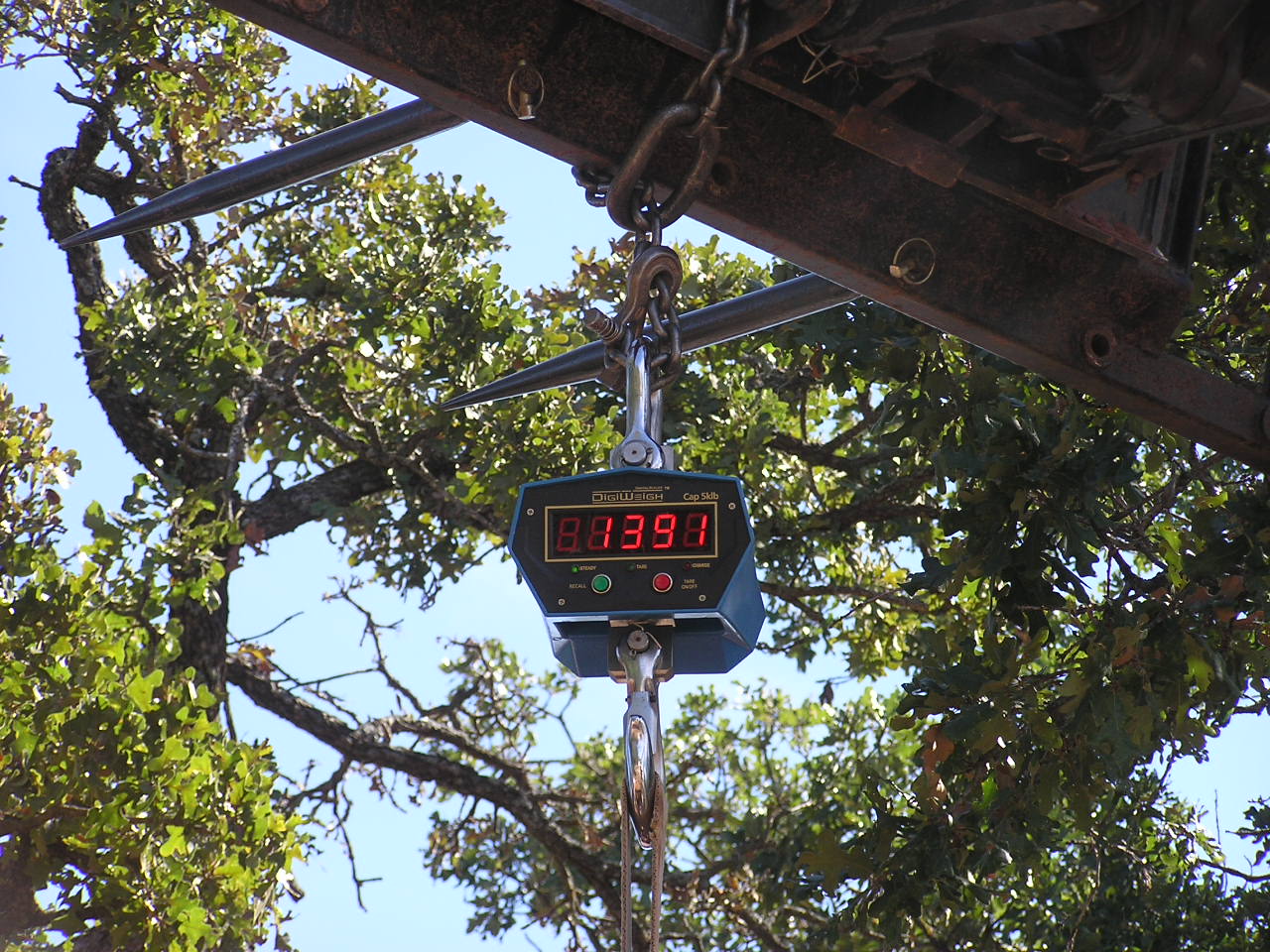

What size round bale?
I doubt that it would handle a 4x5 bale on a bucket spear. A new tractor should have a Quick Attach, remove the bucket, put on a bale spike and it might have a chance.

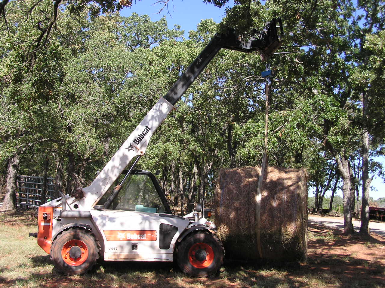

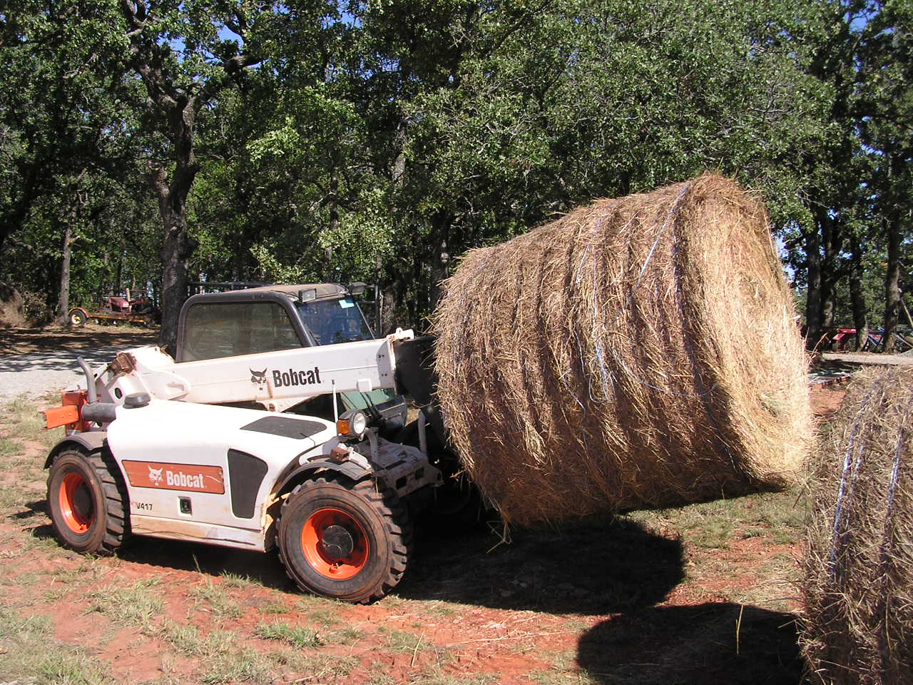

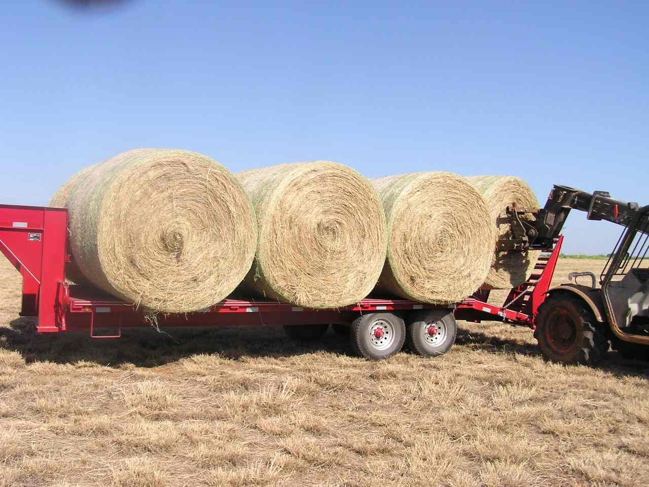

Had a Blue Stem hay field where we used to live, Took 8, 5x6 bales on this trailer across the scales at the Co-op, they averaged 1450 each.
This prairie grass bale, weighed 1391 pounds.
