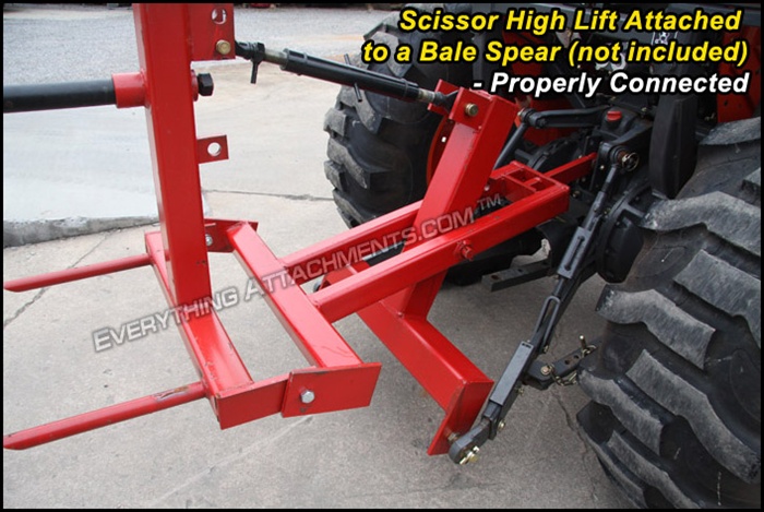

Tractor 3 Point Hitch Scissor High Lift, Hay Lift #3F, uses #3F Bale Spear
The scissor lift will also work with forks or any 3 point attachment. the disadvantage is you lose lift capacity because the load is farther back.

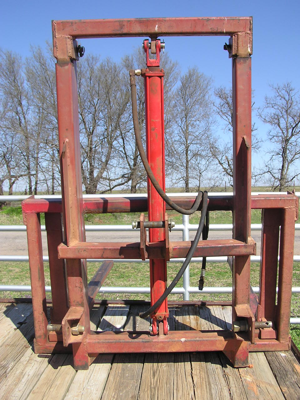

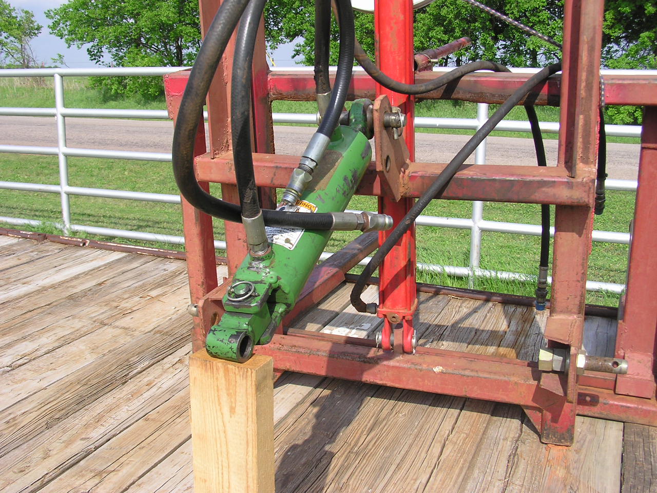

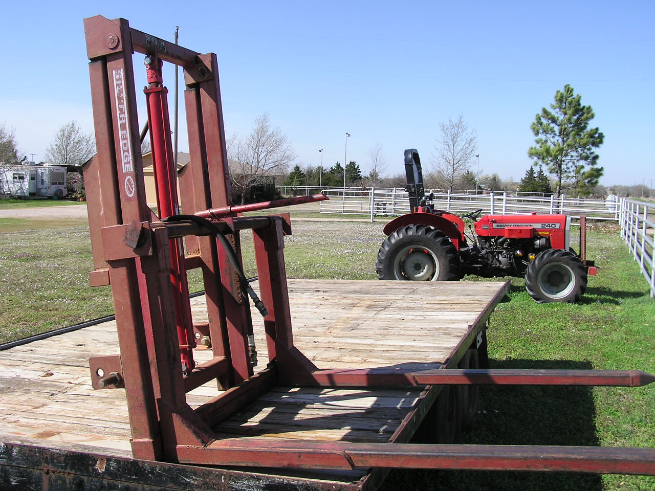

Back in the day when I had a tractor, I considered a high lift adapter for round bales, but I got a 3 point forklift instead.

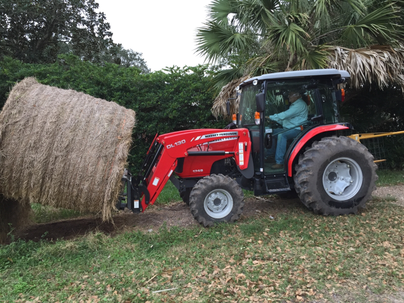

My Dad's compact MF 1749 HST can handle 2 round bales front and rear or just one on the front. He runs water ballast in the big 16.9 R1 rear tires. The only downside is the 9.5 front tires looked really loaded with a big bale in the front and nothing on the 3ph. Didn't cause any problems, but after he noticed it he started putting something heavy like another bale, or his 6' Bush Hog or box blade on the 3ph to balance the load. View attachment 408650
