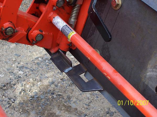

Well I found out why my LA723 Skid steer QA loader won't accept skid steer equipment. I took the bale spear that the wedge pins on my LA723 lacked 1/2" touching the bottom latch plate to my son's Kubota M9540 QA loader. The hay spear fit perfect on his QA loader. His pins are much larger and look to be a little longer but I didn't measure. They seat in the latch plate perfectly.
If you are like me and expect the skid steer eqt. to fit the smaller loaders, you might be suprised. I am going to weld another latch plate to fill the gap. I don't think it is worth the effort to try to get Kubota to admit there is a difference in their loaders. It's probably easier to spend my time welding.

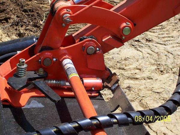

I have had the same issues with my grapple & snow plow with my L-39.
As you noted, I welded a piece of 1/4" angle iron below the pin catch hole, and it works fine. I'll post a couple of photos to give you the idea.

On my LA723 with QA the poorest fit is with the Kubota bucket. The upper hook is welded at the wrong angle so that the adapter does not lay flat against the bucket when I first pick it up. The pins won't enter the slots in that case. I have to lift and curl and bounce it some to get it to lie flat. I will get a sledge hammer and "adjust" it one of these days
My third party equipment fit just fine. I did have to shim the springs with some washers to limit pin travel when locked otherwise they would cam out when back dragging. That took 8 washers and 30 minutes to solve.
