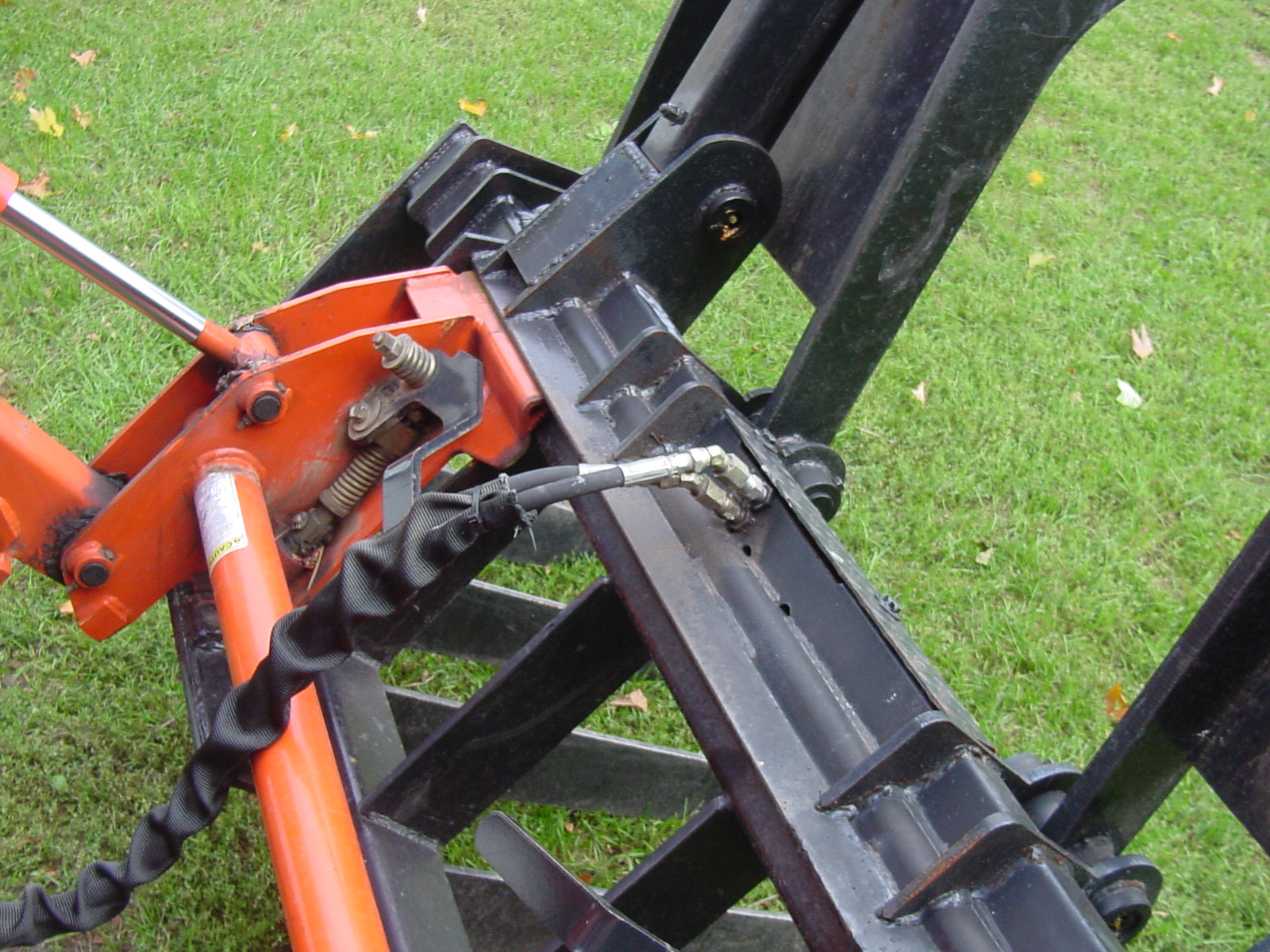

I took my tractor and grapple to a neighbor that has a nice welding shop. After much looking and discussion we welded a piece of 3/8 plate about 1 1/2"
square on the latch plate as Walt's pictures show. This solved the problem. The grapple seems to be solidly attached now. I don't think it could come loose now even with some serious backdragging. If it doesn't rain I will find out tomorrow. I have about 3 acres of white pine sapplings that need attention.

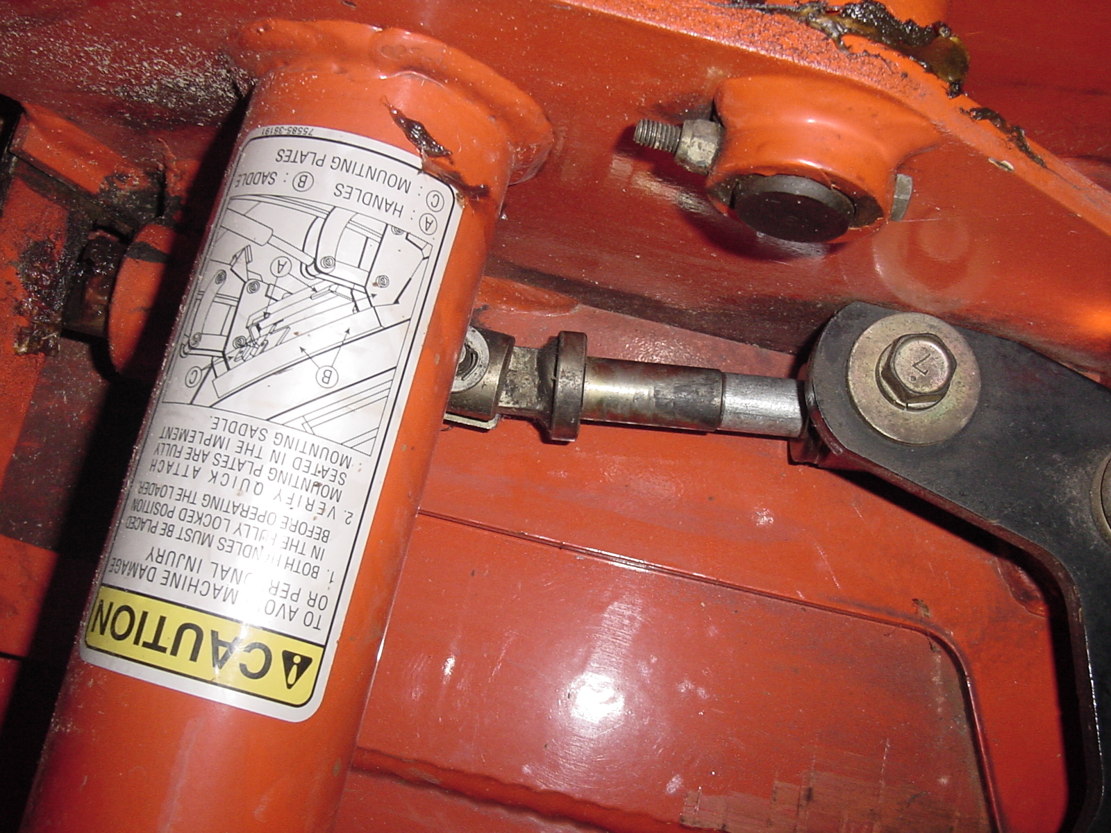

My Kubota L4330 with 853 loader had the same problem when I mounted a Bush Hog rotary mower on the FEL driven by a hydraulic motor coupled to a PTO hydraulic pump. I made the QA brackets, and I did as Walt did and added a 1/2" thick block to the lower plate so that practically the full tapered surface of the pins was against metal. Because the Bush Hog sticks out quite a bit forward of the FEL attachment point, the twisting force on the QA when the front edge of the mower travels over a log or high spot must be substantial. And this force is trying the pull the bottom of the implement bracket away from the bottom of the bracket on the FEL where the pins are located. One or both pins popped out several times.
I think the problem is the roughly 45 degree angle on the pins combined with the grease zerks on the pin bushings. On dry metal a 45 degree angle may be barely sufficient to avoid having the surfaces slide on each other from a squeezing force, but when the surfaces are lubricated the angle should not exceed around 10 degrees (depending on the exact type of metal, lubrication, etc.). Over time oil leaks out of the grease on the pin bushing and creeps down onto the tapered surface of the pin. Thus the tapered surfaces of the pin and the stop blocks on the bracket become lubricated to some extent and the 45 degree angle on the pin far exceeds the 10 degree angle of repose necessary to avoid upward force on the pin when backdragging or otherwise twisting the attachment away from the bottom of the QA. If the upward force is not too great the springs may not compress enough to allow the pins to slip out. But in my case the springs compressed roughly the 1 inch necessary for the pin to slip completely out.

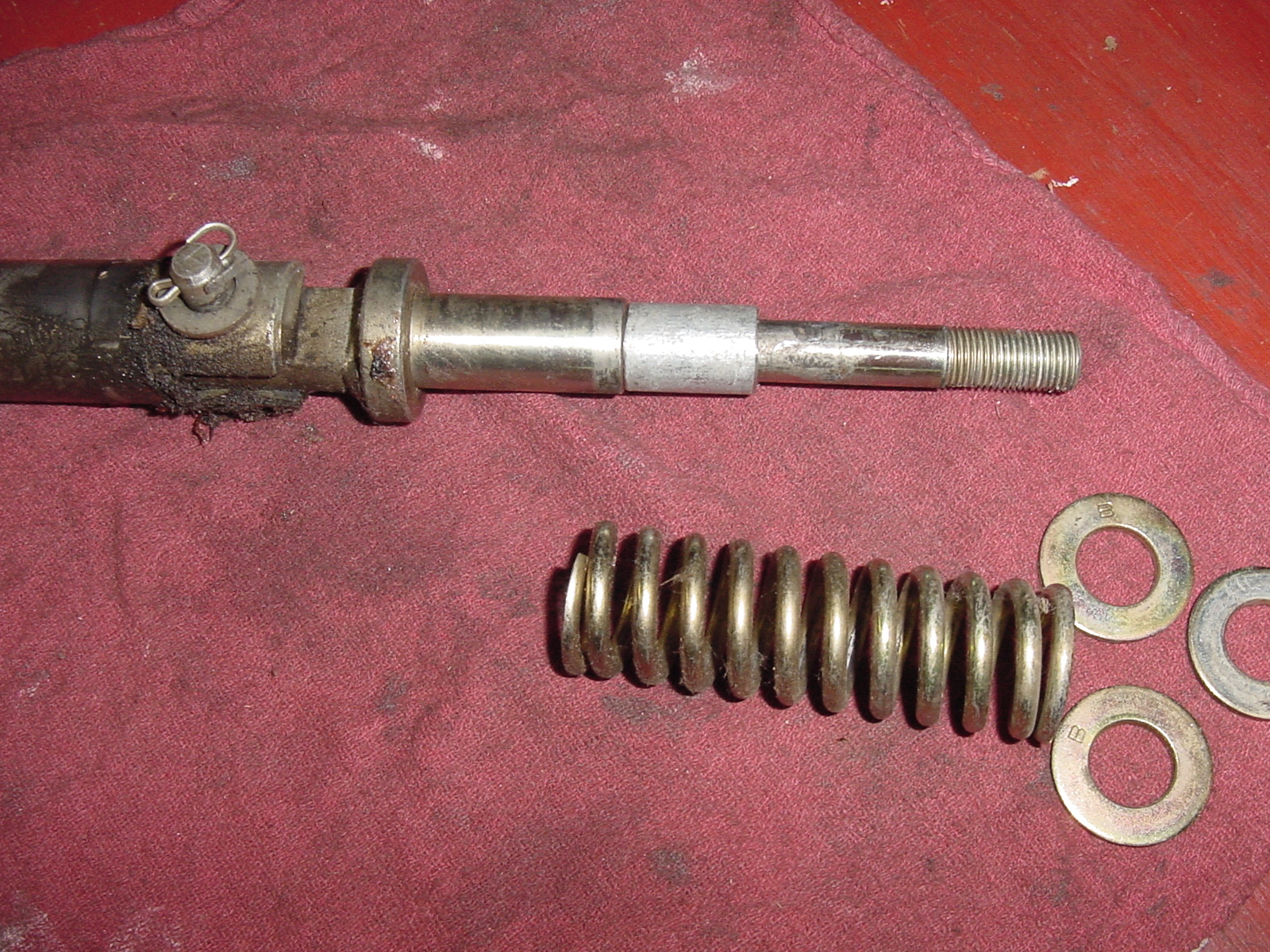

I think I solved the problem by putting 1 1/8" long bushings inside the springs around the central 12mm bolt. These bushings are short enough to allow the locking handle to pass through center when inserting the pin into the implement, but they are long enough to keep the pin from moving up more than about 1/4" when the handles are locked.
The bushings I used were from McMaster Carr, part # 6391K201. They are SAE 841 bronze sleeve bearings for 1/2" shaft diameter, 11/16" OD, 1-1/8" length, and cost $1.59 each. I guessed at the length and OD. I think there is probably room for 3/4" OD for a little more strength and length of 1-1/4", but these work fine so far. If I were doing it over again I would probably use 3/4" OD tube with 1/8" wall thickness for greater strength, but I suspect the bushings will be more than adequate.
The bushings are installed by removing the single 12mm lock nut on the bolt that runs from the pin through the spring and then into the swivel block on the handle. Takes about 5 minutes.

I have a Piranha grapple and stump bucket and have the same gap problem with the quick tach. All my other quick tach items fit fine, that includes New Holland's largest skid steer light material bucket, Kubota heavy duty bucket, bale spear and pallet forks.
I welded a 3/4" shim on the Piranha items and that fixed the problem. I think they build them with loose tolerences, I know they have a great price though!
I also did the spacer inside the pin so it wouldn't slid in a far.

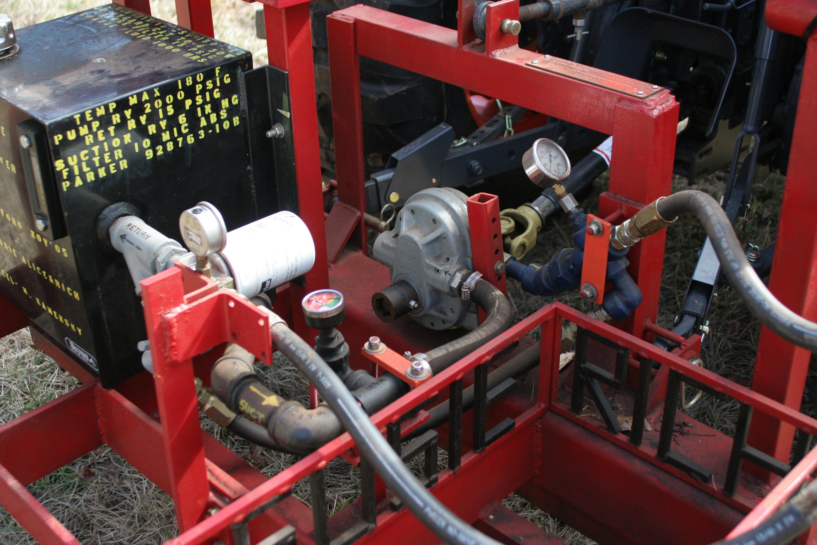

I mounted a Bush Hog 48" squealer on a Kubota B2400 FEL first and then upgraded to a Kubota L4330 when the B2400 proved too small to fully utilize the mower. The hydraulic motor is a Char-Lynn 4.9 cu in/rev that turns about 600 rpm @ 11gpm flow. It connects directly to the input shaft on the Bush Hog gear box with a chain coupling. I built a platform for the motor right in front of the gearbox and used shims under the motor mount feet to line up the motor and gearbox shafts with a dial indicator.
The pump is a Prince 5.7 cu in/rev unit that puts out 11.2 gpm at 540 pto rpm (about 18 hp before losses). I built a three point hitch platform that holds a 15 gallon baffeled reservoir, return line filter, relief valve, and the Prnce pump. I mounted the pump on the tph platform and drive it with a short driveshaft from the pto to make it easier to hook and unhook than if it hung directly on the pto shaft.
The Bush Hog points toward the front (ie, open end in the direction of cut, just like on the tph) and I replaced the single caster tailwheel with two fixed wheels, one on each side at the rear of the mower.

I am over my head on this attachment business. There may be a photo of the pump setup attached. If there is I will try to send some more along. If there is nothing attached, I will have to wait for my daughter who understands how to do it.
