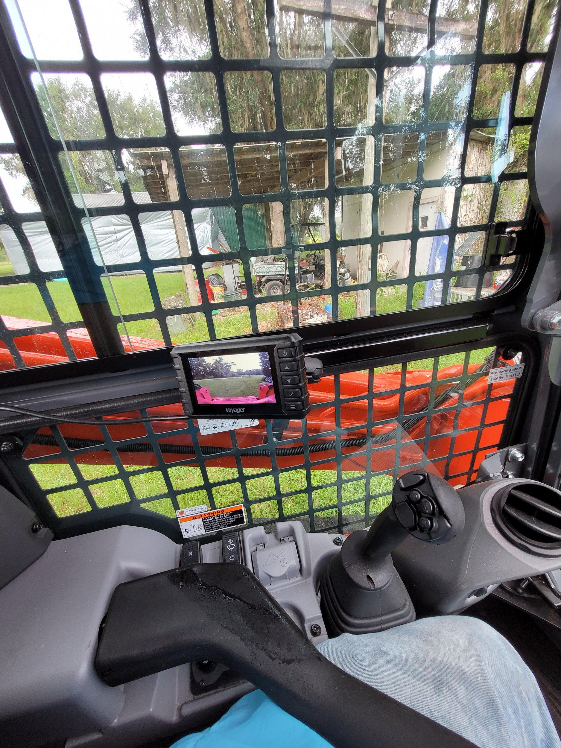

Where do you mount your video display? I have a backup camera that came with a mount that sticks to the window but there is so much shake it won't stay. There is not enough room at the top of the door to mount it and still be able to view the display. My rear problem has been things crushed without leaving a mark in the SVL paint - door to my old work pickup, stuff like that.

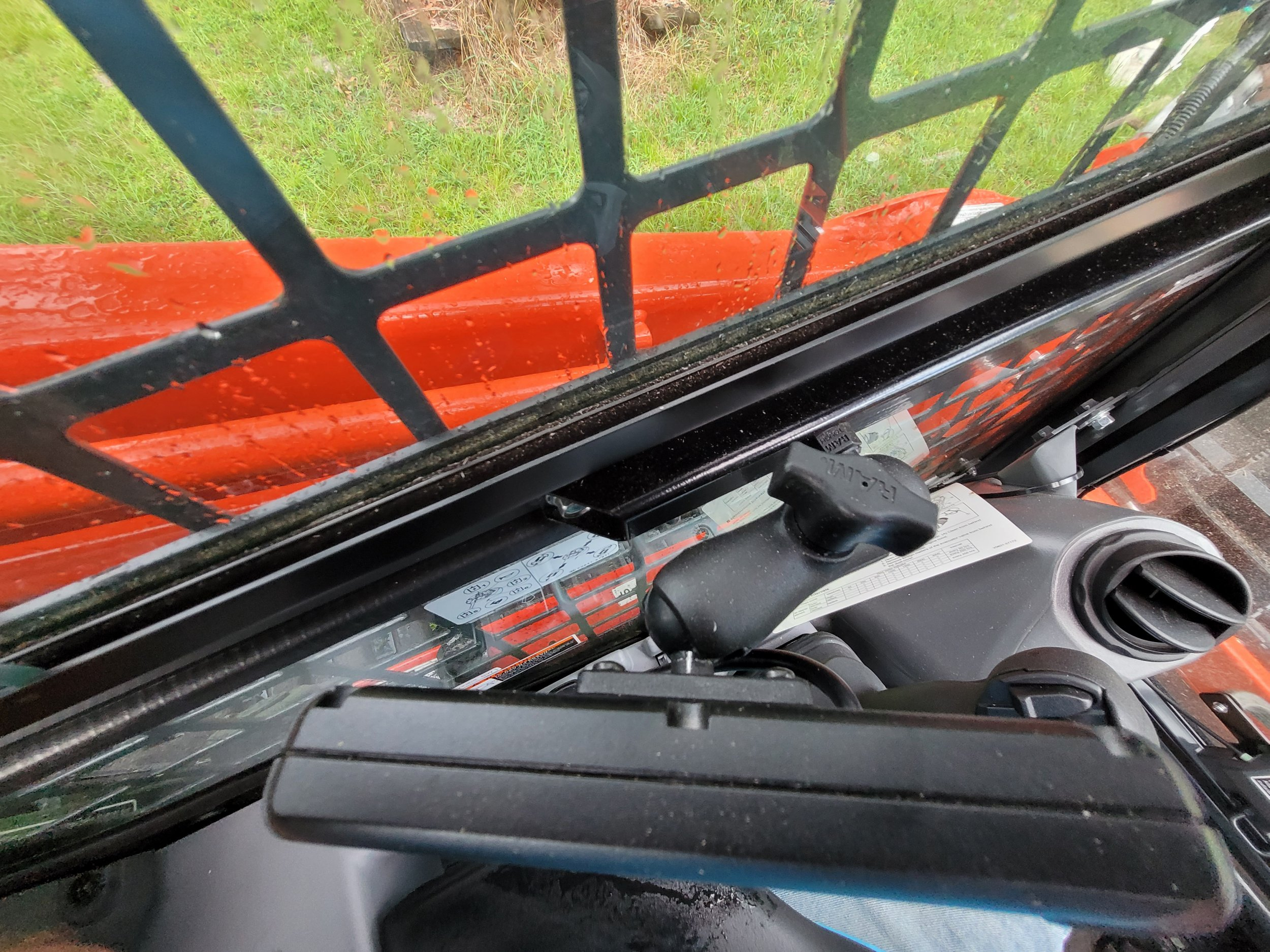

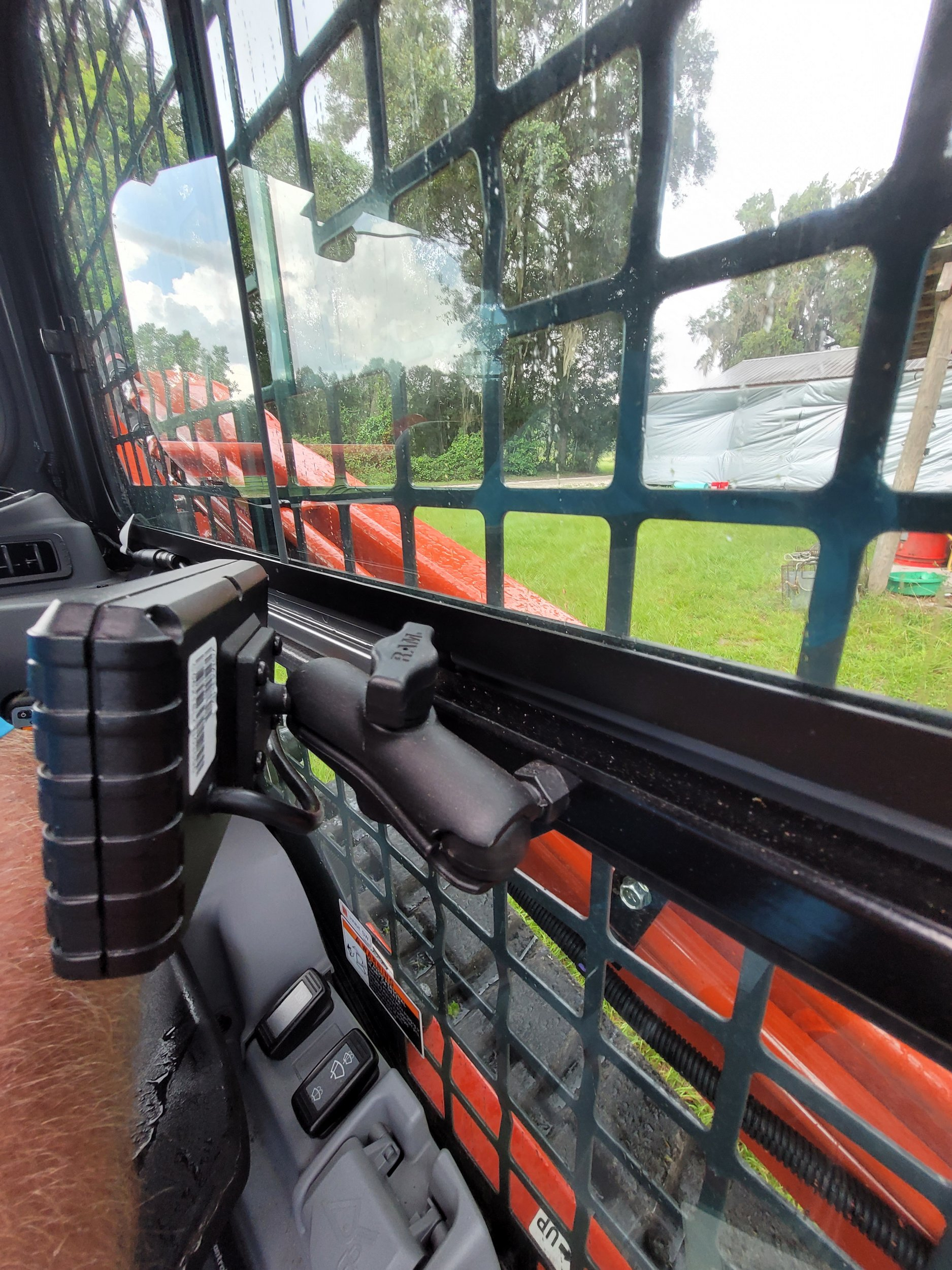

Mine is mounted to the window track on the left side of the operators seat , I will try to take a picture tomorrow.

Mine was dealer installed but it is a RAM mount, I have added some pictures of how and where mine is mounted, maybe these will help or at least a place to start. Charlie.

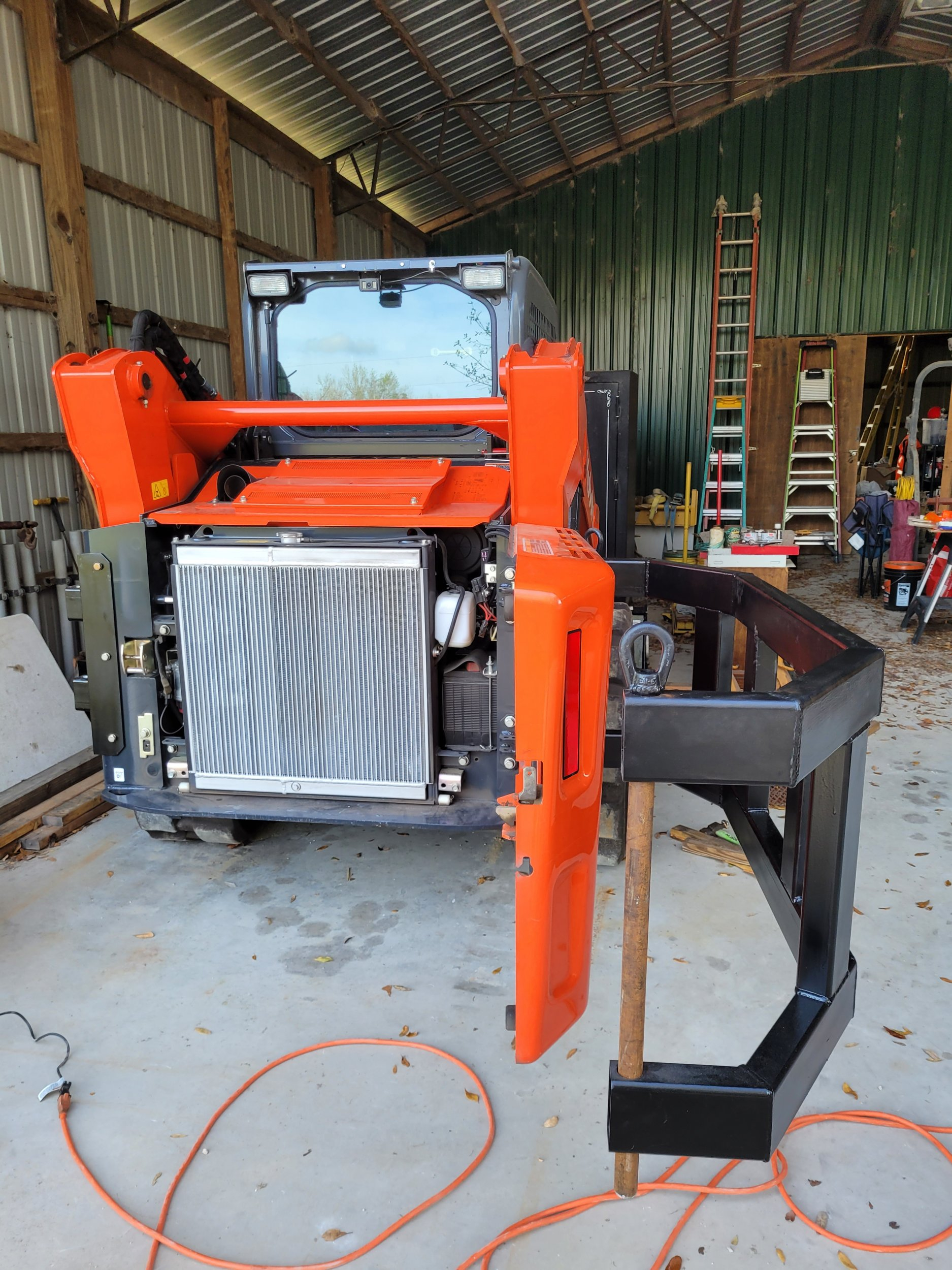

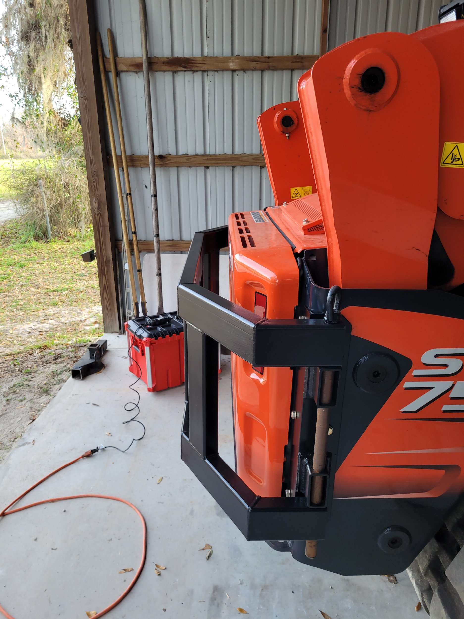

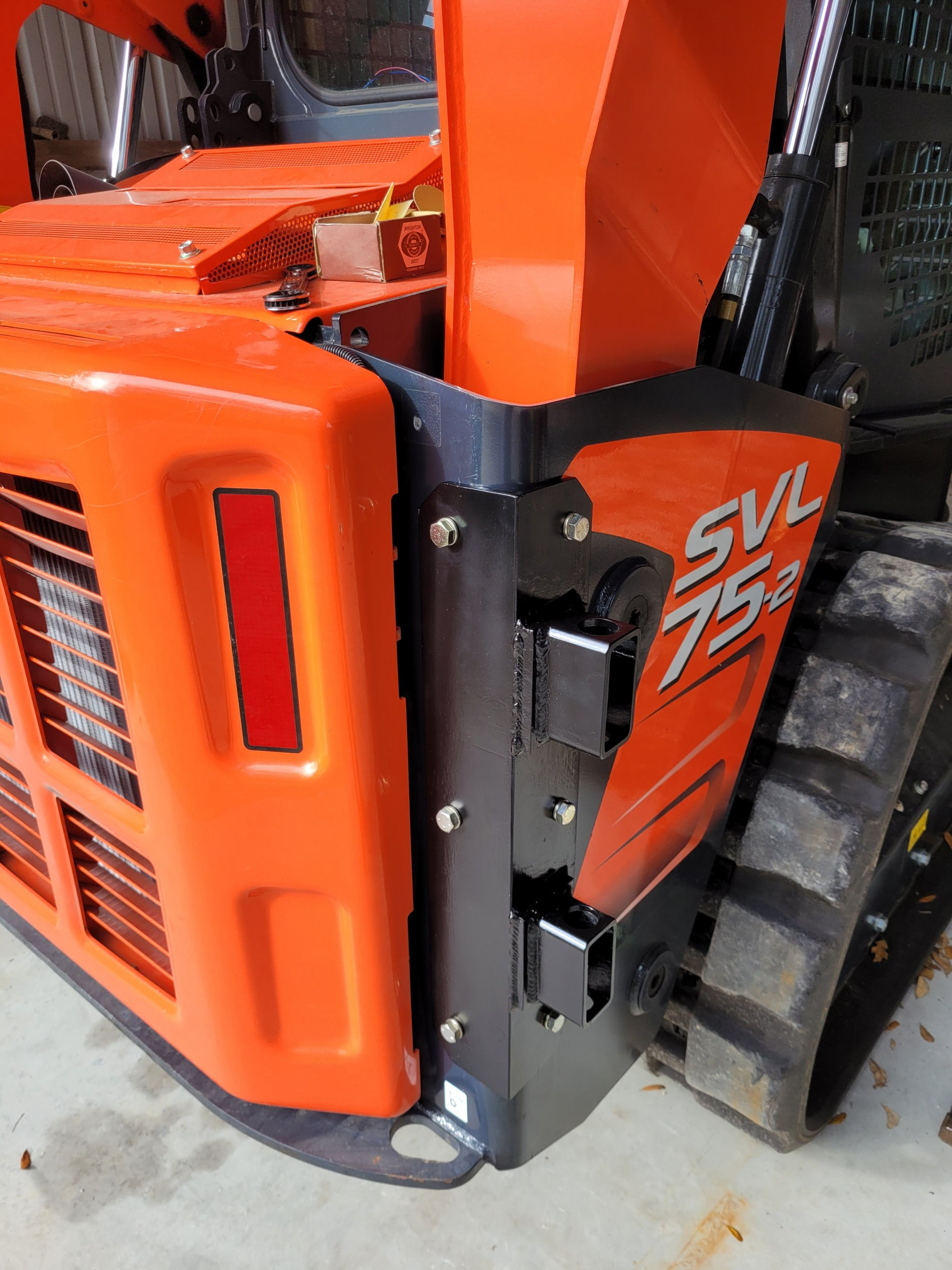

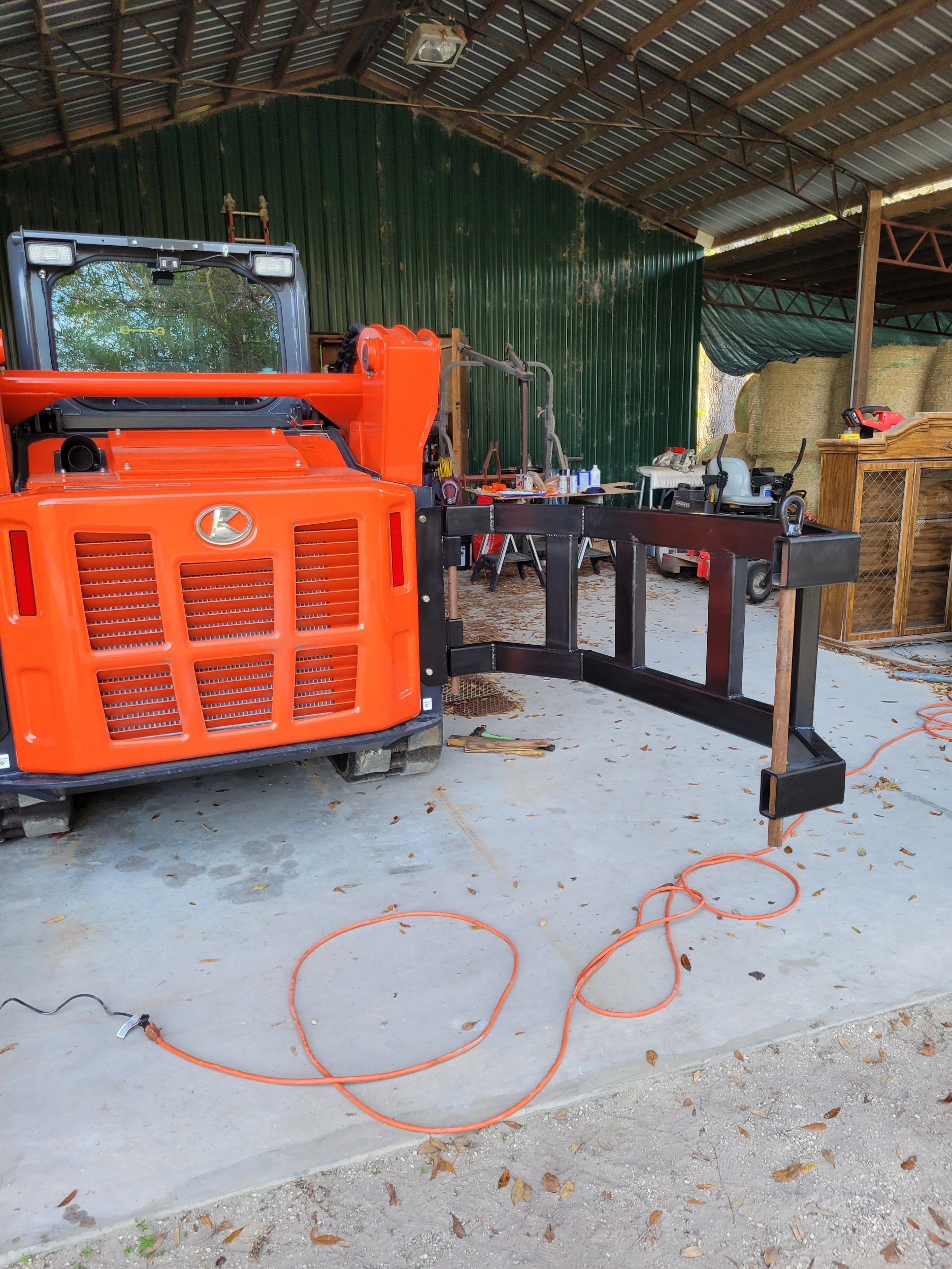

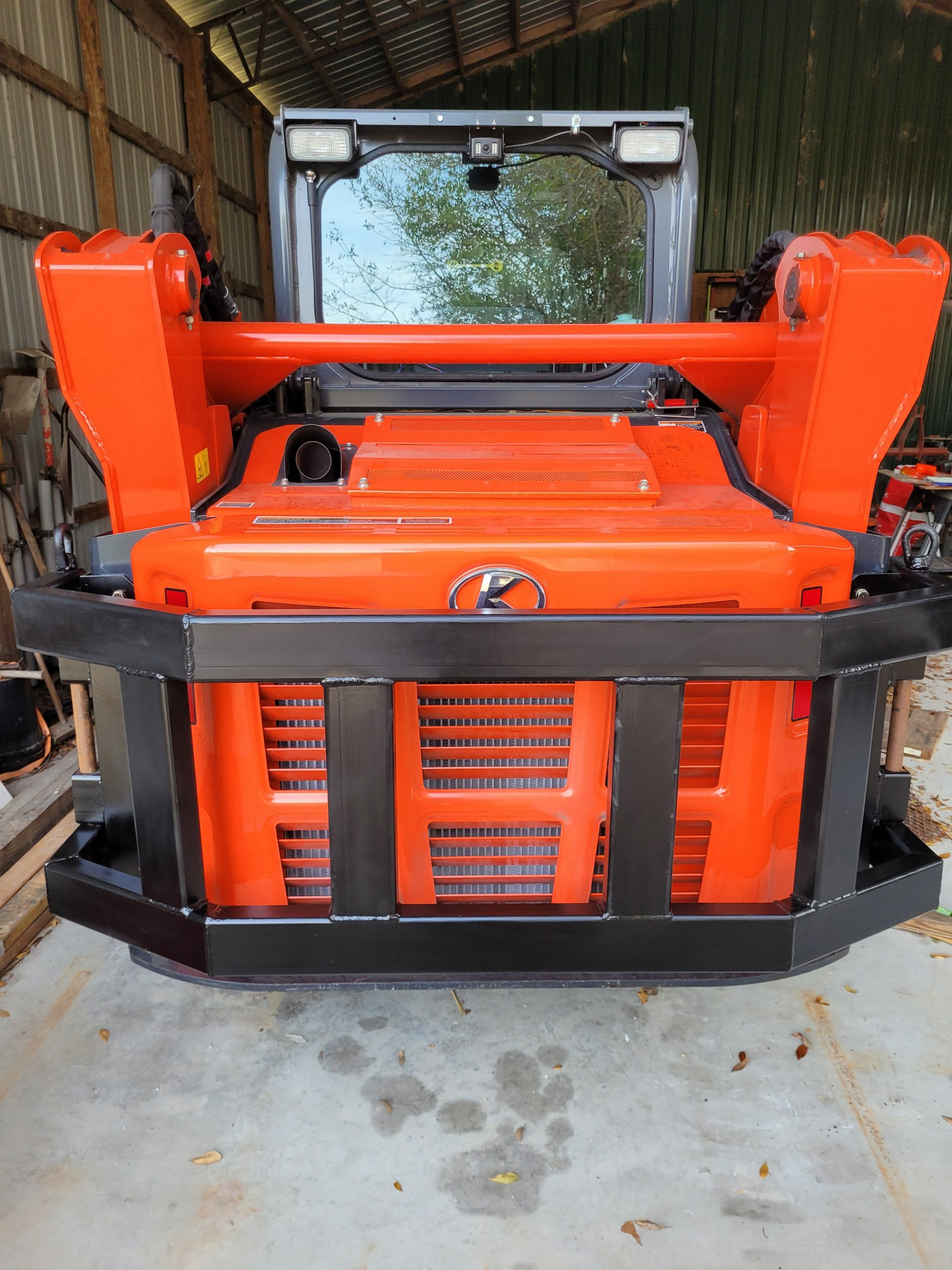

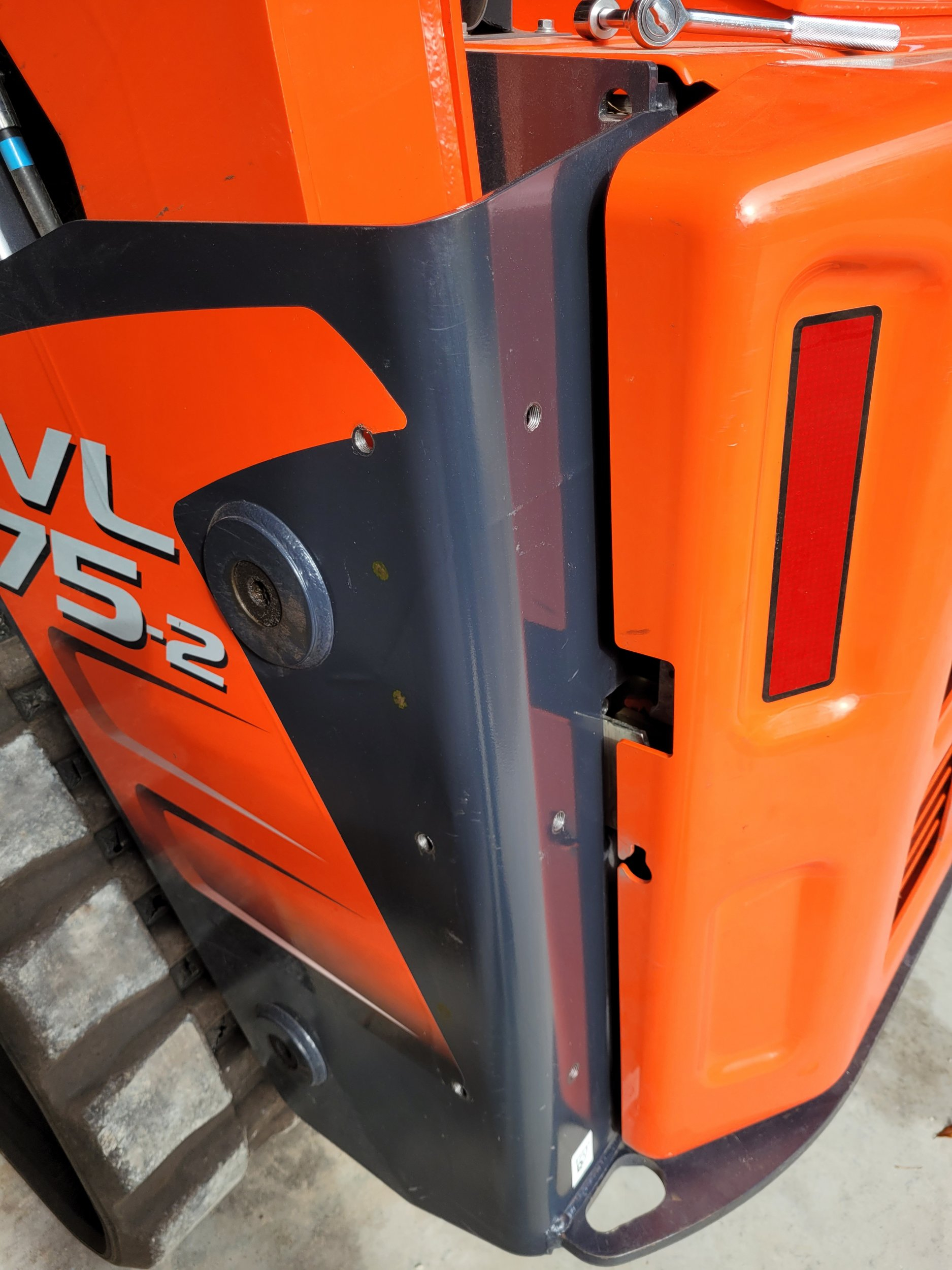

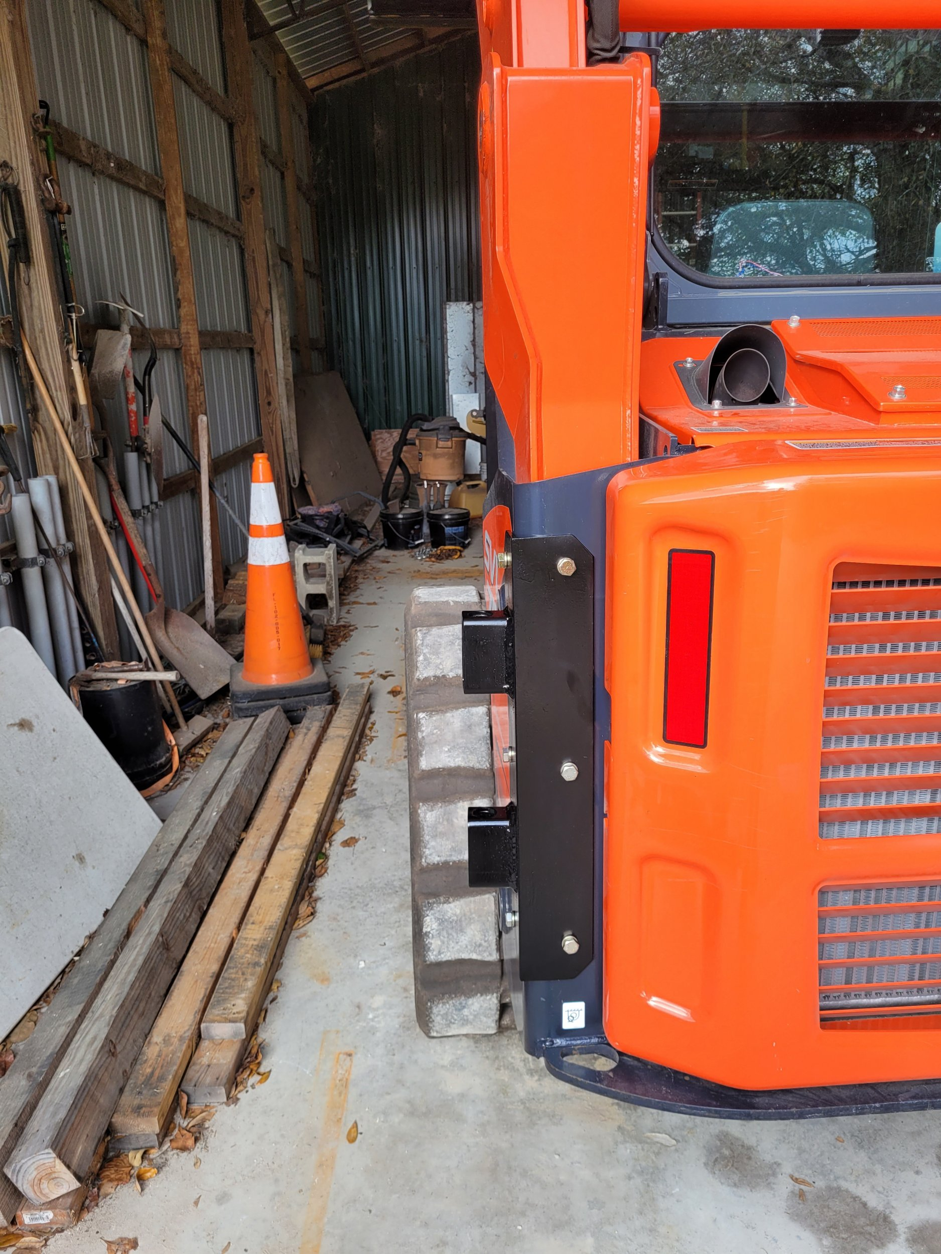

Thought I would update this thread, I finally got back around to working on this project and while I didn't do everything that I wanted I did accomplish my main goal to provide some rear door protection and counter weight for my skid steer, hopefully the photos will show how it is attached to the machine and be a little more clear on what we did, one photo will show where we drilled and tapped the metal on the machine and tapped it with fine threads, also was able to get lock nuts on the top 2 bolts on each side of the machine as well as the bolt being threaded in so it should be strong, I will probably do more later on as I gather some additional material but for now it gives my machine some protection from backing into trees and stumps when I am working in the woods.

Looks GREAT!
   / Kubota skid steer rear bumper/ rear protection #30
Very nice Lineman 👍
That's a beefy sonofa gun!
Those threaded eyes on your pins sure look familiar. 😉
