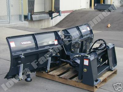

I have an 84" Virnig V plow on my M59. It has cushioning valves with settable psi points to allow release when you strike a hard object. Works great. As noted damage is a strong function of the operator. Blade has a small degree of float from side to side and up and down so that it is not stiff on the arms allowing for ground imperfections. You can still apply down pressure to scrap hard packed snow.
As delivered you can run the blade off the front remote. I replaced the sequencing valve from the factory and have it connected to two of the rear remotes.
No issues. I think the 96" version would also be OK.
