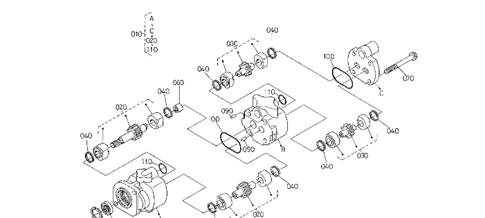

Once in a great while we loose steering. Steering wheel just free wheels & tractor goes on its merry way for 5 seconds or so. Then goes back to normal operation. What could be causing this?

My L4610 did something similar, again only on rare occasions. It would act like the power assist stopped working for a second or two, then recover on its own. The explanation was that there is a single hydraulic pump supplying steering, 3 point lift, FEL and any other hydraulic attachment. Once in a while the demand would peak momentarily and would cause this glitch in the power steering. Yours may or may not be the same thing, although mine never went away for 5 seconds.
* Check that the hydraulic fluid level is not low.
* When were the hydraulic fluid and filters last changed, and what fluid was used? Kubota SUDT2 or equivalent premium grade hydraulic fluid highly recommended; stay away from the discount store generic stuff.
* Do you get any similar hiccups in operating the FEL or the 3 point?
* If the fluid and the other hydraulic circuits are OK, you may be looking at something with the power steering setup itself, either in the steering controller or the steering cylinder.

Grandad4
From viewing L4610 parts catalog it appears L4610 has a 2 stage hyd pump with 2 sets of gears. From viewing hyd line configurations I think 1 part is for steering & other hyd functions but would need access to WSM to know for sure. If only 1 hyd pump operates steering & 3 pt/fel normally hyd system has a priority valve to be sure steering has hyd pressure priority over other hyd functions

Appears to be problem in hand metering unit. My WSM shows the Lxx10 all have 2 section pumps, one for steering, the other for everything else. Requirement is you must not have anything in circuit that can take away from steering. That really pinpoints the HMU unless the problem comes at full lock. In that case there may be a possible cylinder defect that allows oil to flow through.

Check the center seal in the steering cylinder.
Would this mean that our free spinning steering wheel moments should happen only when the front wheels were pointing straight ahead, or maybe at full turn might indicate an end seal?
Don't know if this may be part of same problem, but sometimes, when have extreme load on front end and trying to turn, there is a pop & jerk on the steering wheel, before it proceeds to act normal.
